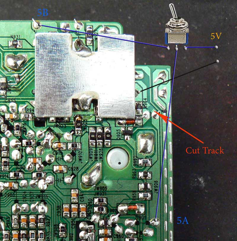

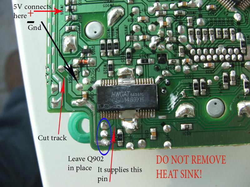

I have chances all the things on the board like the Okapi PDF file and now I will separate the 5 volt power supply from the board and I will feed the Trichord Clock 4 also with a separate power supply, what are the things I need to do now?
I have seen some pictures here on the forum but I can’t find the right pictures anymore.
I found this picture to separate the 5 volt power supply from the board, this is the right one I hope and please let me know that I am right?
Rudy

BMW850 said:I found this picture to separate the 5 volt power supply from the board, this is the right one I hope and please let me know that I am right?
Yes, it looks good. The place to cut is green dot on a track.

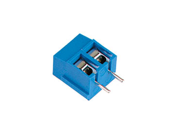

It was a stupid fault from me, I used a print kroonsteen I don’t know the name in English so see the picture.
One pin is connected to the + and the other to the – to the board that is good, bud under need the board I connect the – from the print kroonsteen also to the – that was the problem, no power to the motor
Rudy
