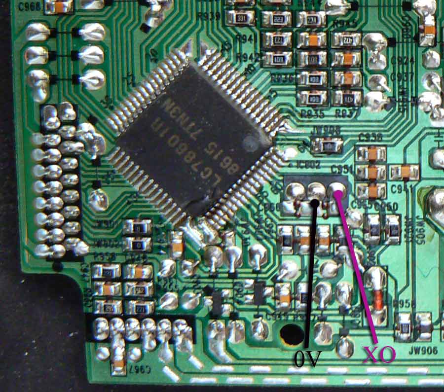

I have only just got around to fitting this clock. Audio1st, it is exactly the same as yours. I have connected it as advised (post 1495 page 60) and it is not reading the TOC and no movement at all from the laser or motor.
From the photo you put on of your clock in situ, it would appear that one of the wires (ground?) is not connected at the terminal block?
There is an OUT and a GRD. I have connected the OUT to the pad you marked XO on your diagram and the GRD to the pad next to it (middle pad of crystal)
Any ideas?
Hi Puffin,
Connect clock "out" to XO. (as you have).. then..
If you use a separate power supply for your clock, then connect clock "Gnd" to the centre pin of crystal location. If your clock shares the same PS as the transport, then you don't need to connect the Gnd clock terminal, (it may cause ground loop problems).
Have you removed the crystal?
Have you reconnected the laser ribbon?
It is a Yes to all your points. I will check the ribbon cable (which is still attached) as I seem to remember I had probs with this before.

Puffin said:It is a Yes to all your points. I will check the ribbon cable (which is still attached) as I seem to remember I had probs with this before.
Still no luck!
Audio1st. I suppose it is possible that the clock board is faulty. Is there any way to measure if the on-board crystal is getting juice and is actually outputting a signal?

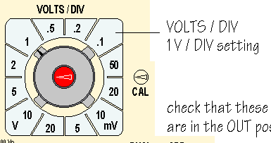

Of course there is.. You will need a SCOPE.. 😀
Kevin. I have one but have never used it!(what a terrible admission!)
The trouble is I don't know where I would connect it or what I would be looking for if I did.
Any pointers for an idiot?
This site might actually help: http://www.doctronics.co.uk/scope.htm - should be enough to give you the basics on how to use your scope, and it is humorous too. 🙂
Also look for various of the old Tektronix training manuals, they explain how to do various measurements with a scope and are often written for the first time user. At one time they had some of them as pdfs on their site as a historical curiosity.
Hopefully your scope came with a manual and may have some tips on usage.
First let us know what kind of scope you have, it needs to be fast enough to see the clock waveform.. A 20MHz scope will be just serviceable for this task, anything slower really isn't going to be fast enough to look at the ~11MHz clock signals.
I am assuming you will have a 10X probe. (1X probes often have too much capacitance and that in conjunction with the scope's input capacitance makes for poor high frequency performance with many DUTs. ) Calibrate it as discussed in the scope manual or training manual.
Obviously the probe ground goes to a board ground (keep the wiring very short as these are high frequencies) the tip will be used to probe any signal you want to look at.
The clock amplitude is typically around 5V at the input to the dsp chip, so look at it there and set the vertical sensitivity to either 5V/Div or 2V/Div, ((with non auto-ranging probe set to 500mV/Div, or 200mV/Div) trigger on "auto" and horizontal time base perhaps 50ns/Div. If your clock is working and your scope is fast enough you should see a nice squarewave.

Kevin. I have a Velleman HPS10 (see link)

Afraid that you may not see much with that.
You will need unit at least 30Mhz and up for measuring in this this digital area.
