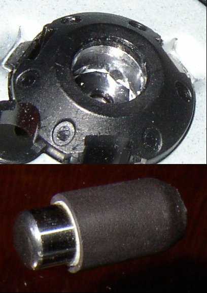

woodturner-fran said:Now thats a nice idea. How did you fix that in there?
Fran
Just insertion, its only scope is let the puck to be centered.
The hole is 6mm diameter.
The pin I used is nominal 6mm, 5.94mm real.
I put just a little piece of alu foil (that used in cooking) inside the hole.

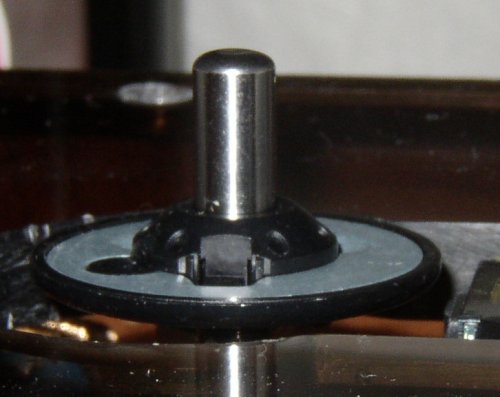

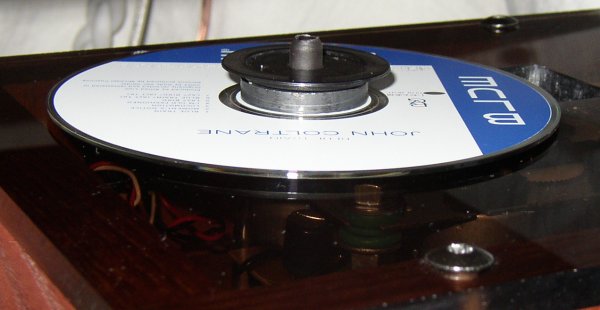

first attempt at a new puck.
This one is from cocbolo, nice dense hardwood. I turned the brass pin from 8mm stock. The bit that goes into the mech is 6.10mm, the rest is a shade under 6mm to allow it to slide into a 6mm hole in the puck. Second pic shows the puck in place. No magnets used here, just friction fit. Runs true and I tried it out on a spare second mechanism just with the motor powered up. No extra vibration as far as I could feel (not very scientific I know).
I was half thinking of making up some kind of jig to allow me to make the puck in place on the spare mechanism. The motor isn't so tough though. Anyway, I hope to get to listen to this later on and see how it sounds.

That looks really neat. But what worries me is the length of the motor spindle
from the bearing to the platform and all that extra mass which can only lead to
vibration and subsequent loss of data extraction.
That took allot of work to make does it sound any better?🙄
