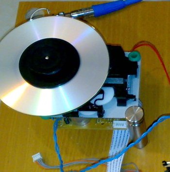

woodturner-fran said:
I wonder if I made a brass spindle like the other one, but this time threaded, and then made a puck that screwed down onto it. The puck could then be made bigger diameter.
Only problem would be tightening or loosening the puck.
Fran
I think the thread is a good idea but increasing the size of the puck..I would say no.
The Delrin puck is a proper size and "in balance" with the frail spindle and tiny platform.
Further is it from the utmost importance that it screws on very light almost all the way down at a whirl of your finger.
I have played hundreds of hours this way and turns out to be very comfortable and failproof..
If you have ebony lying around ....treat yourself..to an ebony puck.
If not and you want to give it a try PM me and I will send a couple of pieces.

Originally posted by audiojoy used my own polystyrene 100pf caps, and yes a big advance.
Can you post a picture? Thanks.
