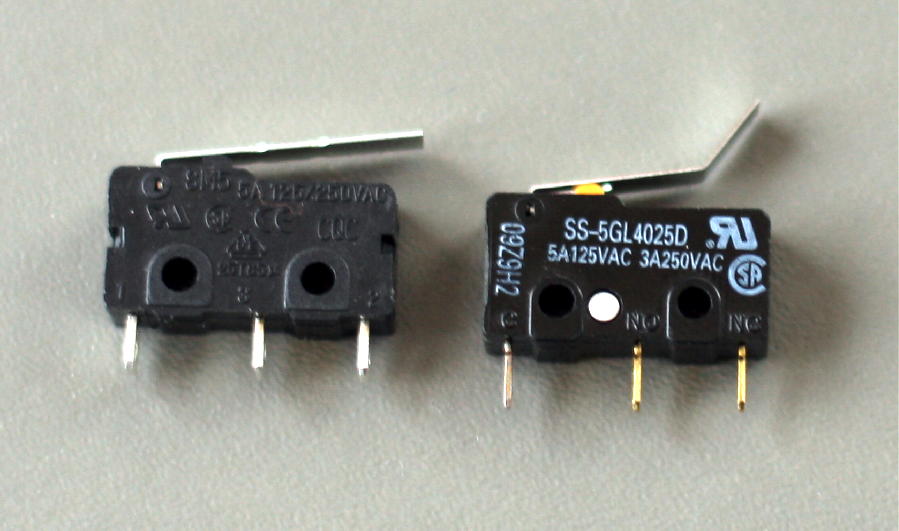

Need ideas how to solve "door" switch!
I am finished with box now. Even went back to original JVC trafo how I could make everything compact in single box, except that "door" switch.
Anybody?
Anybody?
Peter Daniel said:Use any switch that is normally closed. I'm using those:
Thank you Daniel. It is not a question what type of switch then mechanical solution how my wife could change CDs easy
I have plenty options od differents switch types to choose from, just out of ideas how to implement.
From the beginning my idea was to put dark glass on the top as movable cover wich would push that switch. However this is not finished yet cause can't find proper hinges.

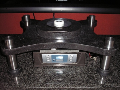

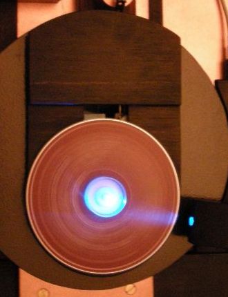

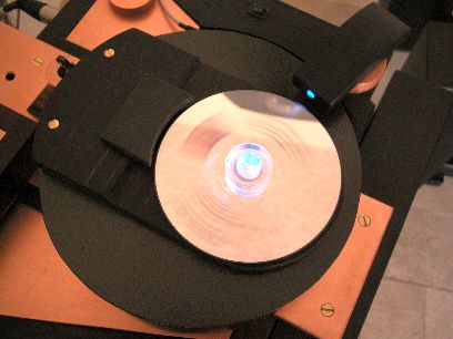

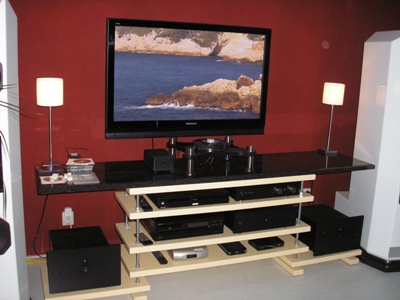

Hallo,
I have chances all the things on the board like the Okapi PDF file and now I will separate the 5 volt power supply from the board and I will feed the Trichord Clock 4 also with a separate power supply, what are the things I need to do now?
I have seen some pictures here on the forum but I can’t find the right pictures anymore.
I will thank Peter Daniel and Okapi for all the good things they have post here on the forum, the sound is great from the Shigaclone I also thanks all the other people for the good thinks they post here.
Here some pictures, it is not finished.
Rudy

1 more picture.
Here you find more pictures: http://www.htforum.nl/yabbse/index.php?topic=76211.1475
Very Very nice integrated...looks one of a kind have fun Rudy...
I certainly have fun with it........although it introduces weakest links in the rest of your components...😀
