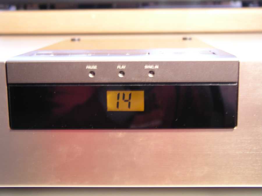

That is indeed very nice Andy! Looks like you have a hole for a second LED. Did you have one in there already and then take it out again for some reason?
Is that an old Marantz front panel?

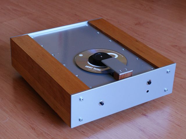

On Friday I received my powder-coated enclosure parts (front, back and top panels) so it is finaly assembled. At the moment only the toslink is active, when the new DAC is finished the BNC will be used.
The left black button is power, the right the TOC reset. The hole is for the IR, still looking for a matching window/eye to cover that hole. The remote is used for control.
The top wooden/metal thingie is to protect the users eyes from the laser. The CD slips easily under the thingie... it looks perhaps more fiddly than it is in practise. But hey... safety first.
Thank you all for the inspiration!!!
Jeroen
Jeroen

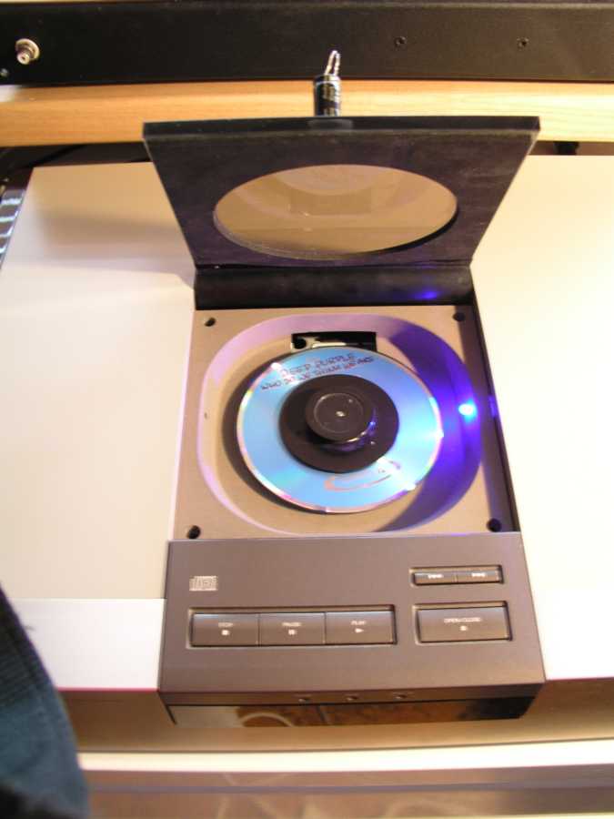

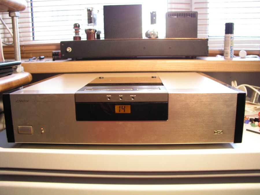

The donor is Victor XL-Z900, which I had to kill after laser died
So things still stay in JVC family 😀
The second whole was originally for CD puck presence sensor.
The cover has a motor, to run it is my last service for Victor 🙁
