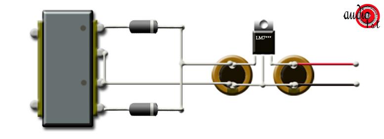

Is there a scematic for a PSU for the shigaclone (trying to use the search function, but it only directs me to complete thread and not the post where it is mentioned?)?
You use a 2x12VAC transformer or a 2x9VAC transformer (rectified to ~12v)?
attached is one of Audio1st's fine schematics which I'm sure he won't mind me posting.
this is the method that most folk have used - using a CT secondary and only 2 diodes.
So far as the transformer secondary is concerned - it's not too important whether you use 0-9 0-9 or 0-12 0-12. Provided you connect it CT and there is enough headroom for the 7808 to work correctly.
I use a 0-7.5 0-7.5 traffo - this gives me 11.3V dc once rectified and smoothed at the input of the 7808 - enough for the regulator to reliably generate 8v. I personally wouldn't go below that.
The higher the input voltage to the regulator the hotter it's going to get - mine just about gets warm.

herewegoagain said:I use a 0-7.5 0-7.5 traffo - this gives me 11.3V dc once rectified and smoothed at the input of the 7808 - enough for the regulator to reliably generate 8v. I personally wouldn't go below that.
Rule of thumb with 78xx/79xx voltage regulators:
Vin-Vout = 3V min. to get good regulation. More will not necessarily lead to better regulation but it will lead to more heat.
herewegoagain said:attached is one of Audio1st's fine schematics which I'm sure he won't mind me posting.
Thank you 🙂
Not sure about abbreviations, what does CT mean?
So I can use a 80VA 0-12 0-12 VAC trafo without problems using your attached schematic?
Kind regards
yep you can use that - to use that schematic you must connect it as a CT (centre tapped) transformer - ie. the middle 2 tappings connected together to make the centre tapping.

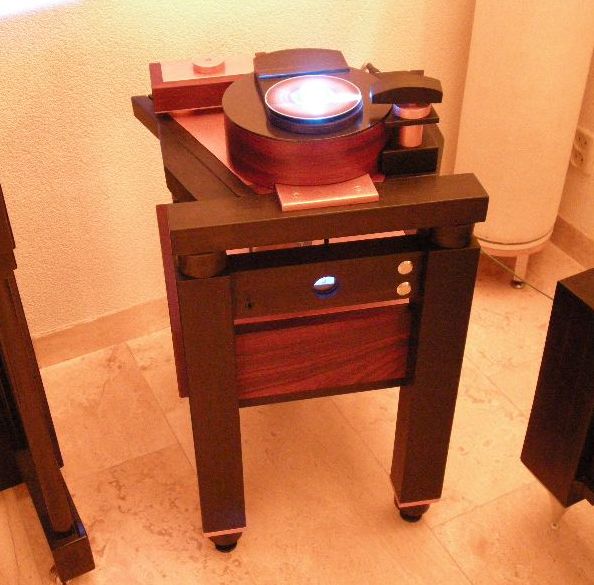

Erik: if you are still reading this thread (!)😀
Can you tell us what weight you have on your laser sled (hanging from the crane)?
I have about 5g there now and I can't hear any difference
Fran
Fran
About 1 gram...🙂
A good try out is attaching say 10 grams and listen...while somebody lifts the weight....you immediately should notice the difference ...pay extra attention to the lower registers...succes!!
i must say Erik - CONGRATULATIONS....!!!!
big project finished for you...

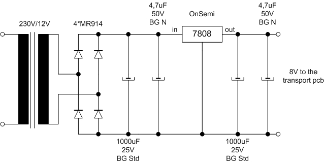

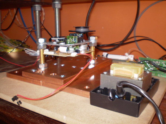

i have made another power supply....
it is using a transformer that has 12V at the output, diode gretz using 4 diodes MR914, one Black Gate standard 1000uF/25V in parallel with 4.7uF/50V Black Gate N series, than 7808 regulator from OnSemi, another 1000uF/25V standard BG and another one in it's parallel that is 4.7uF/50V N series....

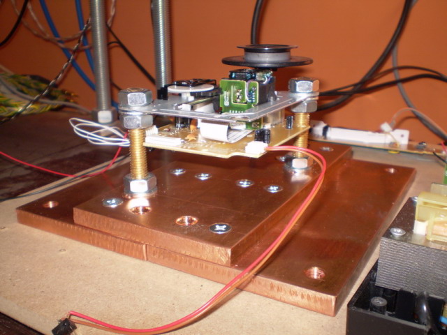

also - another mod is putting the transport on the copper plates - that are 10mm thick....
well - i am still using analogue output since i do not have a dac right now - but i am not that happy with the result - it seems to me that the original psu and the transport on 10mm mdf were sounding better... crazy - right?!
i am waitin for Black Gates to burn in and i am open for suggestions if somebody might have one... but right now i am not that happy with the sound - my BG's are arround 50 hours burned in....
i am still strugling with mine...
it seems that hte transport is working better when i put it together with the copper onto the foam material that is being used in bathrooms to walk on....
but also the power supply seems not to be that good... oh man ... i am not sure.... those BG's are not fully burned in...
