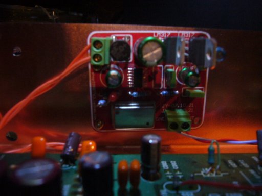

annoying problem
After i did install the ebay clock i did notice interference on my LCD TV screen i can see lines across my screen , i did trye to shield the CLK cable but that dident help mutch..
If i disconnect the clock my screen is ok again ..I dont have any ideas how to fix this..
Re: annoying problem
If You investigate the 317 regs you will find they are the wrong way round. Eg the silk screen on the clock pcb is wrong
valo said:After i did install the ebay clock i did notice interference on my LCD TV screen i can see lines across my screen , i did trye to shield the CLK cable but that dident help mutch..
LM317 pinout
1 Adjust
2 Out
3 In
I think there are alot of these clocks out there where the regs are the wrong way round.
1 Adjust
2 Out
3 In
Thanks hotiron, your totaly rigth, the silkscreen is wrong , and now i got verry unsure about the the crystal too , i have an feeling my crystal is wrong too
Did fix my clock now, guess i gota be more carefull whit ebay kits, but anyway i still have interferencens on my TV , onely differens no is that the stripes did turn the other way

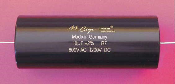

My postings will take some time now since the overhauling is started...
Besides that we need time to do it step by step with timely concentrated listening in between, I also give it the last significant "extra" bit of going extreem, since I do not like to tweak my components afterwards...
So loads of orders are placed again.......N Caps, Duelund wiring, Gold wiring and Mundorf Spreme silver gold cap 0.01 UF on the so called ERO spot.
I am in the fortunate position of having two identical modded boards in order to compare a new single tweak...like eg Mundorf versus Wondercap etc etc...
Because I am listening..listening...listening...bare with me... this step by step process will take time but I promise to keep you informed..and in the end I will try to post high def pics...🙂
