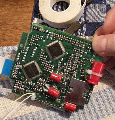

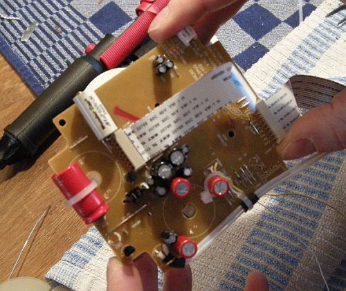

A big warning here is the -31 manual with electrical layouts…those are NOT CORRECT…
It is perfectly okay if you want to follow Okapi PDF but if you want to go further you need to study the print in real life.
Anyway here are the 2 pics of the top and bottom of the final print…ready for assembling in the PiTbull.
An experienced eye can spot the use of super E-caps…some hate them (some prefer the single N black gate above a non polarized pair).
We decided to use them in this configuration because we think it can be beneficial (interested guys can google there are a lot user-explanations.…)

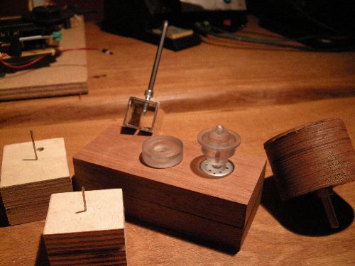

For those who lost faith in all the platforms and pucks I again ordered a platform and puck this time from :
http://www.quartel.nl/webshop/contact.php?PHPSESSID=3897cbddb9f09ff23442571adf4236c6
Not cheap but really 100 procent NO DEVIATION somewhere around 150 dollars...platform and puck....
I did so since I slightly damaged the spindle while modifying for the 100th time...so I have to take it apart anyway
I now have the luxery to choose (by sheer looks) and I can have a 100 procent platform/ puck as spare at the same time....(out of loads of bought puck/platforms !!!)
I also made better tools (used a tip from Peter) for mounting removing and adjusting platforms VERY IMPORTANT ''cause touching the spindle with your fingers is an equivalent of buying a new boombox for its motor...😀
You see a wooden 2 layer block with in the first layer a motor mounting (the hole is the same size in order to let the motor sit exactly straight up)...the 2nd layer has 2 tiny holes for the motorleads...so the pressure is only on the spindle center underneath the motorcasing .....after that I can press with a drill chuck (lefthandside) the platform home.
Inside that round piece of wood is a hole matching the platform..
Removing or adjusting I do in 2 stages ...the birch blocks have a 1.8 mm drill bit short and long...to fit inside the platform hole on top of the spindle...I then press...first with the short one and later with the long one (to avoid breaking the thin drill bit) in order to remove or adjust height.

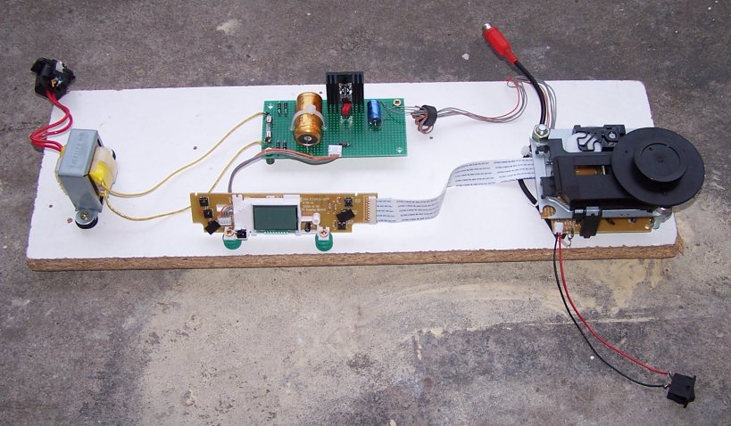

Hi did some work on lector look player today installed a ebay clock not sure what it did to the sound, but i like it 🙂 and i did re do copper my frame and damn its heavy about 6 kg
its still a lot of work left to get that lector look taht i want .. here is some pics
