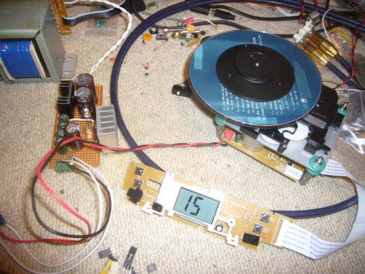

Maybe move away the transformer a bit.
If I should stumble across on of those boomboxes, I would give it a try.
But when I see that flimsy mechanism, mounted on massive copper / wood / acrylic / what else ? bases, I hardly believe that makes any sense.
The motor and the spindle are a horror of their own.

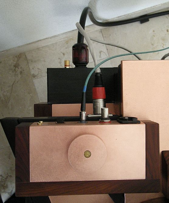

thnx Bernhard 🙂 - no offense - but i like to hear a comment from the guys that have tried it ... you did not try that transport and simply could not comment my problem.... sorry....
i know it is looking crazy and i know it is very fragile - but it si working very very nice.... better than my dvd with dac combo.... and i am no begginer....
so, from my point of view it is a device that has a big potential - but you could allready read that from the previous pages of this thread....
p.s. transformer is not near the transport - it is arround 50cm from the transport - only on this picstures you ca see it close to the mechanism.....
now, does anybody that actually made the transport have any comment on my problem/ doubts etc......
should i move back to the real wood and leave the copper out... does anyone have any experince with this behaviour....
should i go to the better psu... ...
i am confused because i kow Peter is usingthat psu and also copper plate (not exactly like i am using) and i know he is not a begginer to... people also made a lot of positive comments... so i am confused... is my hearing wrong or is it the Black Gate not fully burned in problem.....????

First I think it has to be determined if you are listening/judging the transport or a total cdplayer (you use a dac)...
You can ONLY modify the transport if you know what your old transport sounded like in your set-up or if you make a decision that your dac in your system is a bit referential or a component that will stay unmodified in your system... only then you have a structured path to follow so you can tune the new component (transport) to your liking........STEP BY STEP....give it more time....!!
Use your own ears... advice is hardly to be given since everybody's set-up is different ..let alone their taste (and priorities)...
If you want to know my personal opinion I would say that a mix of copper and wood...tunes the transport to my liking...and is furthermore beneficial for adressing technical solutions ...
One of my recent listening experiences is that the encasing establishes a much higher resolution...

I have two different power supplies on the same board I can switch between the two when listening. The crystal came from a Marantz player. All the mods were carried out without removing the PCB from the mech. Digital out is also switched so I can switch between DACs.
sparkle said:it seems that hte transport is working better when i put it together with the copper onto the foam material that is being used in bathrooms to walk on....
but also the power supply seems not to be that good... oh man ... i am not sure.... those BG's are not fully burned in...

That's why many of us have coupled the mechanism so stiffly to a big hunk of metal. I used machined standoffs of over 1.5cm in diameter with 10-32 screws and heavy washers (sorry do not know metric equivalent) to mount the mechanism at 2 diagonal points only. I have over 6Kg in mine overall and I could really hear the difference securely mounting the mechanism to a heavy aluminum plate which was in turn mass loaded with about another 3.5Kg of bronze. I have not used any elastomeric or other isolation between the mechanism and the plate.
Your basic set up looks pretty good, I would just add a whole lot more mass under the copper, but well coupled to it.
Note that it seemed to take forever for my BG caps to break in, but when they finally did it was a pretty obvious improvement. My mech is the same, but the boards are slightly different as I used an RC-EZ32 instead of the '31. I removed the ceramic caps across the BG on the board, used Peter's recommended xtal, (did not find the stock resonator the least bit compelling after the swap and a reswap to double check) and paid a lot of attention to the spdif output impedance and level. I used 392 and about 89 ohms to make the 75 ohm spdif output pad, but 300//100 should work pretty well as well. I used all 75 ohm hardware including the bnc connectors themselves and I could hear a difference I thought.
Finally a larger power transformer (50VA) did make a very subtle difference.
You would be surprised at the sort of things that make a difference. I recommend going back to the very early part of the thread as there is a great deal of information about getting it to work right, and Peter spent a long time figuring out how to get the best out of this hardware, follow his advice closely and it would be hard to get a bad result.

Erik - thanks for the reply.... right now i am listening to the analogue output of the transport.... simply because i have sold out my dac... so until i make a new one i am stuck to the analogue out... BUT! what my problem seems to be is a new psu and also a copper under the mechanism.... i moded those two together and moved form the regular psu from the boombox to the Peter suggestion (or what i could make out of it to be exact - could not find the exact diodes so i put there MR914 ... also some values and types of the BG's are not correct - as i said i made the best of it .... )... right now it seems to me that the sound is not that relaxed and not that good "flowing" like it was when the transport was using stock psu and was mounted on 10mm mdf board....
so i asked did anyone had similar problem - and right now i am considering to try to mount the mechanism first on the massive chunk of real wood and under it to put some copper i made to make it even more heavy... this is in consideration...
although the situation seems to be improving while the BG's are burning in - maybe i am trying to turned down the fire that really only exists in my head..... will really have to wait for the BG's to fully burn in - right now the are on 75 hours or so.....

my "hunk of metal" is entirely made out of copper with bronze "legs" to support the mechanism - two of them diagonally placed - i have read Peter's files for converting the transport..... but - it is hard to be exactly like Peter's since i can't use that same materials he had and keep the costs low and also i do not have the machinery he has and to keep the costs low is also m priority so i guess that like everybody, i will have to have my own way how to do it having those things in the back of my mind - like Erik said - only I can modify the transport - and that is o.k. - i will only add that also only i have to modify it and try to make the best out of what i have and can find for low or no price ;D
right now i am experimenting to find what suits the best for me - wood, cooper - copper, wood... bronze etc... ... and also searching for experiences to narrow the search if possible.....
