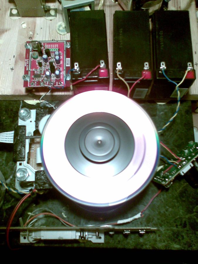

DaveM said:Any impressions on how the battery supply sounds in comparison to Peter's suggested supply?
yes - that information would be very nice to know...!!!
some battery and regulator after the battery.... 😀
Well, I’d describe the new sound as natural and “musical”/”voiced”, perhaps the best from my clone in these aspects, which are most important for me. Now when listening I do not think about bass, midds, highs, other things, there is no reason for that. As usually the best impression of naturalness can be heard on classical chamber music.
You can easily do similar exercise by supplying of LC/LA at PCB with 5V reg and small 9V battery (will be enough for a few hours of playing), by leaving the motors on 8V PSU. Just try, this costs nothing.

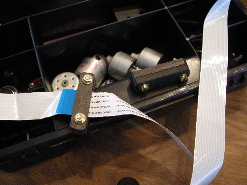

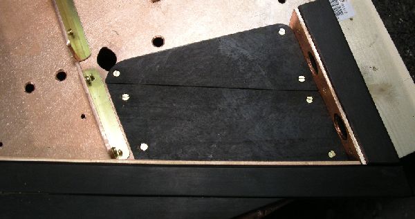

Yesterday I made a proper ribbon out of 3 ribbons in order to get a decent length with 1 mm pitch and 18 pins...(very difficult to order)....say 30 cm ++
Maybe a bit over the top clamping it with ebony but it works like a charm...you have to use 3 ribbons in order not to get inverted...
Thanks for the compliments...the final stage is there and I will try to post a foto sequence of the last steps...building it in the PiTbull
I still have to do preparations to stay ahead of the electronics...this is quite a logistic challenge...
