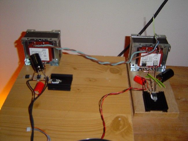

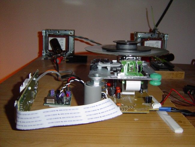

Have stripped unit down and using original transformer etc.
I listen as a original only with dig out and no resistors

thermos said:After no luck trying to find a RC-EZ31 or 51 in Australia,
I thought I would try and buy a Sanyo MCD-ZX530F.
It is quite a simple unit and made sure it didnt support MP3s.
On opening it up it has the same CD-06 (K17T40/41) Board with
DOUT etc.
Although, it does not have a LC78601R but rather a LC78602R.
Is this OK? Any advice would be appreciated.
The other chip is a LA9242.
The other disadvantage is the controls panel is different with no remote control.
I hope it is still OK, as I bought a second one as a spare!
I suspect this is going to work just fine, mine is based on the RC-EZ32 which uses chips (LC78629E/LA9241) based on the same core dsp and asp and is actually somewhat more similar in terms of features and chips to the original Shigaraki than the '31 clones. Works extremely well incidentally..
Another unit that should work would be the Sanyo MCD-XZ600F which has more in common with the RC-EZ32 based version I built. (Outboard micro-controller.)

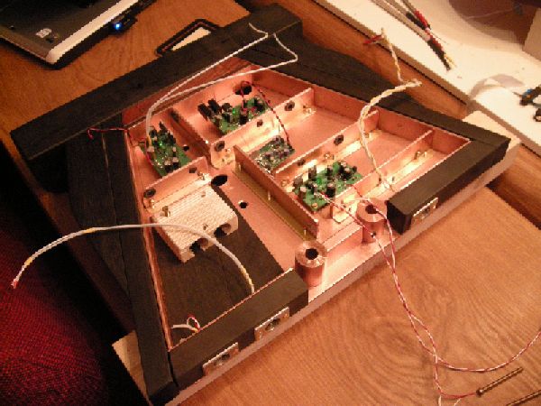

Today I received confirmation that the '51 will be shipped to me soon. My version of the 'clone will be a bit more simple... I'm thinking to go in the direction Peter went with his second 'clone: some careful tweaks here and there. I can always take things further later, if I wish to do so.

jitter said:Erik, let's just say that my jaw kept dropping further and further while I was going through the thread. Goed werk. I wouldn't be surprised if your PiTbull sounds better than the Shigaraki (BTW, are you planning a comparison?).
