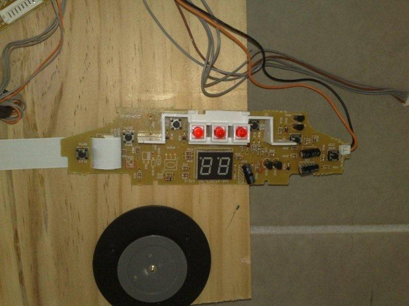

Interesting find! I just looked at okapi's pdf (which was posted at the beginning of this thread) on the various mods, seeing the picture on page 2, I noticed the '31 has the LA9242.
I also just put the datasheets of the LC78601 next to the LC78602.
They seem to be nearly identical. I would not be surprised if the last digit in the type number is just a revision number.
I will be looking further into the datasheet and report the differences I come across soon.
I'd say this Sanyo boom box's internals would be worth using, if you're willing to do without the remote control.
See on your display PCB theres a space for a component just to the left of the numeric display - oval inside a rectangle with 3 legs? That looks awful like where the remote sensor would go. I wonder if you put one in would it work?
Maybe have a look and see if other parts around there are populated?

Just had a better look at the datasheets, it seems that only major difference is in the way the keyboard and display are hooked up to the IC. Judging by the text on the datasheet near the display, the '1 seems to designed for an LCD, the '2 for a LED-display.
Description in the datasheet:
LC78601: Key matrix circuit with 4 inputs and 2 outputs for an
8-key matrix
LC78602: Key matrix circuit with 1 input and 8 outputs for an
8-key matrix
So, it's not a revision number, like I stated in my previous post.
But I'm pretty sure that the signal processing parts of the ICs are identical.
Come to think of it, IIRC, I saw at least one 'clone with a LED-display, so maybe this is old news...
Edit: and here it is...
Edit 2: and another one...

woodturner-fran said:See on your display PCB theres a space for a component just to the left of the numeric display - oval inside a rectangle with 3 legs? That looks awful like where the remote sensor would go. I wonder if you put one in would it work?
Fran
Yes, there is an oval inside a rectangle missing labelled RFM701, the other components missing are C704,C705 and R706.
The board is labelled 248-X53003-100. A google search revealed nothing.
I just looked at the schematics in the service manual of the RC-EZ31. It looks like it's a very simple circuit.
In that schematic, the IR-receiver is designated REM701. One pin of the reciever goes straight to the DSP (LC78601). The middle pin is connected to GND. The other pin is connected to +5V through a 1k5 resistor (R702 in this case).
(1k5 = black-green-red)
Chances are you can get the remote to function without too much trouble. If the ribbon cable between the display-/keyboard and the CD-board is the same as in the '31 (18 pins, fully connected) it might be nothing more than installing a suitable IR-receiver and the 1k5 resistor (and of course finding a remote control unit compatible with the boombox).
Edit: I deleted "left" and "right" in naming the pins, looking at the pictures, I'm not sure I'm interpreting the drawings (layout of the pcbs and schematic) correctly. Shouldn't really matter as I'm assuming the pcbs are fully functional, it's just a matter of installing the missing components.
