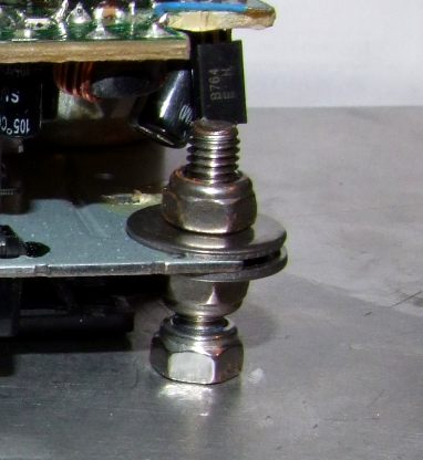

2. Hanging mechanism detail
As you can see from photo 4 bolts and 3 nuts per bolt are used. This give me option to fine adjust mechanism position against base plate.
All nuts and bolts are stainless steel, so no-magnetic influence.

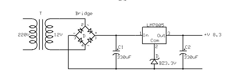

3. Power supply
Electrically this perfectly ok.
Original trafo, bridge, regulator 7805 plus zener diode 3.3V gives 8.3 V and it is working perfectly ok. I am in doubt about using bigger trafo. Seems no much reason for that. Existing trafo from JVC do not heat at all or very litle. Will check with osciloscope later.
I read about 47lab philosophy about not using big energy acumulators on any way. Here I used 2 RIFA 330uF each. Whole thing sound perfect. Well I am going give a try to bigger capacity in near future.
3. Power supply

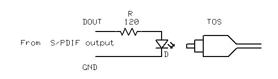

4. Signal line.
Here I made bit funny thing.
Red lighting diode from optical mouse and 120 Ohm resistor in serie directly to S/PDIF output as shown on schematic.
Against diode I put open end of optical kabel and lead it to external DAC optical input.
You wouldn't belive this work so great.
Look in real at the photo in next post.
Many of us, included me, have experienced a better sound with three or two (better) standoffs. You should try. I use two and have not any planarity issue.

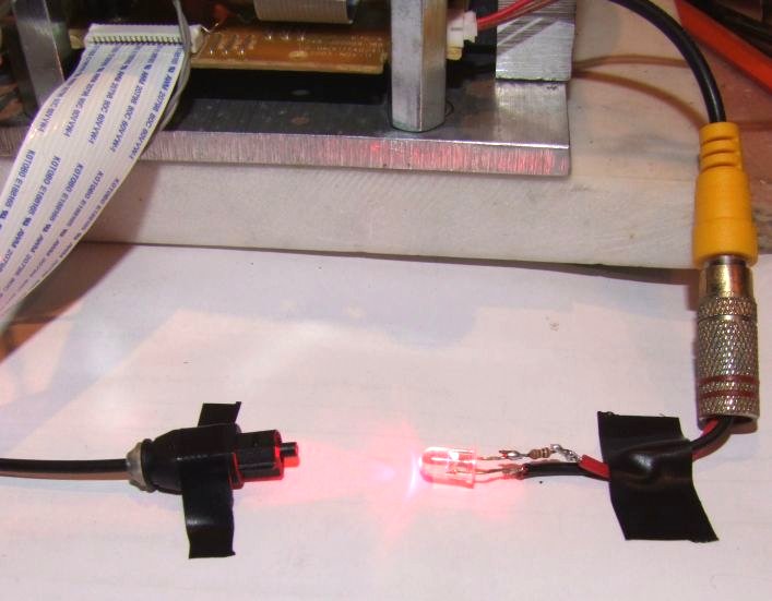

dzuvela said:Optical link in action
This is all so far. There will be more after the Christmass .
Does it WORK?
brgds said:
Does it WORK?
Sure it works.
I am thinking about to make adapter consisting of chinch connector on one side, diode and resistor in the midle and some rubber to fix TOS connector at other end. This way any coaxial output culd be used as optical source, without impedance issues. Disconecting it one can use coax again.
Funny isn't it?
The catch is that TOS link itself is very primitive in compare to professional optical links, for data transfer or in telephony e.g. Special fiber optics is used, laser diodes working in invisible range of light, and so on....
TOS is simple and primitive, piece of transparent plastic thread and red diode light. But working great at small distances.
I know that reports about 2 or 3 standoffs. I believe that I can tight mechanism plate precisely adjusting nuts at each corner avoid any bending of the the mechanism base.
Forgot to mention two more things.
Nuts are all selflocking. Ordinary stainless nuts can unscrew easy.
And...
The main axe of CD drive/motor is placed in the center of Al plate. This way I got mechanically symetrical position of the center of rotation what would result with overall better mechanical behavior.
Aditional balancing will be done by ading weight oposite to the rest of mechanism position.
( similar to the vehicle teers balancing )
Dumping elements will be placed in plane which is parallel and as close as possible to the plane of top plate. This way all vibrations must have its minimum. Will be more clear in couple of days when I can have photo or draft.
To achive all this, 4 bolts or stanfolds should be better solution. But of course nothing is easier then unscrew 1 to 2 nuts to check difference.

brgds said:dzuvela,
have you compared sounding of your primitive toslink 🙂 with coax?
Honestly haven't heard any difference. But also need to set up better listening equipment. I mean on headphones.
I was more in mechanical stuff this first period. Some measurement follows as well more accurate listening.
Regarding my funny TOS link. It just happened that I had no proper TOS adapter by hand, so made one my own. Of course this will be compared with more professional one.

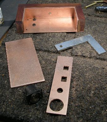

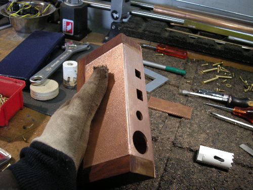

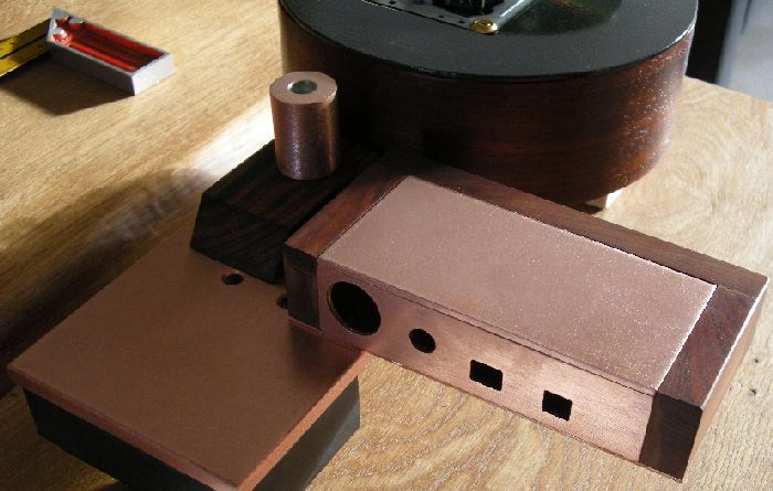

Today I completed the shielded box for it...
