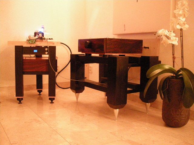

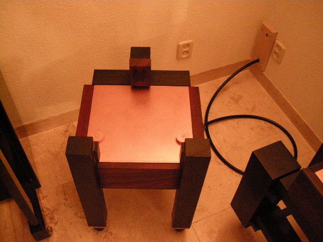

Erik van Voorst said:Lifting the PiTbull doghouse is from now-on a 2 man job...here it is in his (final) place.....
The Tunami is still a bit to long but I will take care of that afterwards
Verry nice work , have you had it on the weight ?

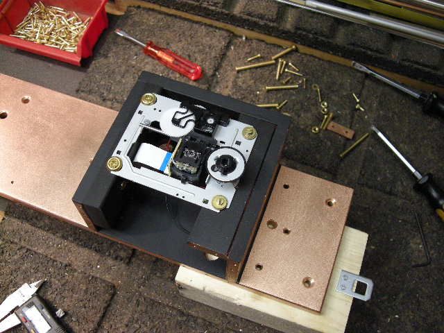

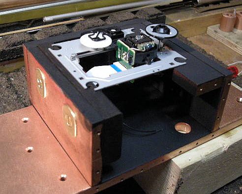

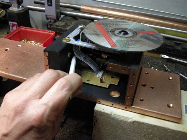

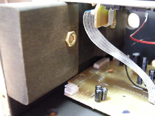

The 2 holes for the screws in the ebony were already there as the motorhole with its own M5 screw
After mounting the motor in the "motor-mounting-hole" I know now the exact location for drilling two M3 holes in the copper (left and rightside of the motor...it all worked like a charm...
The dummy showed me the first problem...uhh ...I mean challenge
The laserlint will touch the ebben when the last tracks will be played and very likely will obstruct...(visual inspection only)
That means marking and milling a gap the size of the lint...(fortunately the ebony is thick enough)

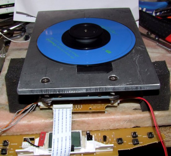

Hi everybody!
I have been introduced to this great project week ago or so by Mr. Sparkle member of this forum.
Well, after quick exploring next day I have found myself in local shop and lucky enough, found there last piece of 31's.

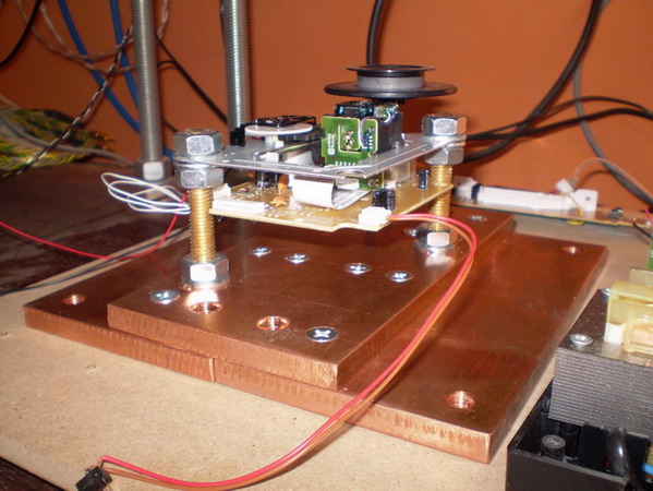

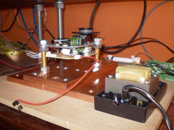

Continuing to explore this huge thread and working on my example simultanously, today I decided to share bit of my progress as well few tricks someone may find helpful.
Now comes harder part. Not sure if posting photos will work.... let see.
1. The base plate (Alu plate 6mm thick 135mmx19mm). Plate is mounted on top side of the drive:
