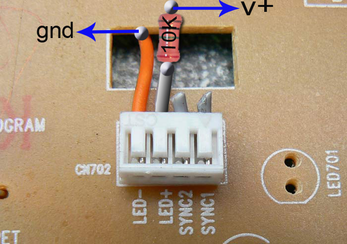

I made a mistake and connected the V+ to the wrong pin of the LCD.

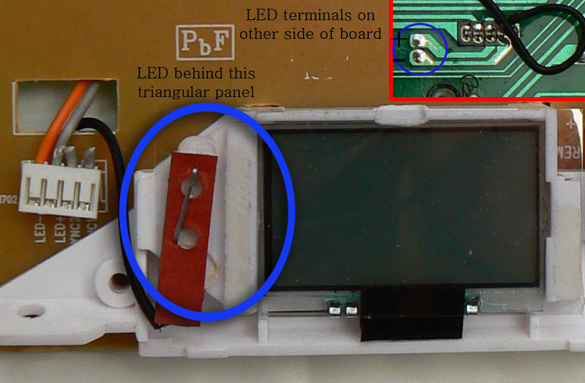

Badge said:I put a 10K ohm resistor in series off the DC output of the power supply. I never did see any back light so I checked voltage. I had 7.5 volts. I am assuming I destroyed the LED? How do I access the LED for replacement? Looks like the whole display needs to removed? So close yet so far.
Just remove the triangular lid and desolder the LED from the back..
It isn't necessarily the case that you destroyed the LED, you must have connected it backwards though. (The led reverse breakdown voltage is certainly lower than 7V, but the current was limited and it might/might not have survived the experience.) Recheck the connections first, (no errors, missing ground?) reverse them if necessary and then if finally replace the LED if necessary.

Thanks for the info on my LED. I did check it with a meter and get no forward resistance so I did fry it.
Badge said:Thanks for the info on my LED. I did check it with a meter and get no forward resistance so I did fry it.![]()
Consider it an opportunity to choose the color for the display that you desire. I really did not like the orange, but the blue looks really nice now. It is an easy replacement.
