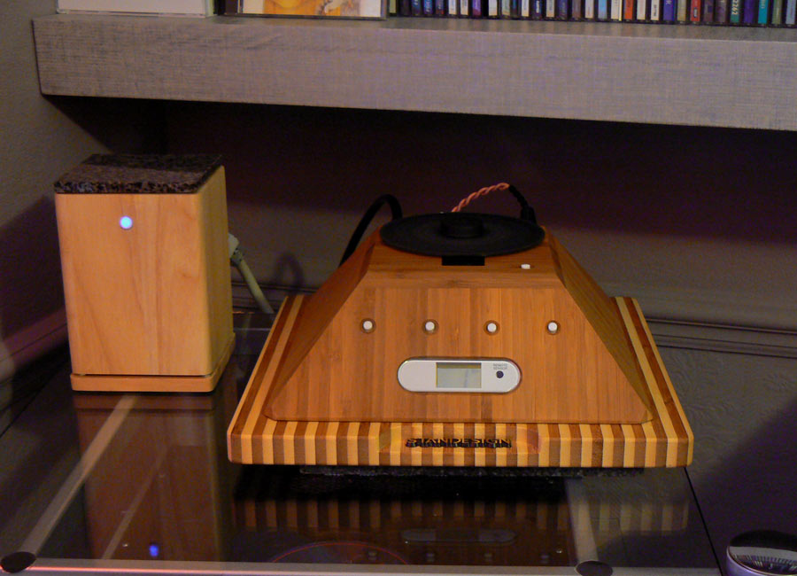

Finished building my CD player..It's just an upside-down bamboo bowl😉 .

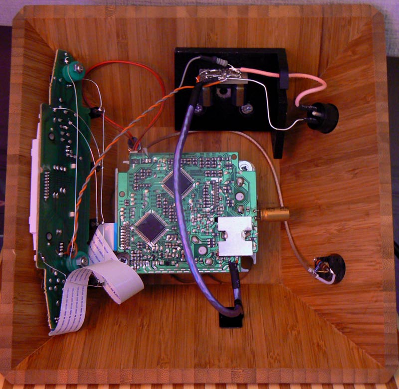

Just removed C952, C916 and associated decouplers (as Peter suggested). Re-placed and re-located C916 so I can test different makes of cap (at some time in the future) with ease.
Managed to fit the display board in one piece, so that made life a lot simpler.

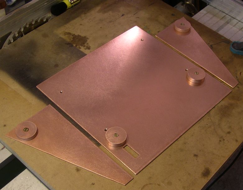

Today starting with the last bits and pieces...spraying all the copper....after sanding it with a machine and grain 60...to give it a brushed appearance.
I use hammerite clear metal varnish spray ....a 5 coat will do to give a bit of depth...every hour a new coating.
For difficult to reach parts I use Zappon Metal Laquer with a brush...2 coats will do...to give it a silky shine like a dim lit tree....
The 12 mm copper wheel-like objects are the handles to lift the plates....cause there is a need for that being 3 mm thick and flush with the surroundings...I had them lying around as a left-over from my pre amp so I put them to good use....
The 4 little holes are not for the screws but to give the transformers (5) some air although they are nearly becoming luke-warm...
