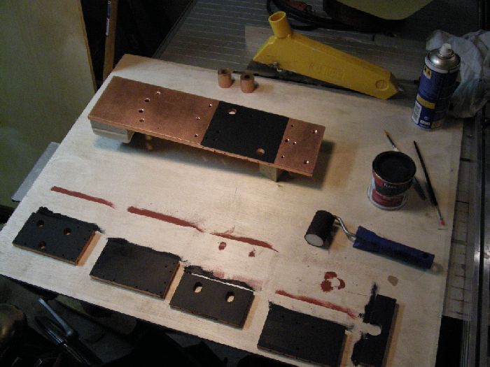

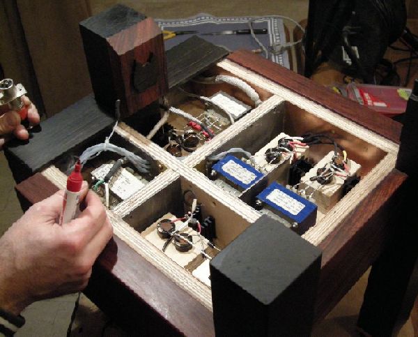

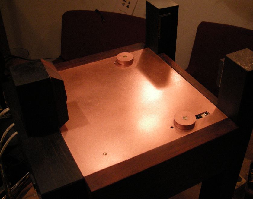

A major step forward in finalizing the PiTbull Transport...
After building a dedicated psu for the AT&T board the Power Supply Unit was ready so closing the lid with a relief....
For alle the primary wiring I used soft anhealed single core OTA cable and secundary the silver-paper-silk-cotton...
