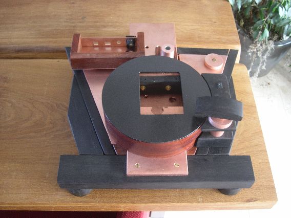

today - i have decided to substitue my stands on the transport.... i have put wood there (similar to what Erik did).... only Erik is using ebony (i think) and i have put there padouk ..... man!!!!.... this is nice and easy mod to do.....
and the sound has changed a lot - everything is better.... much better..... i have to try the brass stands..... will see how that one is sounding too.....
Erik - wood is my element for sure.... wood and metal - even better......

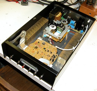

Yes, that's what I said and this is what I did here: PS contains transformer and two diodes, filter caps and regulator are inside the transport enclosure.

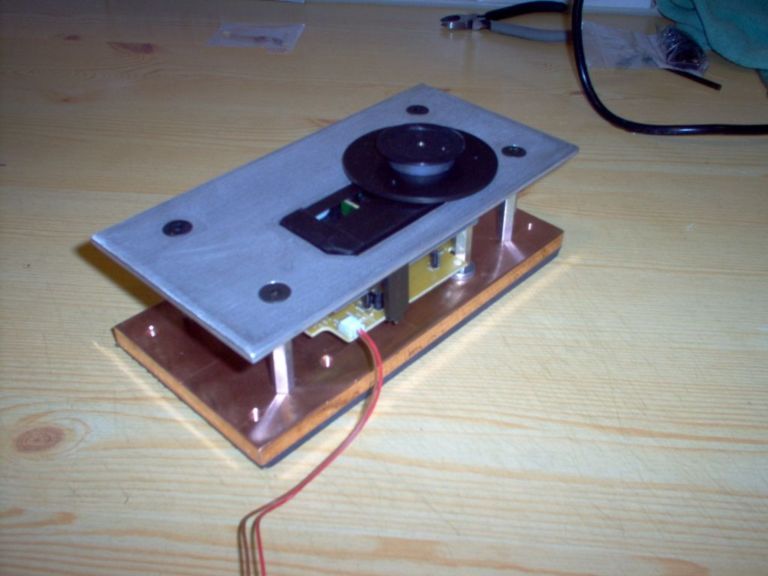

Hi folks
Time to post some pictures of my transport.. Iam running the transport 100% orginal atm all parts ate stock.. but i will be tasting new others caps the comming weeks
i did uplade some pics here http://photobucket.com/mr6b
Valo, very nice.. Do you have a little clearance between the plastic mechanism housing and the top plate?
kevinkr said:Valo, very nice.. Do you have a little clearance between the plastic mechanism housing and the top plate?
yes I have, I made a 45 degree edge around the hole so that the topplate gose clear
