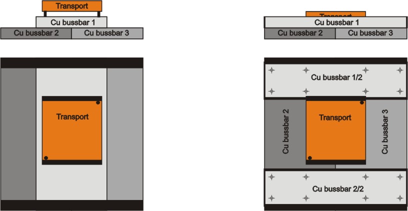

o.k. - i have a question - nobody had a suggestion - so i am trying with the picture attached....
i was thinking about two options....
1. to put three copper bussbars in paralel with each other.....two of those on the "ground floor" and the third one on top of those two... and than to mount the mechanism on top of them - the total thickness of the copper where i will mount the mechanism will be here 20mm (each bussbar is 10mm thick)....
this option is on the left in the picture....
2. this option also has wo opper bussbars in the "ground floor" but the third one has been cut through the middle to form two separate bars - and than mount them in the front and in the back of the transport - in this case the mechanism is mounted on top of the "ground floor" and the two part of the third bussbar are here only to connect everything together and to make more weight to the whole thing....
as i have menioned - i have three bussbars that have a dimenisons 200*100mm and they are 10m thick..... so this will be used as a base for the mechanism 😀
one more question is - if i should connect upper floor bussbars with the ground floor directly or should i use something in between them - i have some subber, also some material that is in fact cork mixed with rubber - we use it in our company for the power transformers to seal the transformer from leaking oil.....
please sugest me if possible - what to do - to make the best i can from what i have.....
thanks in advance for any answer.....

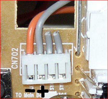

I wonder what is the connection for the LCD backlight.
The connection is 4 pin with LED + and LED - plus others. Please advise how to get back light? can I use the 8V DC
ccschua said:I wonder what is the connection for the LCD backlight.
I connected positive just after diodes plus a 5.1kohm series resistor to dim the light (10k was too dim)
You could also install a 10K pot just in place of Peters resistor shown above and be able to adjust the light level.

looking at the picy Peter posted with the resistor on the display board, it looks like the solder bridges the two trace points to the left-upper and lower. Is this intentional?

It actually looks like there is a bridge on a LED, but it's not. The other connections can be done in any other way, as long as it works.
