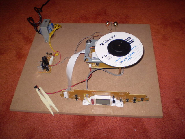

i have turned it on - mine is model '31.....
it is working like a charm using L and R output and on board dac..... better than my DVD Pioneer DV-355.... right from the box with original psu and everything.....
it is more clear and more relaxed sounding.....
Peter Daniel - i have to thank you the most for starting this thread....
this baby is only working - i will put it inside a proper box with a proper psu and everything......
thnx again also to everybody else that made a contribution here....

Well done!
I would really recommend getting an external dac. I am borrowing one from a friend at the moment and although its a long way from being the best dac, its a massive improvement from the offering on-board.
Peter supplies a great sounding dac by all accounts 😉
If you think it sounds good now...just wait until all the new capacitors have time to stabilise!
Richard
now i have removed R4 (in the *.pdf) - that inductor on the power supply..... great - the sound opened ....
even better !!!
i know i know.... the soonest i catch some time i will build a dac.... but right now it is sounding better than my dac... it is not burned in - nothing - straitgh from the box..... nice....

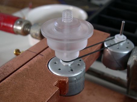

how is motor speed controlled?
I am planning to move the motors off board using pulleys and a drive belt. the simplest solution would be a 1:1 ratio but i was wondering if i could "downshift" a little by using a smaller pulley on the motor.
would the motor control compensate (is it in a feedback loop) or are the rpm's fixed (preset)?
can the motor handle higher rpm? - how much higher (double?)
the mechanism will add mass, does the stock motor have enough power? - how much more mass?
any related comments are welcome.

Re: how is motor speed controlled?
A while ago I have made a quick beltdrive as a try-out...using the cassettewheel and belt (you need 2 boomers)
I got it working ..uhh...a mutilated P. Barber came out .....but as I said loads of error corrections /jitter...
I reckon a lot of work and other materials to make it happen....
For the moment I will leave it alone but I did make a provision for say .......in the future
The photo is not showing the set-up I have made but gives an idea of what I did...

a question.....
i am using a model 31 - right from the box - no modifications except i removed the psu inductor ... also i am using the original psu and a transformer.....
it seems to me that before i removed the psu inductor, that the transport was much more quit..... now, without the psu inductor it seems to me that it is making more noise while reading and skipping..... is this possible??? .... ..

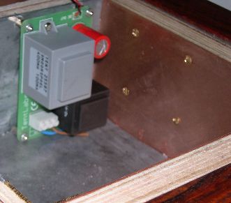

i have managed to find a copper bussbar - 70cm long and 10 cm wide.... it is 10mm thick....
Guys - how would you suggest to arrange the bottom of the transport ????
to cut this bussbar in three pieces and to put two of them side by side and the third on the top.... and on that one to put the transport....
or to put two of them side by side and than to use the third one over them and on a 90 degrees angle.... or something....?????
suggestions - what would be the best way to use that copper bussbar

Re: Re: how is motor speed controlled?
The hysteresis of the cd motor powering is altered when you add a belt drive system like that. What you can do is add more flywheel to the CD spinner
I opened the motor and I removed everything out of the non powered "pancake" Mabuchi motor (cutting all the stuff loose from the spindle in order to end up with only a puck and platform on a pin) and closed the empty housing carefully again.
On the other hand I must say that my way of mounting later on will probably induce another pleasant tweak......so no present belt-wish ...😀
