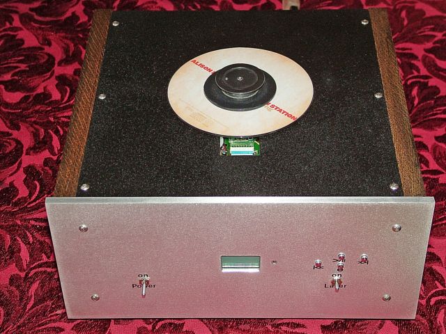

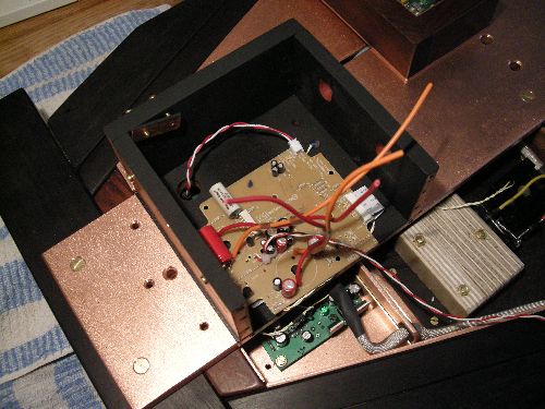

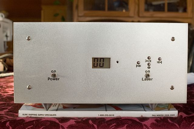

Again a step further...again a couple of hours work with inbetween merry christmas and happy new year....

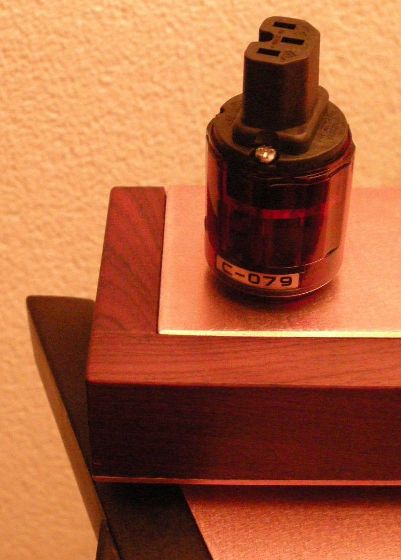

BTW I bought the Oyaide Gold plug so a friend of mine could get my wattgate and I could get one in matching colours...since it will be clearly visible....😀

Re: Lettering on front plate
Tadousac,

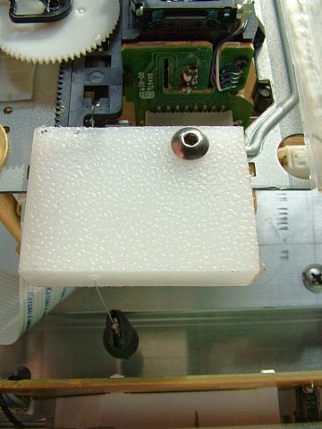

could you pls take a closer picture of your "fishing" solution, how heavy is the weight?
thanks,

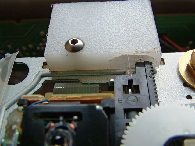

Tadousac said:Hello Fran:
Notice the white plastic block on the front of the laser frame.I used Eric's idea and tied fishing line to the sled,passed it through a hole in the plastic block and let it hang on a brass fishing weight.This modification took the slack out of the geartrain and things sound clearer and more focused.
Tadousac,
thanks,
fishing line weight
Hi Andy:
I will take some more pics of the fishing line weight tomorrow.The laser toggle is the toc switch labeled so that other users will not look down into the laser.Golden rule is laser switch off while turning transport on, or loading a disc.

I notice that most mount the laser mechanism pointing towards the front of the housing. Is there a particular reason (like ribbon cable length) for this? I'd like to put it pointing towards the rear of the housing, if possible.
(I can't check for myself yet as I'm waiting for the '51 to arrive.)
has anyone who has a unit up and working experimented with transport lubrication? I had a drop out at about the same spot on each CD. I think I solved the problem by cleaning the rack part of the drive? There was some small debris that the cleaning removed. I put some thin lock oil with graphite on the straight plated steel transport guide.
Re: fishing weight pics
Hi Tadousac,
many thanks! now it's clear.
Looks like you don't utilize the full potential of the line
I'll try something for roach fishing.
Tadousac said:Hello Andy:
The lead weight I used measured 5 Grams.I encased it in shrinkwrap tubing.The plastic is from a kitchen cutting board and the fishing line is 6 pound test.

I think I'm gonna have to have a go and try this mod using the weight!
How much of a difference does it make do you think?

Hi Woodfran
The best way is to use a small lead weight and cut bits off so you are actually shaping the sound...the more weight...the more weight in the music....I kid you not....give it a try ...
A quick experiment to find out if it does something is installing a weight and while listening....lift the weight with the palm of your hand....and see what I mean...good luck.

Thanks Erik,
I hope to give a go over the weekend. I might try to fashion a little "bucket" and then I can add or subtract weight as desired. Blu-tack is another way of going too I suppose.
