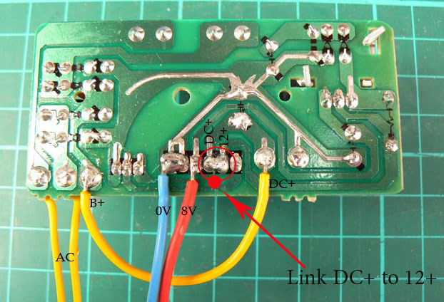

Ok, the rectifier board (BTW, there is a B+ pin there with a wire, close to the AC ins from the transformer: what is that B+ wire??).
Then, on the rectifier board, I have DC+ and DC- cables, that should go to the main board (the CD board, of course) connecting to +8V and GND, right?
This is the situation...
Kooka said:Ok, the rectifier board (BTW, there is a B+ pin there with a wire, close to the AC ins from the transformer: what is that B+ wire??).
The B+ is the wire from the battery compartment (via a switch on the power coard connection).
When there is no power cord in the boombox, it can run on batteries. When you plug the power cord in it disconnects the batteries (you can see a switch on top of the power cord connection).

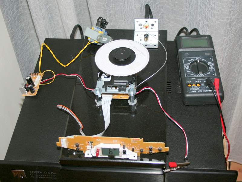

Well, thanks anyway bro, that was appreciated anyway. And I think I solved the situation, now... 11,5V with no load from the 8V pins: I guess it starts being ok.
thinks 11.5v sounds to high, trye to conect it to an load and see how mutch it drops befor you connect it to the player
Still on the high side...
Do you have some resistors lying around? Maybe you can load the 8V up starting with 470 ohms and then down in steps. See if the output drops towards 8V more and more if you lower the load-resistance.
I measured with a clamp amp meter (very inaccurate at these low currents) on the 8V wire going to the CD-board. With a CD playing it seems to draw around 0.2 A.

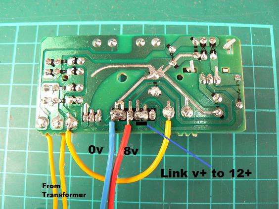

Ok, it worked: just connected the B+ wire to DC+ and not with the 12V+.

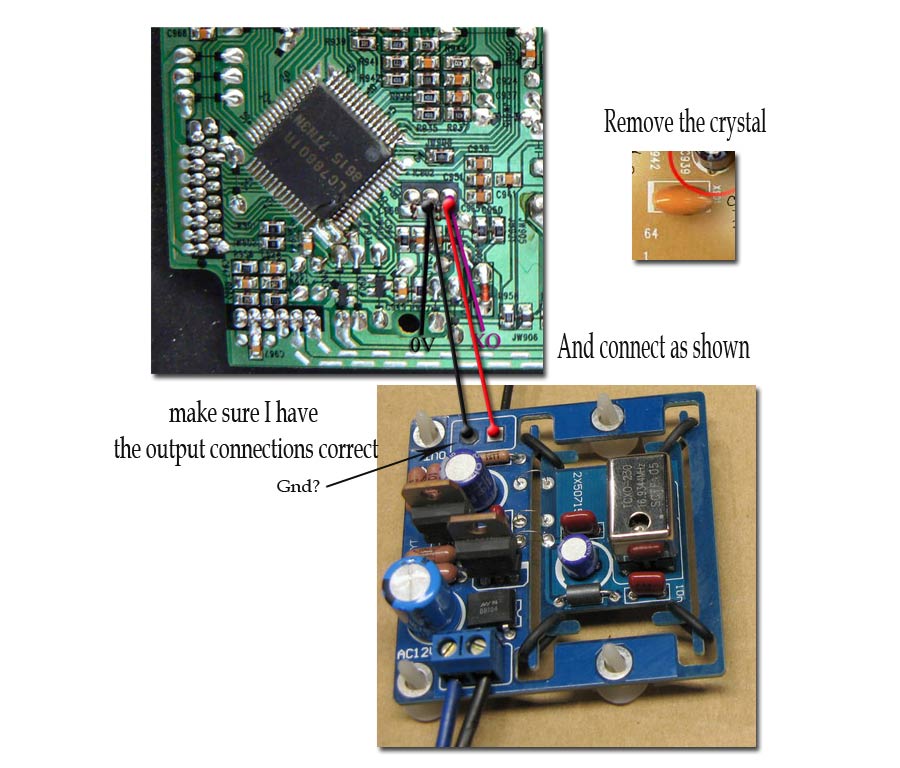

valo said:A quick question for Audio1st
I did see in somewher in this thread that you did use the "red" ebayclock, but is i can remeber youre clock was a litle modyfied, guess you have removed the bridge so that you may run it on DC rigth ?
And did you connect it like its done in this picture ??

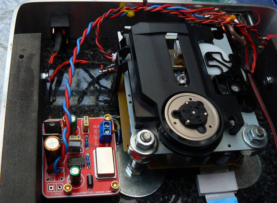

Hi, yes I removed the bridge and powered it from the DC before the 7808 (about 17V). I also had to change the gold cap on the clock board because it only had a 16V rating. Only a single connection to the crystal location (XO), because it shares the same power supply ground.
