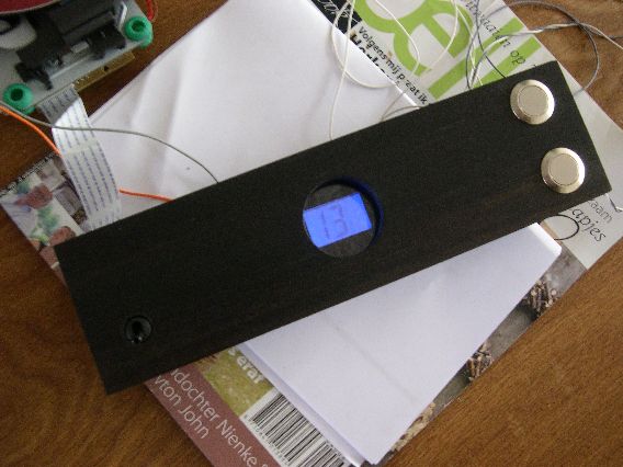

I finished the display...
For those among you who are NOT superstitious
...one of the two expensive switches was internally defect while I was looking elsewhere....yesterday the extended infra red eye
worked perfectly...today nothing...and while everything was assembled I saw a tiny white dustparticle underneath the very first transparant foil-layer of the display...so the whole show dismantled again...grrrrrrrrr
Anyway it is completed...and bravely showing no. 13 :dead:

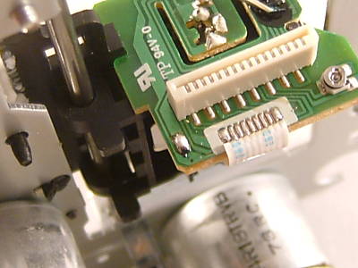

okapi said:
can you take a pic or describe where this solder bridge is located?
In the picture it's the solder blob at the lower left end of the board, near the left hand end of the ribbon connector. Removing it with desoldering braid will reveal two separate islands.
John
