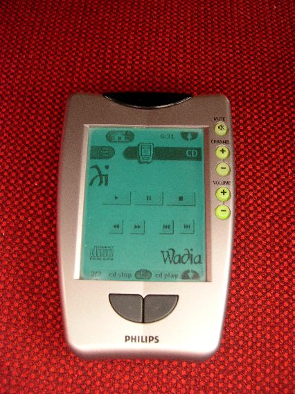

Re: remote control
Yes Fran I use the Philips Pronto...
Altough it still carries my homemade Wadia Logos (I will soon change that into the PiTbull Logo....) the buttons are re-programmed in the JVC ( the small remote comming with the boombox) commands...
Since you obviously cannot download the .ccf from
Remote Central Com....hahahahaha.... I used the learn function ....
It works from even the most difficult angles...

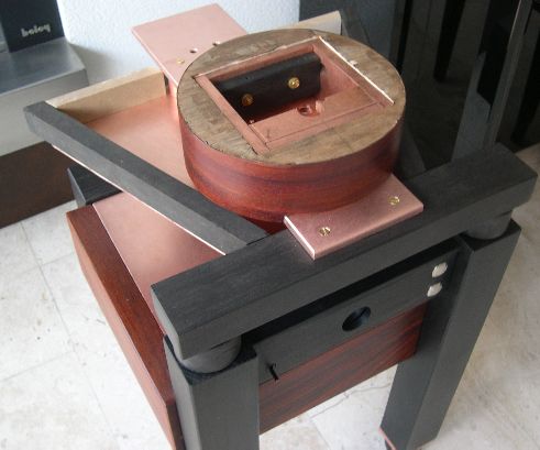

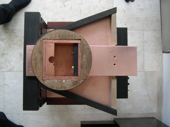

Thanks for the compliments...
I do not know exactly what you are getting at..so I will give a few answers and maybe there is a usefull one among them...j😀
I have built (and still are building) the Shiga as a transport and the costs so far are 3000 Euro....(without discussion for me in my set up indeed heaven)
I use the transport in combination with a DAC Audionote 3 incredibly modified by a dutch guy Peter van Willenswaard....who is actually a wizzard in designing a good circuit with non oversampling and tubes all over and no electrolytics but a disaster in layout and soldering....but that does not bother me because the results are great and I can take care of the rest...
Anyway this DAC sets you back another 3000 euro (they compared the dac with the dac 5 signature 25000 euro and....)
So it is hardly anything the topic starter promised (since affordable is such a relative term but mostly used to indicate CHEAP) but as you
aptly called it for me....HEAVEN...(I had another 6000 euro Wadia over the week-end and ...no match...so all worth it)
My feeling/experience is that most of the people using the original Shiga use it in conjunction with a nos dac....I reckon a dac PETER made is also a very good match ...so affordable diy stuff...
I think the last choice would be to use the dac in the Boombox...it probably would give you a bang for the buck but cannot be considered serious music-pleasure due to its budget limitations...but than again it is also fully justified to get an immense thrill out of that DIY work as well....
