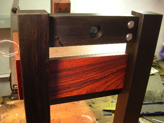

All done!
Erik van Voorst said:My Transport already blends in nicely...
Sorry just a little proud...![]()

Anyway today I mounted my display...the plan came together...
I can now take it off easily by hand if necessary...
