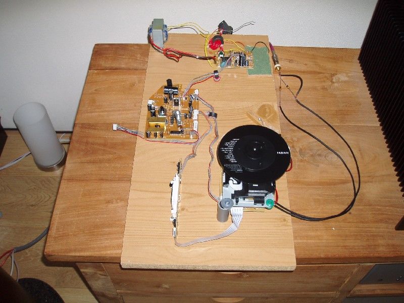

This is a great topic!
I've got a rc-ez51!
It's playing complete standard for almost 24 hours.
The sound is more open, but stil not that perfect. 🙂
My standard player is an arcam cd23t.
Now i'm searching for some parts.
For the ps some black gate fk 1000uf/50, en N serie 1000uf/50v,
Schottky diodes msr860,lm7808 etc.
The little bg caps have i already.
Has somebody some addresses for this parts?
Especially the fk and N bg 1000uf/50V caps.
Thanks guys,
Here a picture of the 51.
