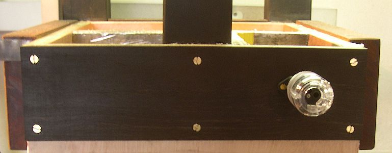

...and the finished product...that is to say this is still the inner display....the idea is to get a coinsize-like display with depth...so another long piece of ebony will be used to mount on top of this display together with 2 buttons (play and stop) and the TOC switch...

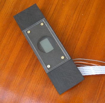

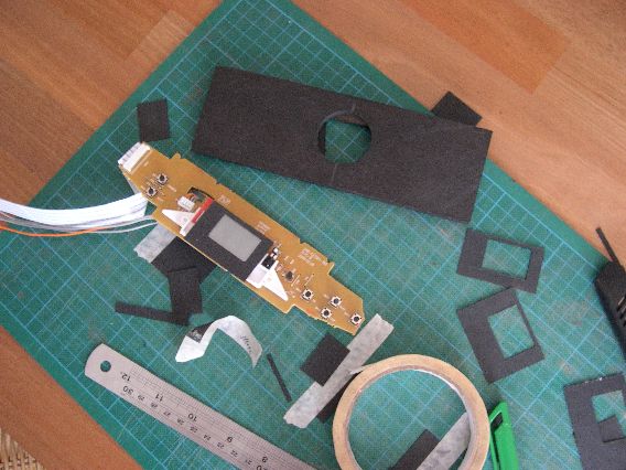

Tonight I worked on the display...
I had a bit tough luck but in the end....
I made an extension for remote receiver and 2 very nice and very flat pushbuttons
start (pause) and stop....
The pronto remote is already programmed with the remaining functions and the display with the extended receiver is listening to all of them.......

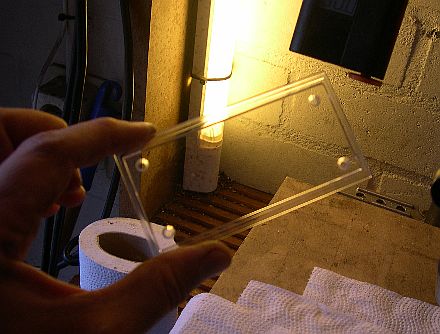

I cleaned the window with (I thought) harmless alcohol...and ...bang....everything WHITE....
So I had to polish with toothpaste to get it clear again......
I taped the print and its display ''light- and dust proof'' then I found out that I forgotten to get the remote connections from the print...
You can now clearly see that I will use only the coinlike window...the rest is tape....the result is already a nice 3D look...photo is not so clear but when the lights are off.....MAGIC...
