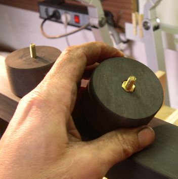

So taking a lead from the ceraballs but with a love of wood, I decided to make my own version. Here are the components, a machined pillar with grooves for some o-rings and a dimple in the bottom for a ball bearing. The top is tapped for the M6 screws mentioned earlier. The base is some ebony bored to take the pillar:
And assembled....
The idea is that the ball provides decoupling along with the bit of give in the o-rings. The pillar fits with a suction fit into the base.
Lastly tonight a rather poor pic of the feet in place under the base plate - they look better in real life. The M6 screws are held in the plate by some thread lock so the feet can be adjusted for levelling (about 4mm each foot)
