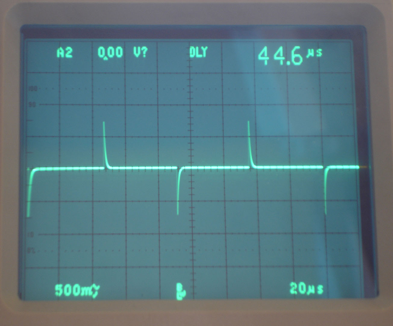

First all FIR taps set one 1. (so 2 times zero insertion only: at FIR1 and FIR2). Perhaps that should be called the bypass filter instead of "NOS".

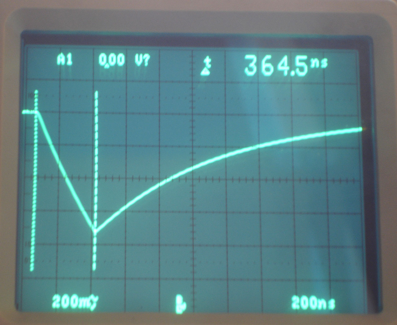

For an explanation of that lets have an amplified look at the first negative spike of the bypass filter (i.e. the raw output of the DAM)
The time of the, next to linear, negative, rise is 1/(64*44.1kHz) ... fine.
This is the typical diagram of charging (not to full applied voltage) an decharging a capacitor.
So the voltage pulse of the DAM is to short to charge the capacitor (C135) completely. Secondly the decharge time is considerably longer (due to the high resistive load). The other two filters continue "charging" and result in a higher output voltage.
As also modern preamps and amps have very high input resistance, the situation might there be similar.

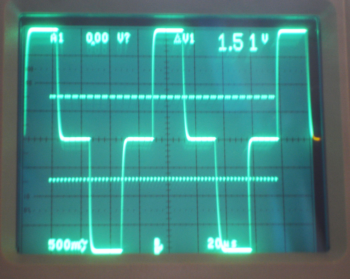

Second the NOS filter of pos (FIR1 and FIR2 8 taps 1)

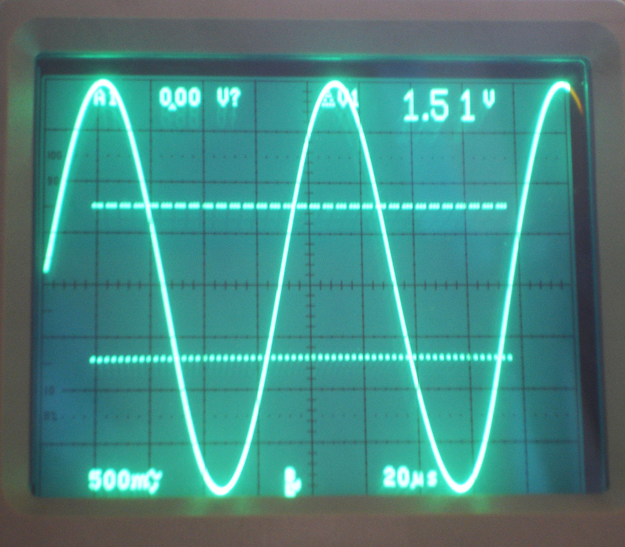

And last the stock filter from Soren
Quite that what you (or at least I) would expect, except the much higher output level with the last two.

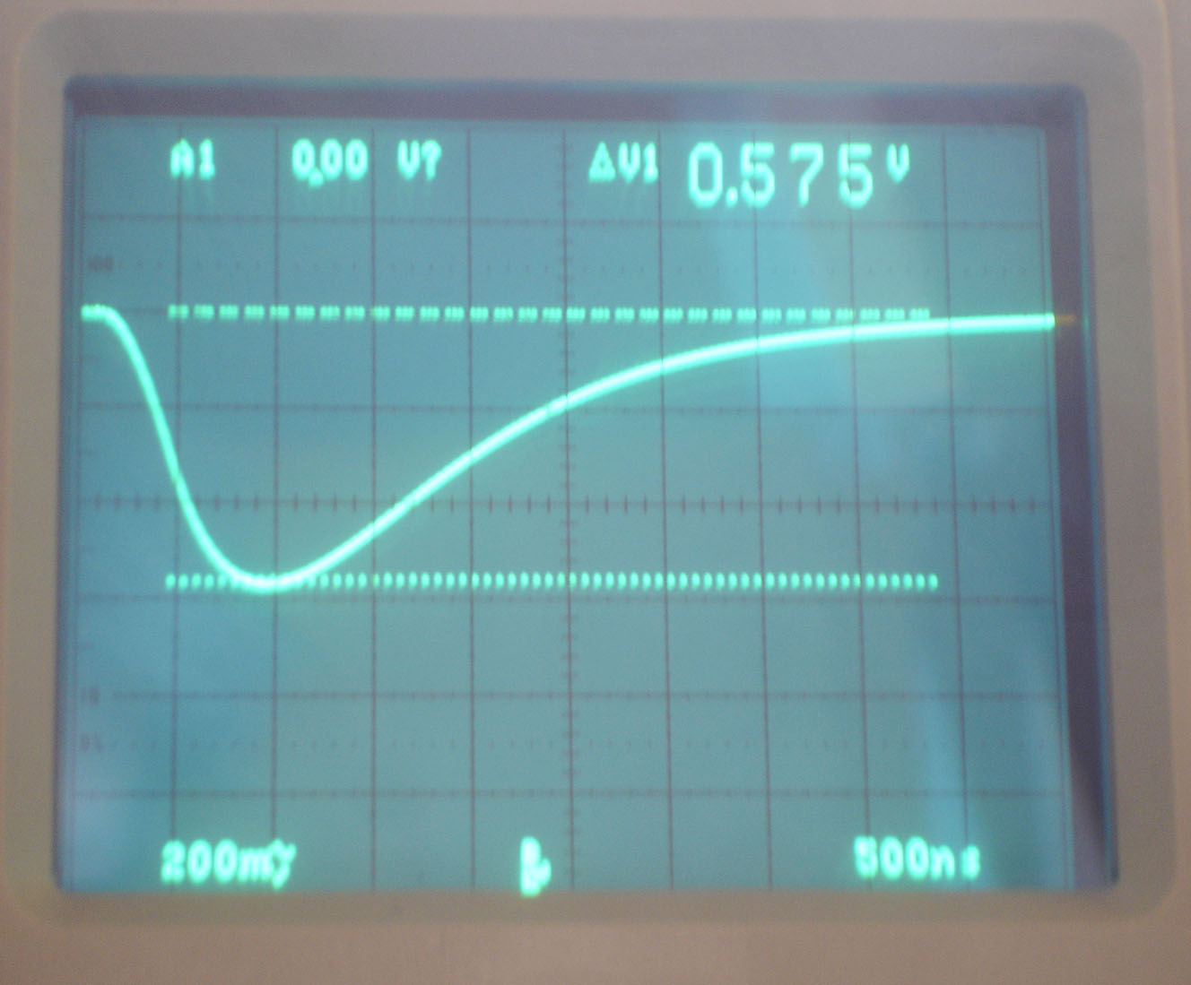

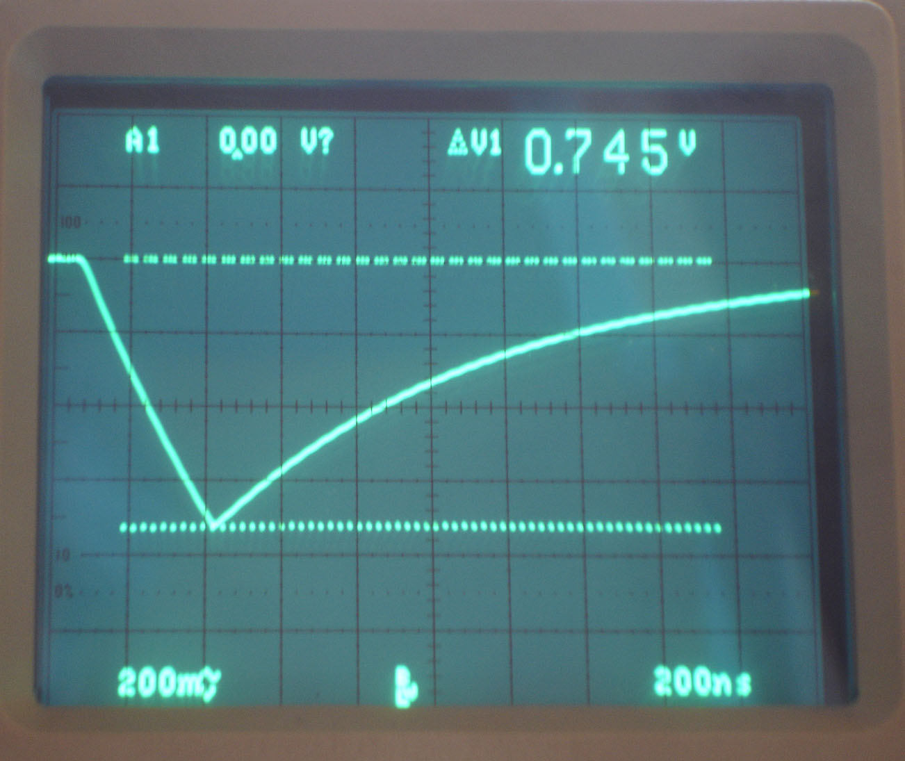

Last picture, the bypass filter spike at the balanced output (other oscilloscope time base).
You see that even the excellent op amp of the balanced output is not fast enough to reproduce the SE output spike.
I for myself think I will not torture my equipment with the Bypass or NOS filter.

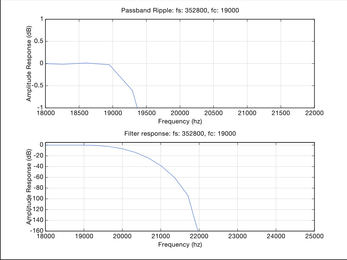

Current filter I'm listening to has a 0-19kHz Passband and stop band starting at 22kHz. This version has two identical filters convolved together. There is some low level ripple in the passband but is 0.03dB p-p in the worst case, and less than 0.01dB p-p at 10kHz.
