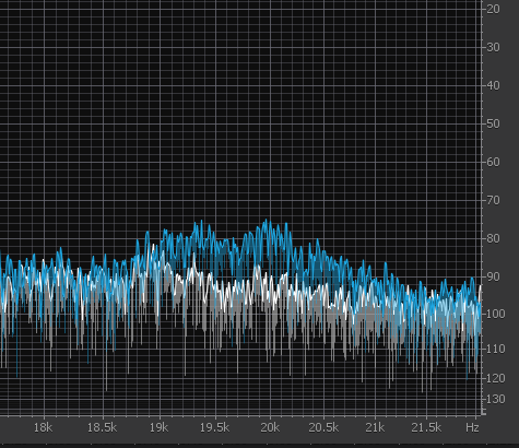

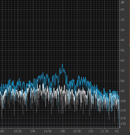

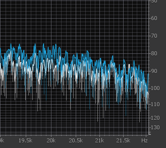

I've checked a selection of my CD rips, and they ALL have content above 20kHz, most to at least 21kHz and some right through to 22kHz, so I suspect it's actually fairly widespread.
see attached screen shots from a track called Stopover Bombay by Alice Coltrane. Sorry about the different zoom levels.
It is pretty low level but it is there.

No recording engineer I know does filtering up there by default, only if audible problems occur, so I would guess most recordings have some signal in the transition band.
But the AD converter with its filter should take care of that also.

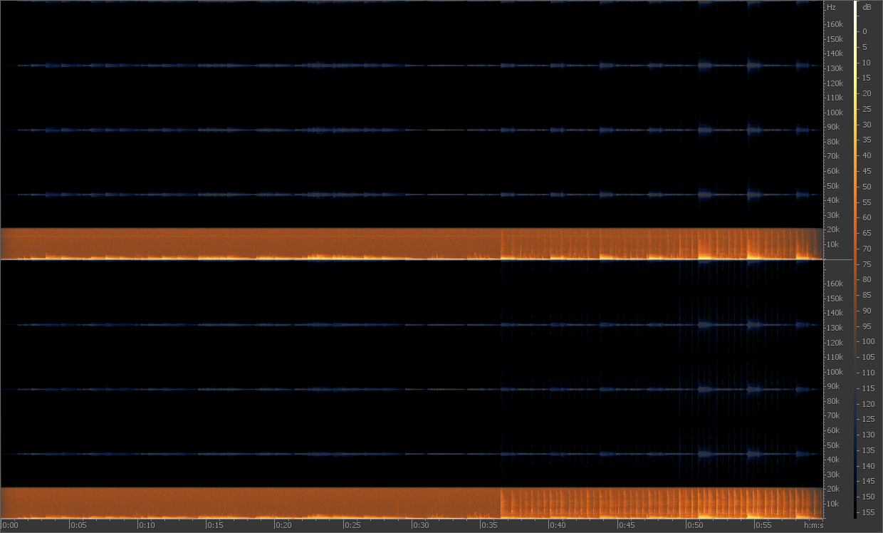

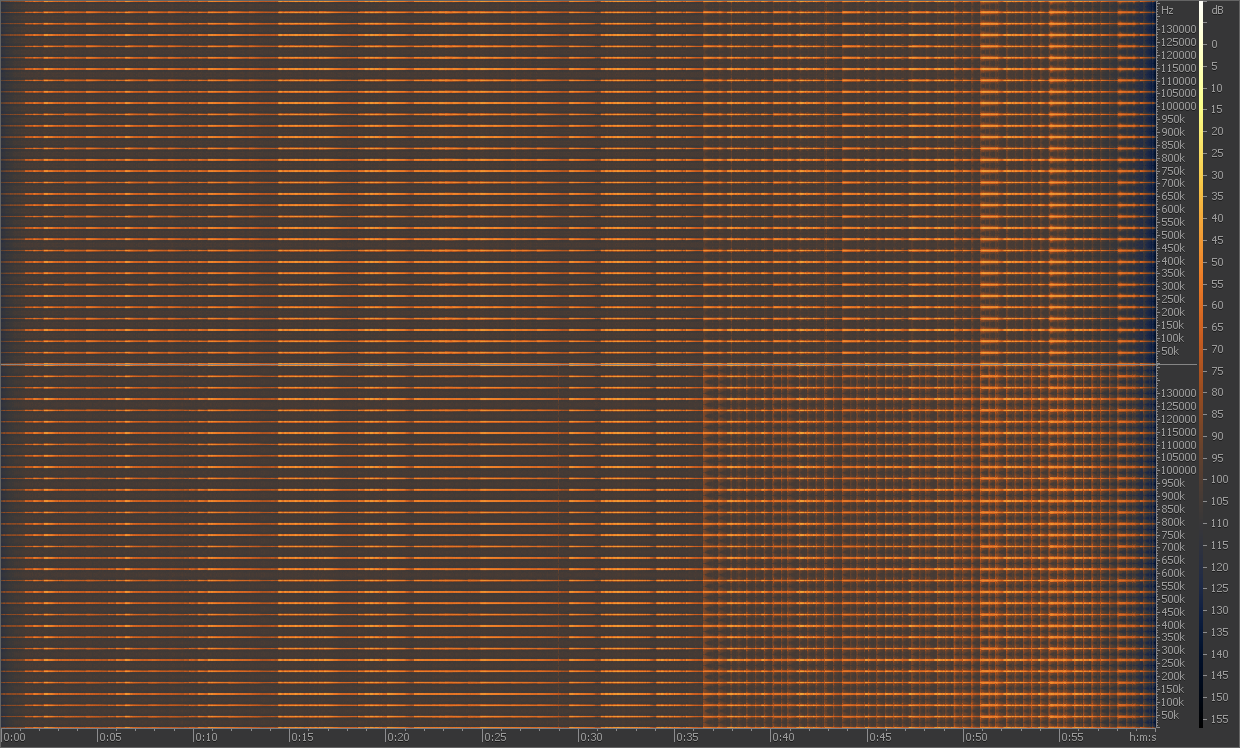

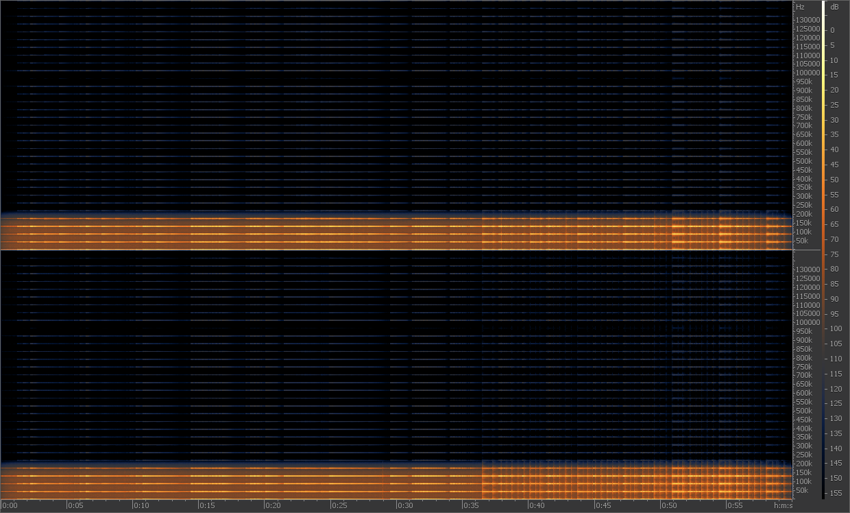

I've attached a few screenshots of the first 60 seconds of Miles Davis's "So What".
First is a straight rip from CD:
attachment.php
Second is up sampled x 8 with no FIR filtering applied:
attachment.php

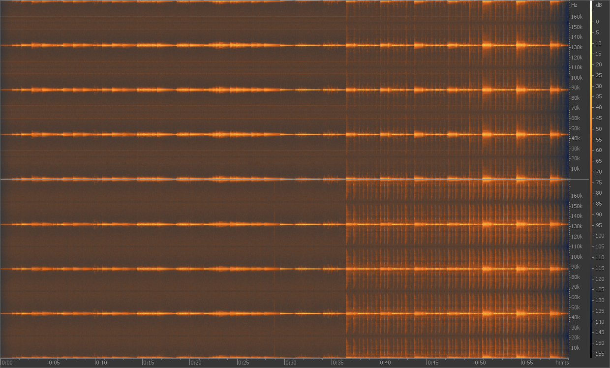

Third is a basic linear phase FIR filter. You can see images of the sub-2kHz audio mirroring. These images are around -80 to -90dBFS.
attachment.php

continuing...

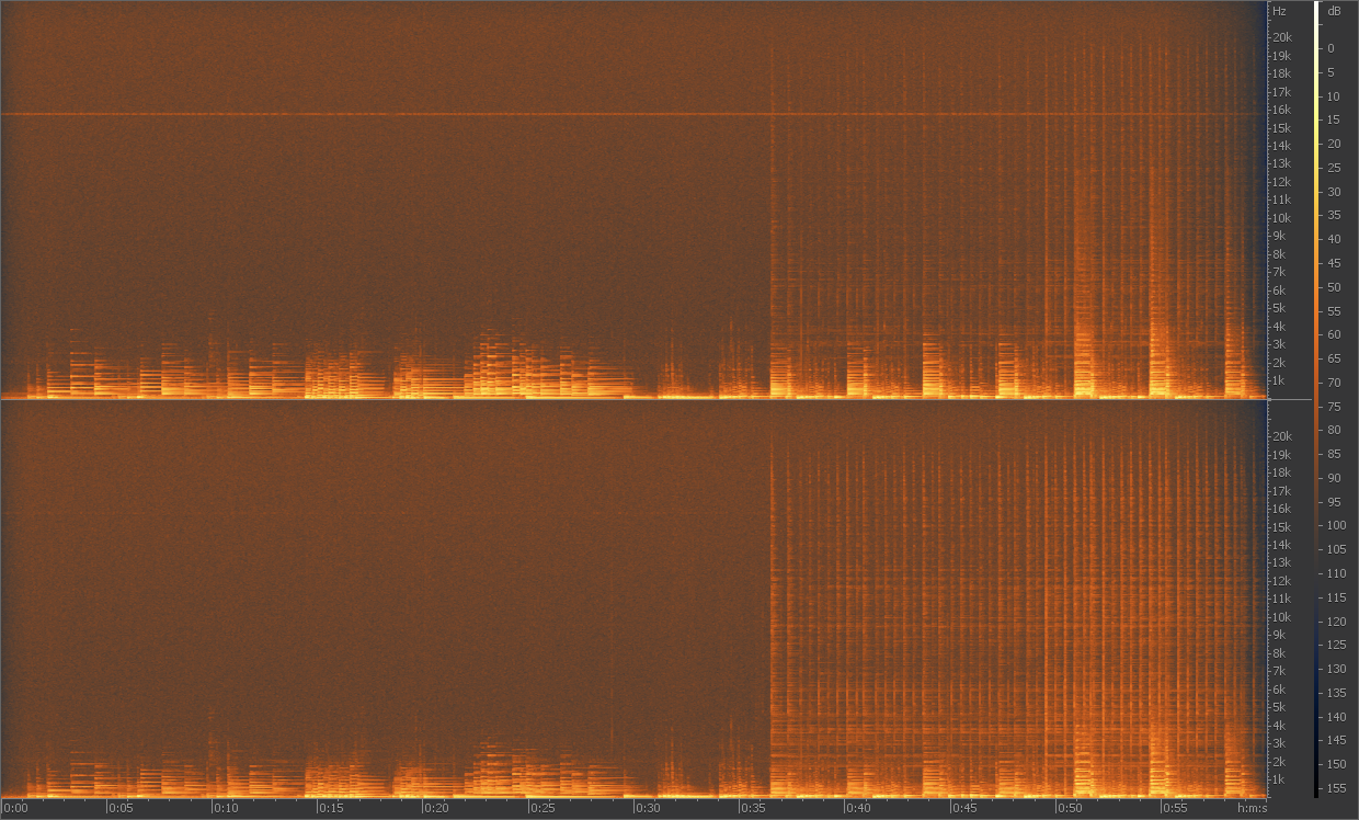

Next one is upsampling x8 of the upsampled x8 SoWhat, with no filtering applied:
attachment.php
And as above with only FIR2 filter applied
attachment.php
The analog filter at the DAC output has a corner frequency of 212kHz so this is not what you see at the output terminals. Even so it should illustrate with the 2 tiers of FIRs are doing in conjunction with up/over sampling.

Purpose is to visualise the cascading effect of FIR1 and FIR2 not to analyse the DAC output, as the question posed was "what is the purpose of the FIR2 filter?"
