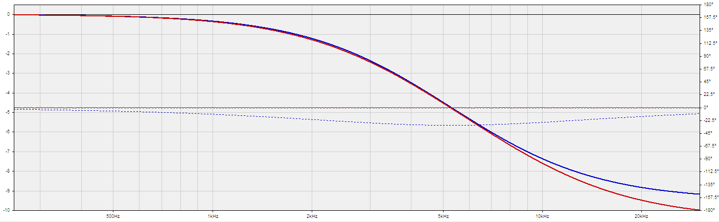

Regarding IIR de-emphasis, here are some biquad coefficients that can be used in place of the original ones for better accuracy :
Code:
dam1021,352800,8,30,5,1
Deemphasis IIR, 352.8 Khz Samplerate, hiself f=5600 Hz, Q=0.485, gain=-10.1 dB
0.331085040573029
-0.577213330670734
0.251294171647457
1.85212451656979
-0.857290398119544
dam1021,384000,8,30,5,1
Deemphasis IIR, 384 Khz Samplerate, hiself f=5600 Hz, Q=0.485, gain=-10.1 dB
0.329617410213504
-0.581107678819127
0.255876017438852
1.86372441280949
-0.868110161642715
Here is a comparison of Soren's original biquad (in blue) with the theoretical "perfect" de-emphasis amplitude formula (in red) as described here:

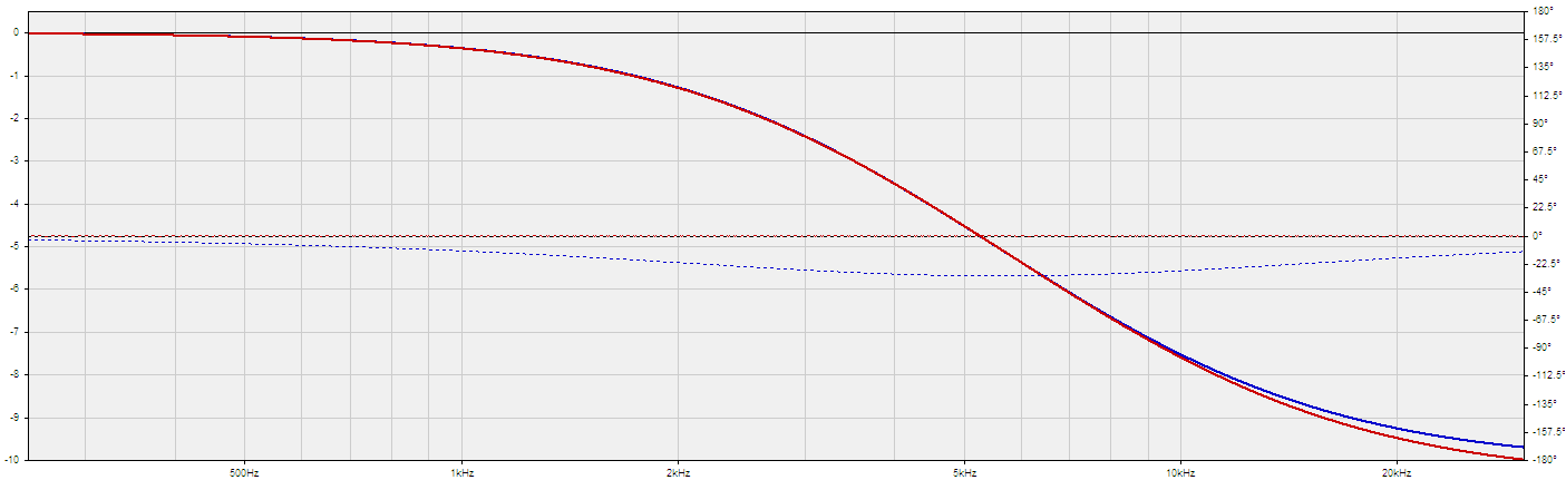

And now the proposed biquad (in blue), still compared to the theoretical formula (in red) :
attachment.php
This is as close as I could get with a single biquad.
That said, it looks like variations do exist among CDs on how emphasis was implemented...
Still I think it is a good thing to be as close as possible to the theoretical formula 🙄
