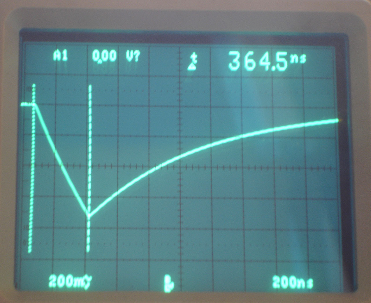

You can calculate the internal resistance from the measured data if you know the value of the capacitor....
And the 470 pF capacitor at the output of the R-2R resistor chain take care of anything coming though.
625 Ohm is what you get from the DAC ladder alone as resistance (I measured R=5000 Ohm for a R in the R 2R network) .
With 470pF the internal calculates as about 1600 Ohm, with 1200pF it drops but is still above the ladder-allone resistance.

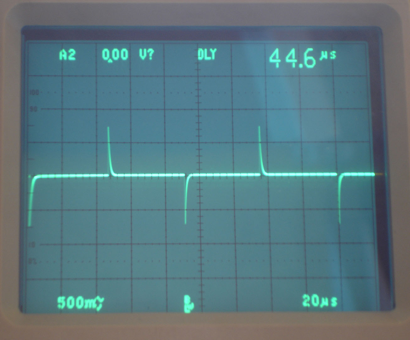

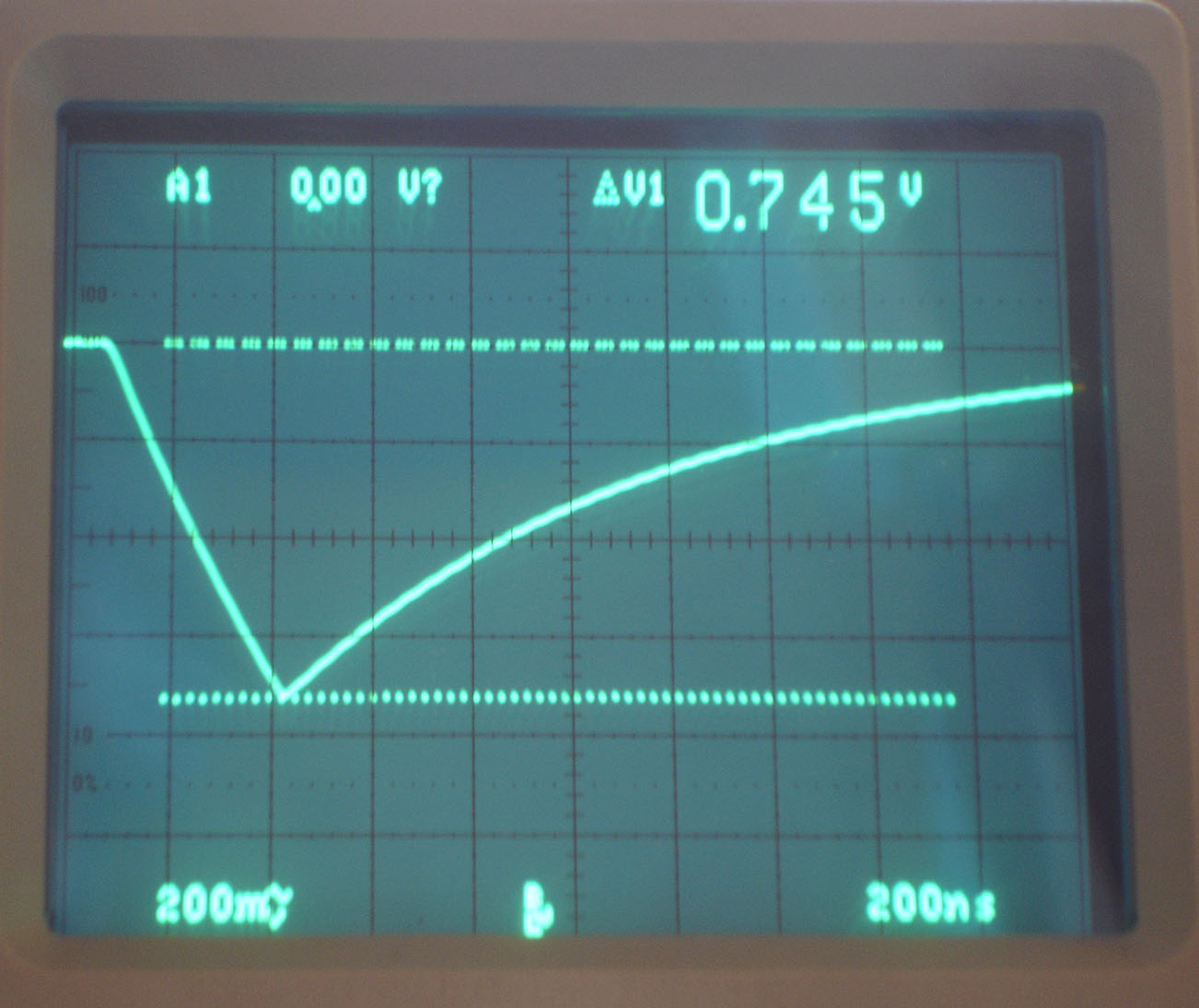

OK, instead of guessing, we also can calculate the value of the capacitor.
A value to relay on is the resistance of the DAC ladder, I get the 625 Ohm as well my measuring the whole thing as well as by calculation based on one resistor. Moreover that is the number given by Soren.
The capacitor is only discharged through the DAC ladder. The time for loosing half the Voltage is about 520ns. Using U(t)= U (1-exp(-t/(R C)) we get for roughtly C=580pF.
Taking in account the inaccuracies of the measurement this makes 470pF the more plausible value.
Using the above formula again with that C, t=1/(64*44,1kHz) rise time and U(t)=0.745V, U=2V, we get as internal resistance of the DAC as voltage source (=DAC Ladder+ internal resistance before the ladder) something about 1600Ohm.
