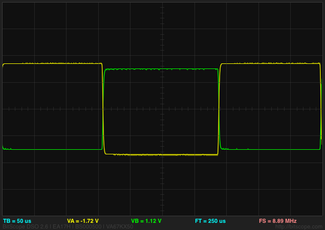

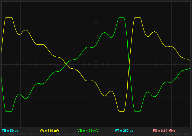

These are screen dumps from bitscope. FS output from SignalSuite, 3000hz sawtooth and square waves. This shows the default Soekris filters, and 44.1khz sampling rate.
You can see the clipped peaks to the waveforms. Sine wave is perfectly fine, so not shown.

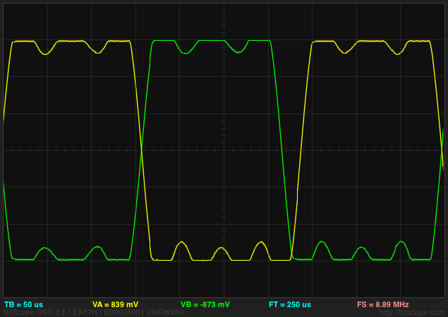

This is one of my filters with the gain dropped to x6 - square wave is still clipping at x7.
As I said I'm not 100% confident about the quality of the measurements, so if someone can verify or otherwise it would be appreciated.
The bitscope should handle 12V input but this seems to be clipping at 2V rms.

A correction to this.... The voltage was measured between median voltage and the rms voltage so the clipping is occurring at 4Vrms via the balanced outputs. This is slightly under 6V p-p.seems to be clipping at 2V rms.

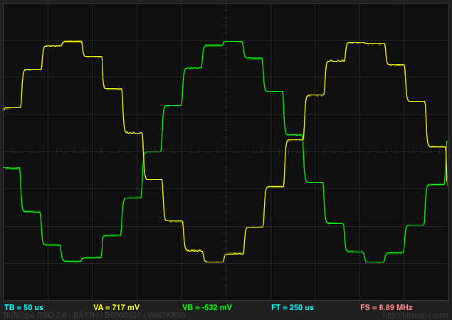

So this is interesting- the NOSfullbypass 1 doesn't clip when I manually adjust the volume up via the serial manager. I set it to +10 and it is fully usable.
YEs, this looks like there is some clipping, but I'm not sure if it is the Gibbs effect or genuine clipping.
This waveform though shows some interesting behaviour in the negative half of both waveforms - it crosses zero in a strange place in the middle yellow waveform and the ripple is flatter in the second half of both the yellow and green traces.

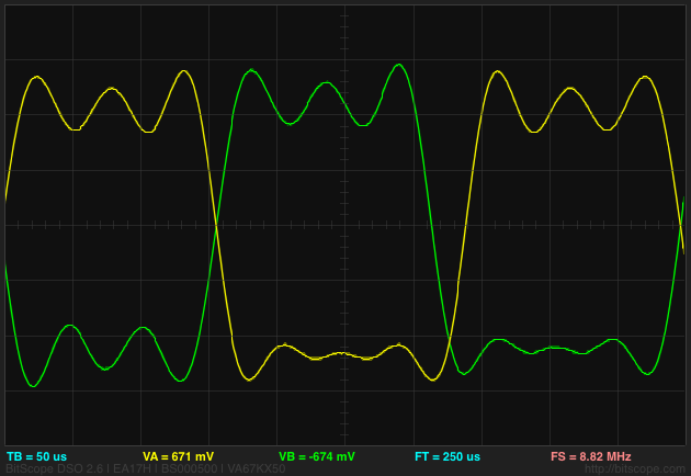

There is a very, very good reason I asked for someone to try to replicate on decent gear. Basically I don't have a high level of confidence in the bitscope. I've seen weird behaviour on the bitscope before it's proved to be a non-issue when checked with a "real" scope.
The tests I did seems to show the clipping occurring at rated RMS output for the balanced stage. Clipping disappears when either test signal is reduced or the digital volume is lowered. Again for the reasons stated above I'd like confirmation from someone with a decent scope before I get too excited about it.

Could you provide me wav of those signals? I can measure in oscilloscope or Tektronix am700. Or describe these signals so that I make with Audition.
Square wave clipping is third harmonic distorsión. I have seen different third harmonic distorsión in different filters.

But there is no real need for measurement, I think. The done measurements (of the worst case) shows that the signal looks as predicted by the theory (within the limits of my equipment), especiallay there is no hardware induced clipping and the only hardware effect is the final analog filter (so we can calculate shape of the output signal sample per sample if needed).
... That is if we assume there are no software impementaion faluts and that we stay in the computaional savety overhead of the "3-4 bits" with the intermediate signal levels.
In this case we do not even to simuate the output, but can simulate the filter in the digital domeain only, to decide if there is clipping.
This can perhaps be done with sox (I think) as you did.
Or "by hand", especially for simple test signals. Assume the clipping free signal level is -1 to 1.
