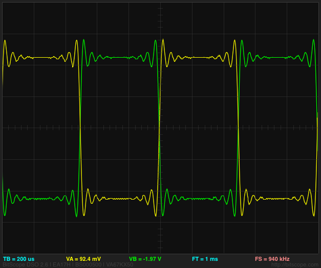

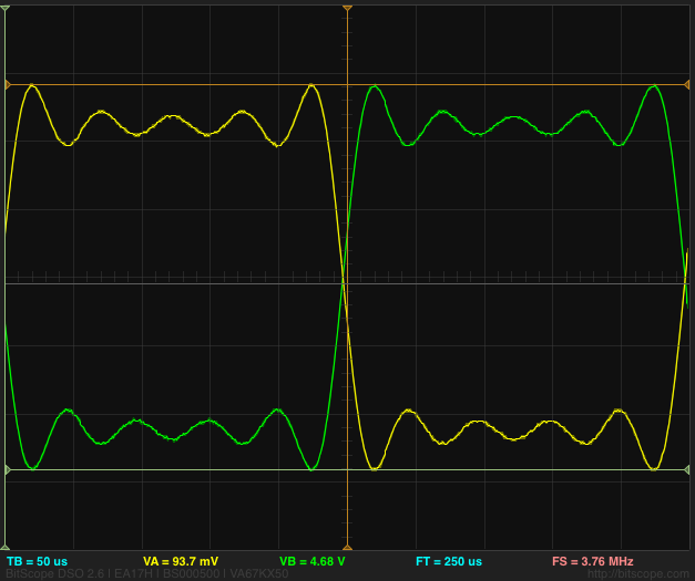

Using FIR1 with multiplier = x8 and FIR2 with multiplier = x6.833 and volume set to V+00 there is no clipping on the square wave inter-sample peaks. Increasing to V+01 results in clipping.
Add: I tested with FIR1 multiplier = 6.833 and FIR2 multiplier = 8 and this seems to have the same effect.
Add2: It also works if you split the attenuation between FIR1 and FIR2.
This seems to confirm that the filters are not clipping, and that adding "headroom" to the signal avoids clipping in the R2R ladder.
Signal Scope behaves far better at 2K btw. Zoomed out 1kHz wave form attached but doesn't add much to the discussion.

I thought I should check that the same clipping//not clipping behaviour occurs using unbuffered outs - it does.

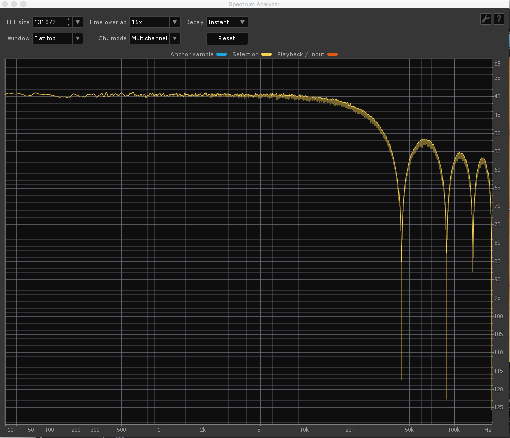

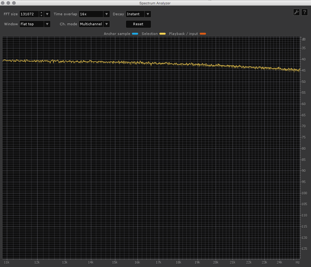

The "correct" NOS is rolled off in the HF.
The two images attached are of the NOS filter co-efficents applied to gaussian white noise file. Because the white noise has a flat spectrum this allows you to determine the response of the filter. Treat -40dB as 0dB. The NoS filter is -1dB at 14kHz, and -3dB at 20kHz. As Eldam and others pointed out the totalDAC uses a FIR filter to correct for this roll-off so isn't a 100% pure NOS DAC.
In contrast the first totalCRaP filter is pretty well flat out to 19kHz, so will have more HF energy above 12-13kHz. So it's not really forward, just not rolled off.
The 3.5dB headroom will potentially reduce harshness with near full-scale signals if you are using an OS filter, and fixed 0dB output.
