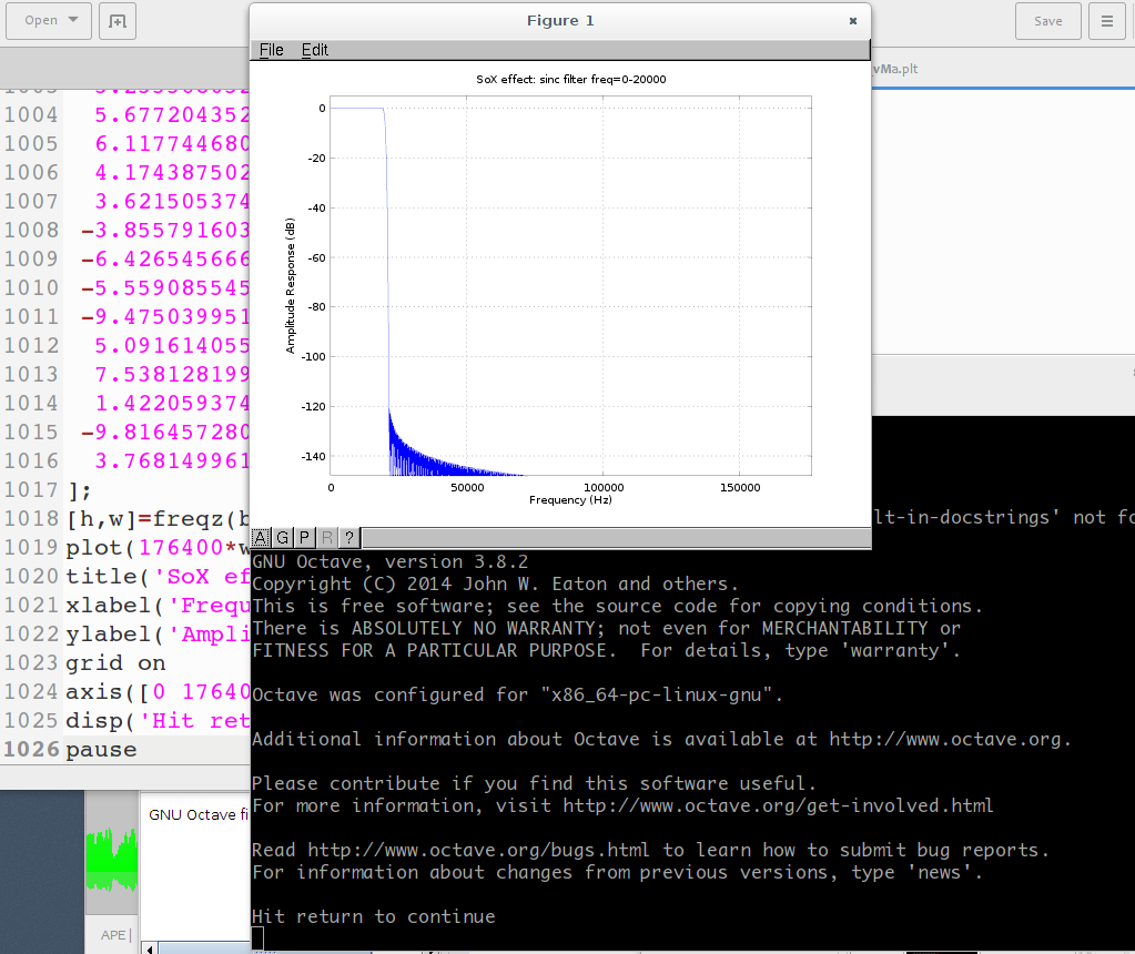

sox --plot octave /path/to/input.wav /path/to/output.wav sinc -20k -I -n 1016 > plot.plt
Holy CRaP™!! the output plot file contained 1016 filter coefficients!
The sampling rate is based on the input.wav, so you need short (1 second is enough) files with 358.2k and 384k sampling rates for FIR1.

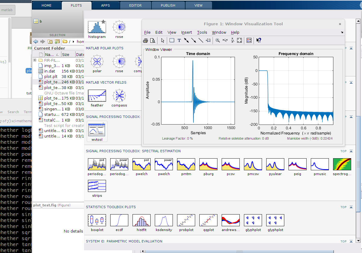

That's really convenient!
Code:

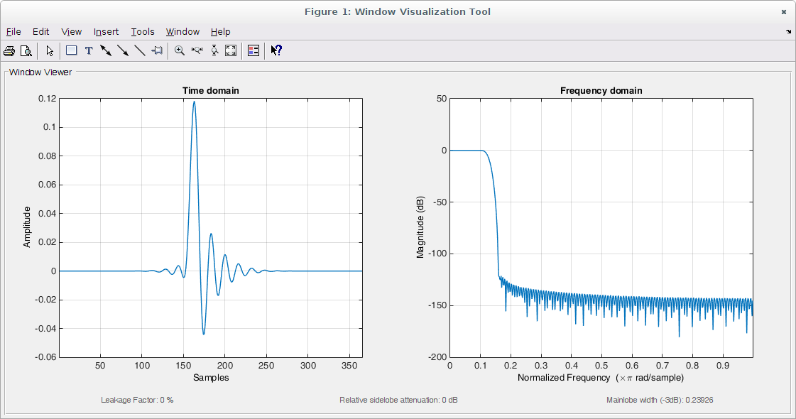

sox --plot octave -v0.965 --buffer 32768 -r44100 test.wav -r352800 soxup-vMa.wav rate -vMa sinc -20k -I -n 1016 > plot.plt
Import it into matlab and so easily preview the figures with plot toolkit. But why the "b" is 1581 instead of 1016?

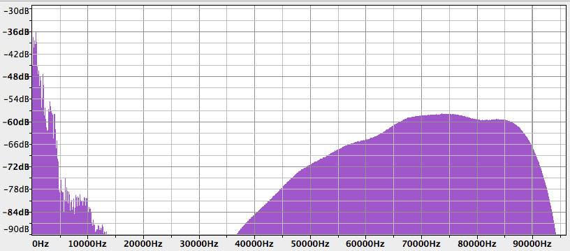

In my opinion the passband for the higher sampling rate (88,96 and up) FIR1 filters should also only be something up to 20kHz while the stopband can be at higher frequencies than for the 44/48 case. At least I would wish such a filter set as option.
I think the main benefit of the higher sampling rates is that it makes live easier for building nice filters (as well for recording as for playback). All of my high sample rate recordings, I have looked at, have no content above -90dB from 18kHz, or at most 22kHz, on upwards.
... unless they are (or seem to be) converted DSD recordings which have a (noise) signal reaching higher levels above 35kHz again:
As they say "you can prove anything with statistics" Lies, damned lies, and statistics - Wikipedia, the free encyclopedia
Averaged response is great for finding underlying long term behaviours but useless for showing short term peaks in energy.

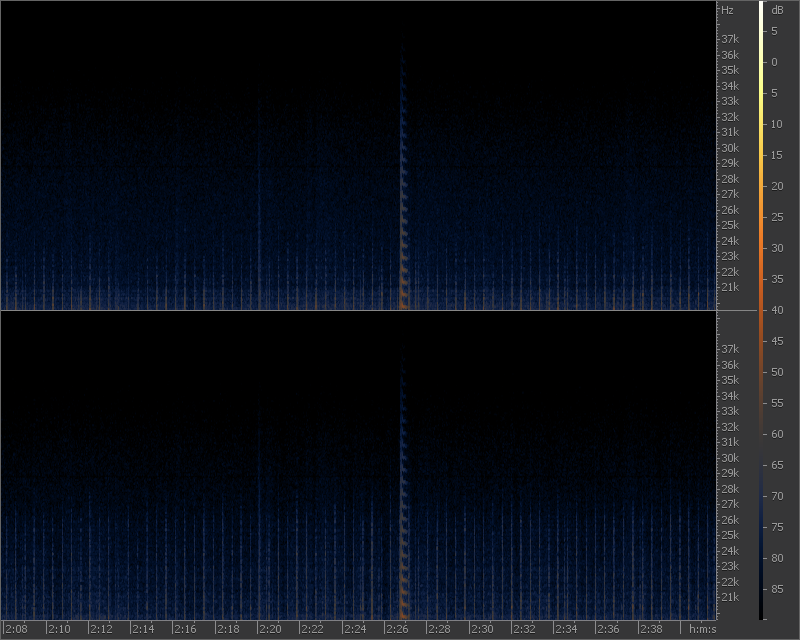

This is a spectrogram of a short segment of the HD Tracks 192/24 release of Miles Davis' So What.
attachment.php
I've configured so that the lowest energy value displayed is -90dB. FFT size 4096 and uses a Hann window. You can see the trumpet note - which is loud - has harmonics above -90dB out to
35kHz. There are harmonics on the same note which are above -65dB out to 28kHz, and above -55dB out to 23kHz.
While it might be the case that this is above the range of hearing of most people, I'd be loathe to filter detail from a recording because there is at least the possibility it may influence perception of the audio.

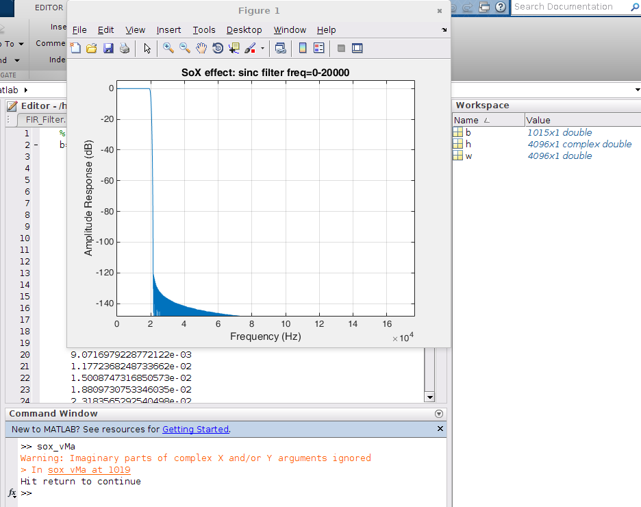

Got it! Few parameters changed but taps got 1017 with "-n 1016".
abbreviated:
sox --plot octave -r44100 test.wav -b 24 -r352800 soxup-vMa.wav rate -vMa sinc -20000 -M -n 1015 > sox_vMa.plt
ok. 1015 taps as type.

I do not advocate for a brickwall at (say) 20kHZ. All I wanted to say, for higher sample rates, the design should not aim to be perfect reproduction up next to Nyqvist. I would treat some more ripple or attenuation above 20kHz for better behavior below 20kHz.
To put things in perspective: I turned my pre amp -80dB further when I powered the DAM off and so avoided hearing its devastating power-off spzzzzkt 😉 in my speakers.

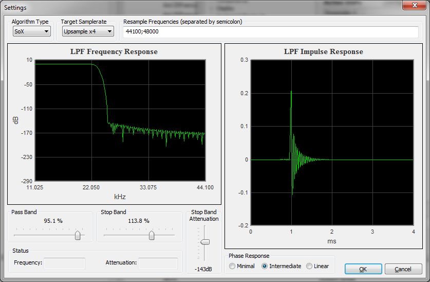

Resampler-V DSP plugin for Foobar
I just found a very nice tool: Resampler-V DSP plugin for Foobar
It's a resampling/upsampling plugin for foobar with a very good interface.
It uses the SoX and SSRC library.
You can change the pass band, stop band, attenuation, phase and see the result in the graphs.
By adjusting the sliders you see live changing the graphs, very nice 🙂
To get to the GUI: Preferences, Playback, DSP manager, configure selected.

Thanks for these functional parameters, that's the way to get the compromise between phase, delay, aliasing and ringing, eg. 'rate -M sinc -p30 -22050 -t12k' .
