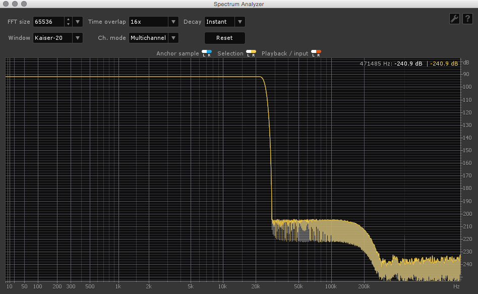

You need to measure relative to the passband, so FIR2 is providing at most 85dB attenuation of images reflecting around 352800Hz FS.

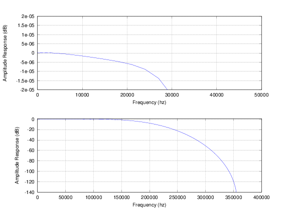

This is made with a very slow roll-off filter that is -0.00002dB at 30kHz, and -140dB around 352kHz. (384kHz Fs)
attachment.php
The idea is that FIR1 takes care of imaging for initial x8 so there shouldn't be any significant content over 30kHz. This means in the worst case mirrored audio will not extend below 384-30 = 354kHz. If FIR2 reaches maximum attenuation prior to 354kHz there should be little mirrored content.
I've attached Minimum and Linear Phase versions of the filter coefficients. Intermediate phase blows out the tap count so isn't feasible when you only have 95 taps available.

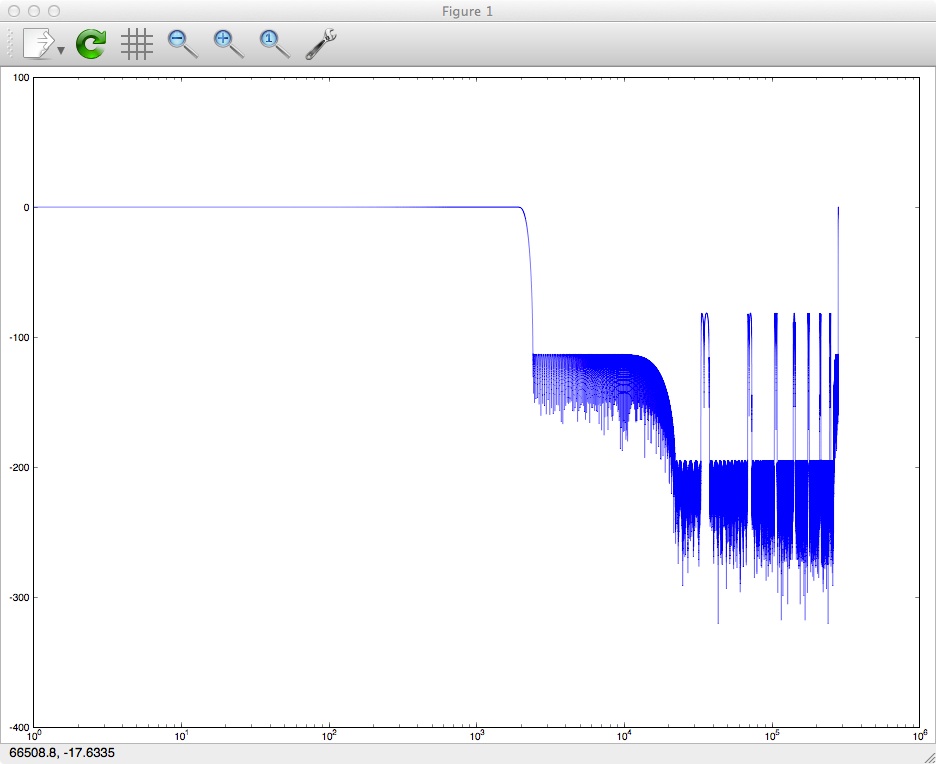

Nice find indeed. But it seems you apply the filters to some noise to produce the graphs???
The frequency response of a filter is its fft.
upsample(8) FIR1 upsample(8) FIR2 is the same as
upsample(64) FIR3, with FIR3 the filter you obtain by convoluting the upsampled FIR1 by FIR2. So we only need the fft of FIR3.
I made a little Octave code to demonstrate that, you see the graph is the same.
(I am not familiar with Octave, you surely can format the plot nicer).

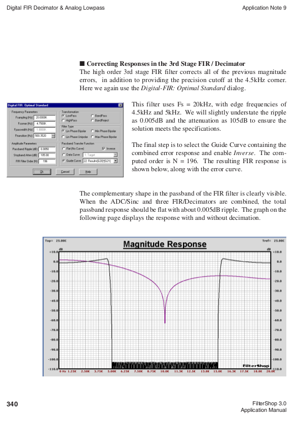

Is there the way to add anti-sin(x)/x to compensate 'pass-band frequency response dropping' as SAA7220/B+TDA1541A did earlier, and people can then use slightly ease the digital or analog filter? For manual of sox I did't find any relevant wordings.
Sorry for my dead end question. Got some info from FilterShop's app manaul.
p15 & p16:

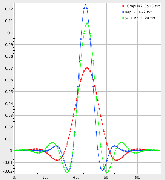

Attached is a comparison of the impulses of the TotalCrapRev2, LP FIR2 posted a couple of days ago and the SK factory filter.
attachment.php
The TotalCrapRev2 has less rejection than the factory filter, so suffers from the same imaging issues. You can see that the base of the TCr2 impulse is wider than stock so this may contribute to time smearing.
The stock FIR2 has the greatest amount of pre/post ringing.
LP Fir2 has the narrowest impulse and least pre/post ringing of the three. I suspect this contributes to the improved focus that has been reported.

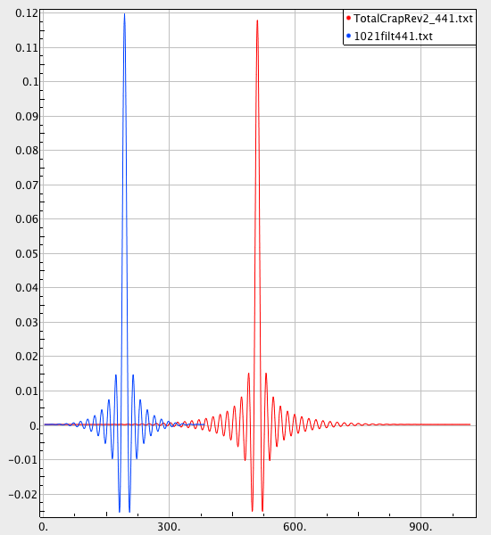

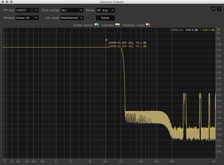

44.1kHz filters...
attachment.php
TotalCrapRev2 44.1 filter is as advertised and features lots of pre/post ringing.
Stock filter has a fair bit of ringing but is short....
attachment.php

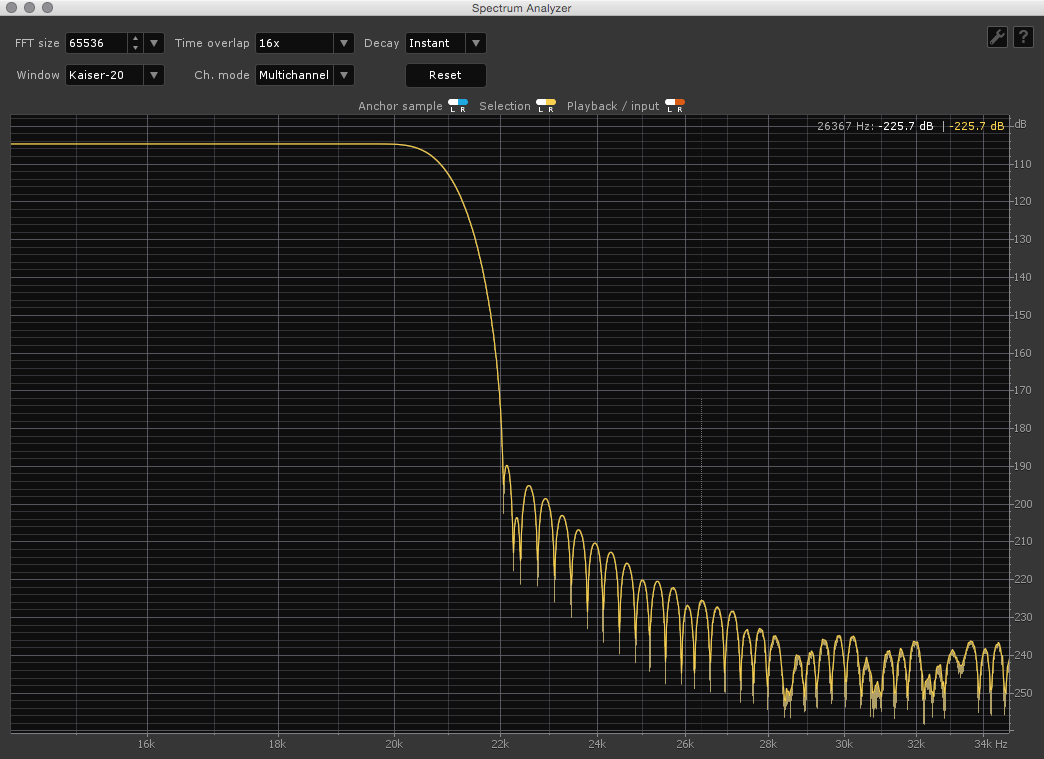

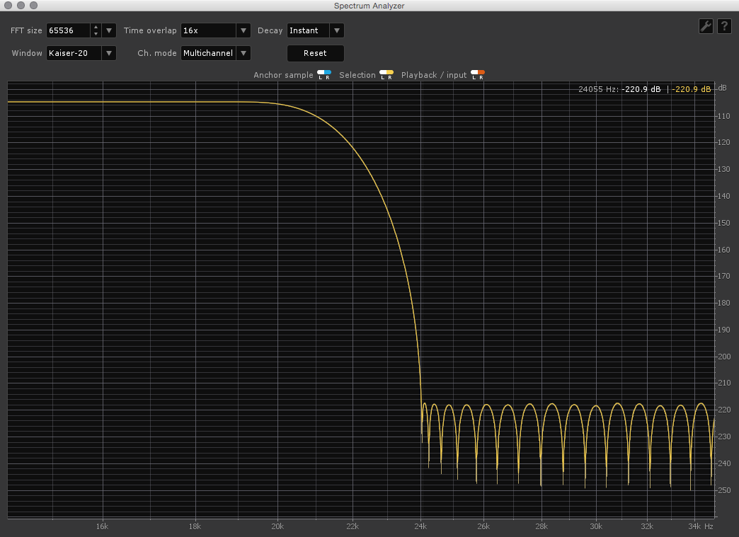

The stock filter isn't really as steep as people seem to assume. It is around -17dB down at 22kHz, and doesn't fully attenuate until 24kHz.
attachment.php
Total Crap rev2 44.1 is far steeper and is rolled off to -85dB at 22.05kHz although response continues to drop in the stop band. Although attenuation appears worse than stock, this is only true between 24 and 25kHz.
