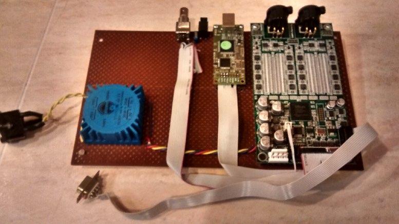

Hello B&W_arthur.
In my opinion is nonsense modded DAM1021 psu. It was the first thing I measured. I was thinking to improve it.
The psu is perfect with a 7v. transformer. The DAM1021 is very good power supply. And you will not get any improvement in this case with modded psu.
I have measured two DAM1021, is no defective board. ((Or I have two equally bad board).

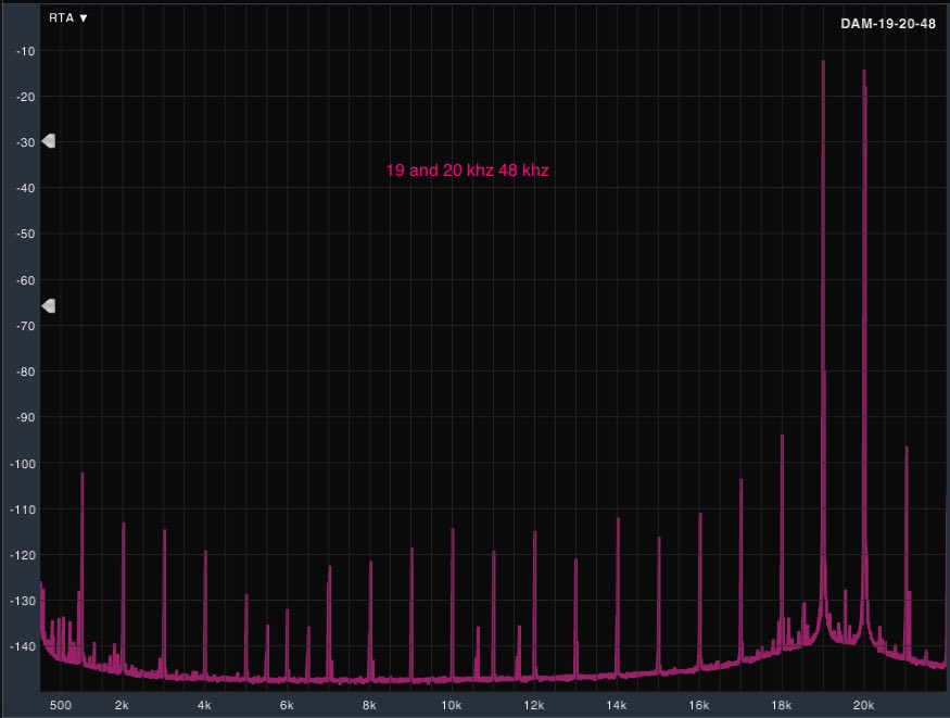

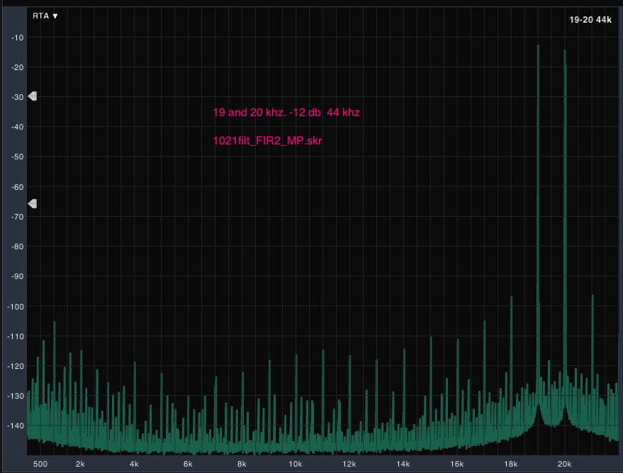

I measured with Mac Book Pro, Motu Ultralite MKIII card and Smaart software.
I have other DACs in which these problems do not appear this guarantee me that is no problem of measuring equipment. And I have another device Tektronix AM700 in which the measure is the same. I prefer using Smaart because it allows me to compare and save the measurements.
To correctly measure I must power on the DAC and Motu several hours before. Especially for measuring jitter.
After seeing these measures I am less concerned.
MSB Technology Platinum Data CD IV transport & Diamond DAC IV & D/A converter Measurements | Stereophile.com
The strange thing is that multiples of 48k. are very perfect. It is more important to put phase and impulse filters response measurements at the output. Is more interesting for quality sound.

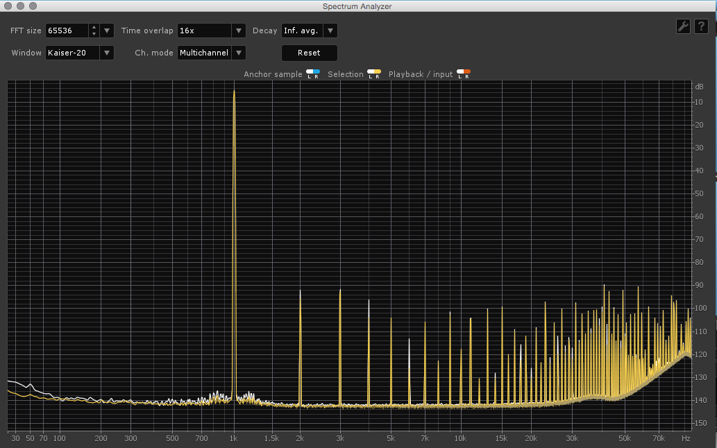

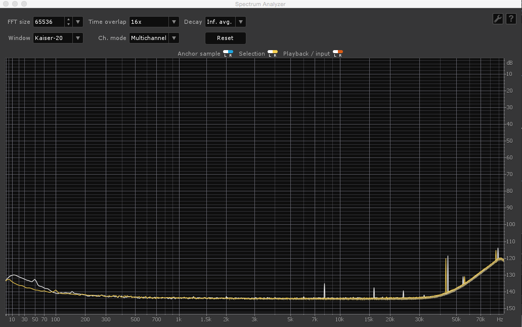

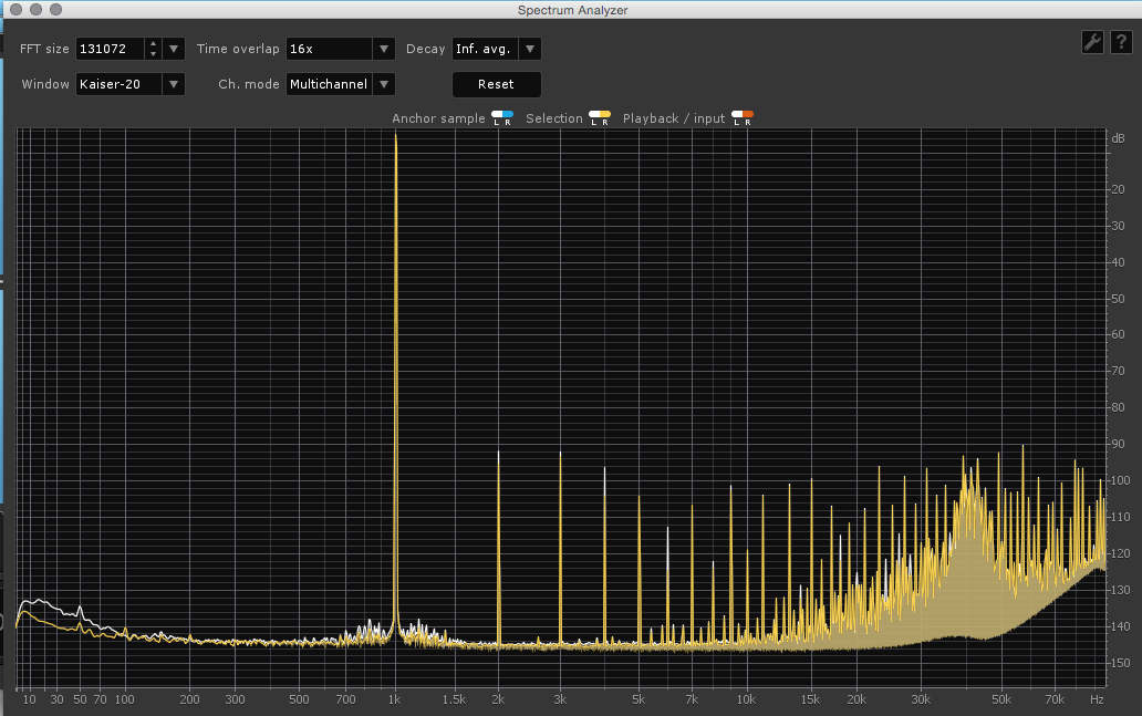

I've attached 3 screenshots of Isotope RX.
First is the DAM playing silence from an undithered 16/44.1kHz file.
Next 1kHz tone at 44.1kHz
Last 1 kHz tone at 48kKz
This is all done Macbook Pro -> USB -> Amanero -> TC Electronics Konnet 8 (with Welborne Labs Linear PSU) -> RX (on MbP).
The silence was at full volume - there is full scale test tone at the start that was clipping.
The SignalSuite tones were set at Master Volume 100%, Amplitude 80% which gives -0.5dB meter reading. If I go any higher the inputs start to clip.
The low level peaks on each side of the main tone are jitter artifacts imo and are at worst -136dB below the main tone. Also note the 50Hz mains tone at -134dB - this is with a directly hooked up 7VA trafo.

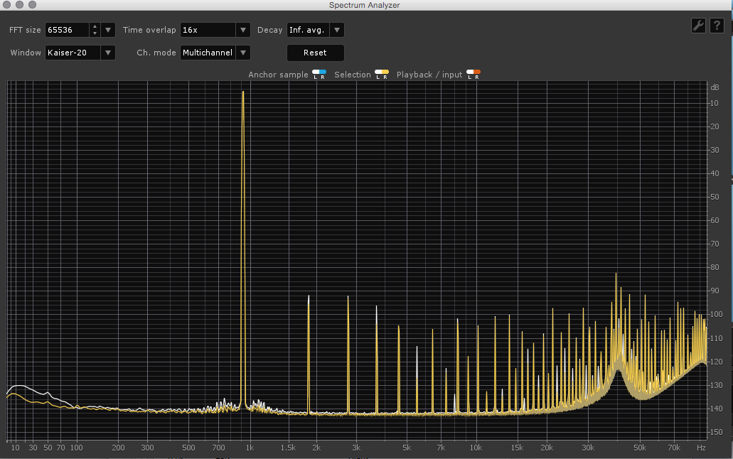

I know what is going on!
1000hz is the same frequency, but they are different multiples of the sampling rate.
1000/44100 = 0.022667
1000/48000 = 0.020833
To test at 48k with the same test tone/sampling rate ratio you need to
(1000/44100)*48000 = 1088.4353741496hz
or alternatively
(1000/48000)*44100 = 918.749999999853hz (918.745hz is close enough)
Attached is results at 44.1kHz and test tone at 918.745hz. If you test at 48kHz 1088.43 the results look close to those for 1k/44.1khz.
So the difference is largely down to the different relationships between test tone and sampling rate.
I agree that the tone/sampling rate ratio (e.g. the number of samples of one period of the tone is one important thing to conserve.
Why? I think because of that:
The graphs look to a great part like what you see as the aliases of the harmonics in the textbooks (you get harmonics if your periodic signal is not perfectly sine, whatever in your chain may be responsible for that).
These harmonics are mapped modulo fs in the 0-fs/2 range.
As (n-abs(i*f mod(2n) -n), n=fs/2, to be precise. So you "see" more harmonics the smaller the greatest common divisor of v and fs is.
The fewest harmonics aliases you see if tone/sampling rate ratio an small integer.
That is why 1kHz with fs=48kHz looks " cleaner than (only maximal 24 aliases)
than 1kHz with fs=44.1kHz (tons of aliases).
Of cause usually the higher harmonics get week and so may not play a role.
