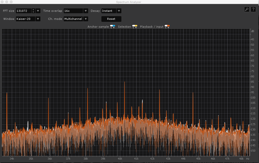

But the RME runs from morning to evening and surely was hot. The measurements were made "one after the other" so under similar conditions. The DAM and AD1955 got their digital signal over SPDIF-coax from the RME. The RME measurement was an analog loopback.

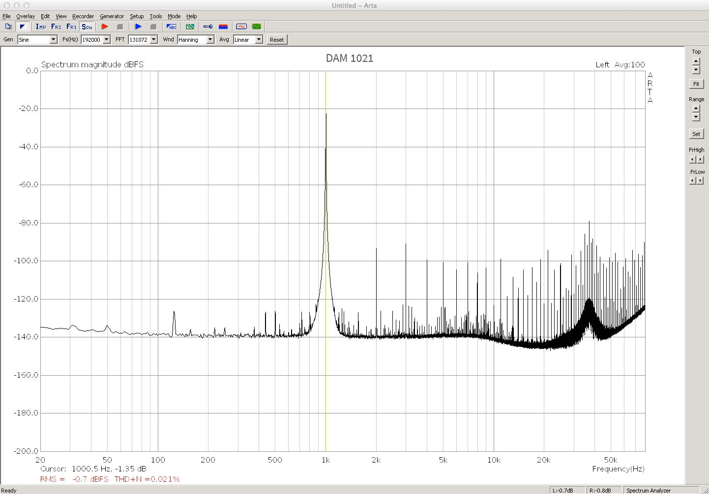

It's definitely a signal related artefact from the DAM. It seems to peak at 41kHz regardless of sampling rate selected on the DAC or ADC. I wonder if it's a multiple of the FPGA clock.
My comment re the 1 tap filter was a bit daft (and I've since deleted). We discussed this before and the output of a single tap filter at x8 is very low (thnx zfe). Adding taps increased the "hump" so it's not likely this was actually doing anything useful, except confirming that the issue is correlated to signal level.
I had also meassured fs=192 kHz, and yes it also shows the peak is at the same location. But I would locate its peak more around 35kHz than 41 kHz.

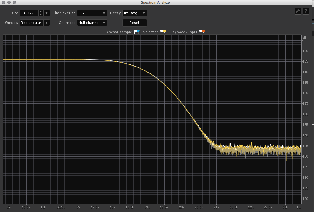

DTYWS starts to roll-off at just under 16kHz, is down a comparatively restrained 22dB at 20kHz, is -130dB at 22kHz and bottoms out at -180dB at 22.4kHz.
Who cares if the young'ns think it sounds bad. 😉
FWIW the passband response graph extents are +/-0.00001dB so don't be too alarmed at the precipitous drop in response.
This was at 48khz with 1088kHz test tone. Looks like 41kHz to me 🙂
The DTYWS filter isn't really all that bad. It's only -0.02dB at 17kHz, then -0.8dB at 18kHz, -6dB at 19kHz, and -21.5dB at 20kHz.
While it is starting to roll off at 16kHz it's only fractions of a dB, and the serious roll-off doesn't begin until 17kHz.
It's not nearly as dull sounding as the AyreListen filter which was rolling off at 10kHz or something crazy.

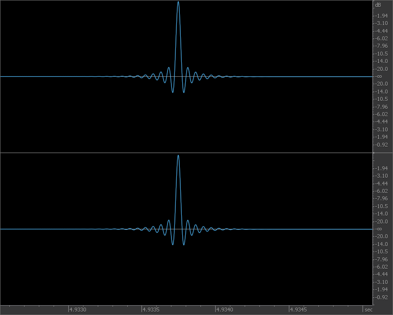

OK. Impulse of the filter from post:
Impulse of the filter measured at DAC outputs.
Surprise, surprise, the DAM measures pretty much like the filter, just like Søren said it would.
Response from the impulse....
Ignore the absolute levels - the impulse is one sample long so doesn't have a huge amount of energy and measures low, however I believe the response curve is accurate.
So who would of guessed. 😉 It starts rolling-off at around 17kHz, is around 1dB down at 18kHz, -22dB at 20kHz. Hmmmm... do those figures sound oddly familiar!?!??
The other "take home message" here is that the noise floor swamps the filter response below -145dB, in my test setup at least. I suspect that only reason for chasing stop band attenuation much below 150dB is to reduce passband ripple.
