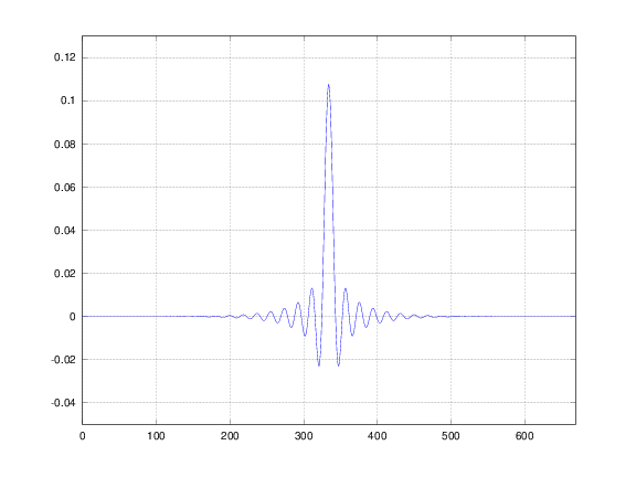

OK. Impulse of the filter from post:
Impulse of the filter measured at DAC outputs.

Surprise, surprise, the DAM measures pretty much like the filter, just like Søren said it would.
Response from the impulse....
attachment.php
Ignore the absolute levels - the impulse is one sample long so doesn't have a huge amount of energy and measures low, however I believe the response curve is accurate.
So who would of guessed. 😉 It starts rolling-off at around 17kHz, is around 1dB down at 18kHz, -22dB at 20kHz. Hmmmm... do those figures sound oddly familiar!?!??
The other "take home message" here is that the noise floor swamps the filter response below -145dB, in my test setup at least. I suspect that only reason for chasing stop band attenuation much below 150dB is to reduce passband ripple.

oneclock – thank you for posting you phasing measurement. One thing not clear to me. Does it have any meaning where on the timeline the impulse peak are? I understand its usually less desirable with pre-ringing than post. But I’m unsure if the placement of the peak in your measurement are something we can read something from?
