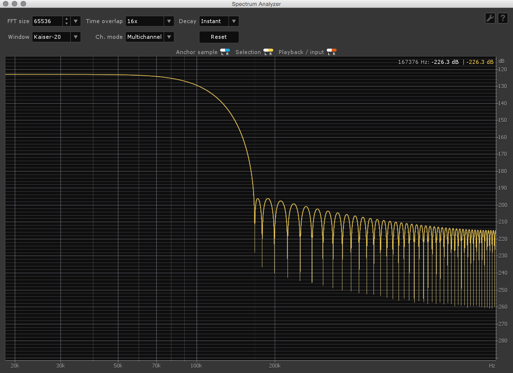

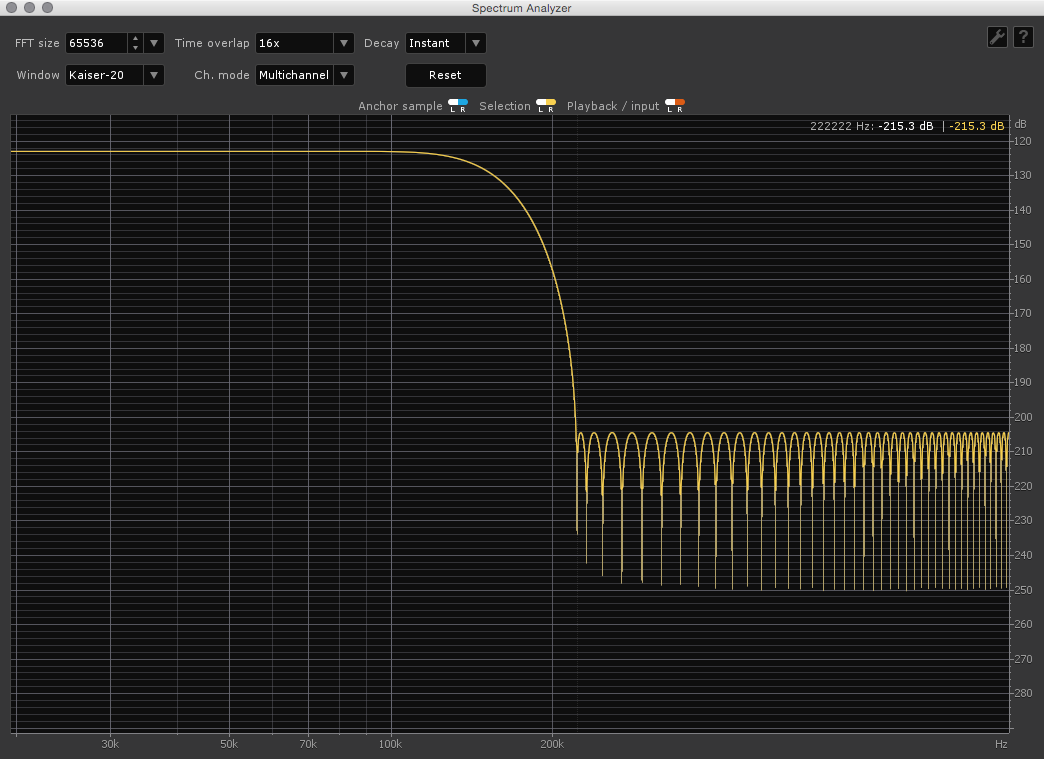

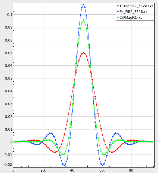

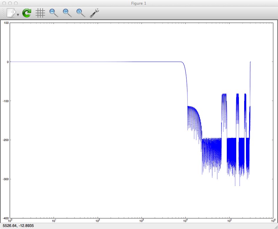

TCr2 filter is down a couple of dB at 70kHz whereas stock is flat to 100kHz.
LP_FIR2 is a different approach altogether. It's aimed at minimising ringing and ripple so stopband starts far higher than the other two, and attenuation is around -140dB vs -85-90dB for the other two.

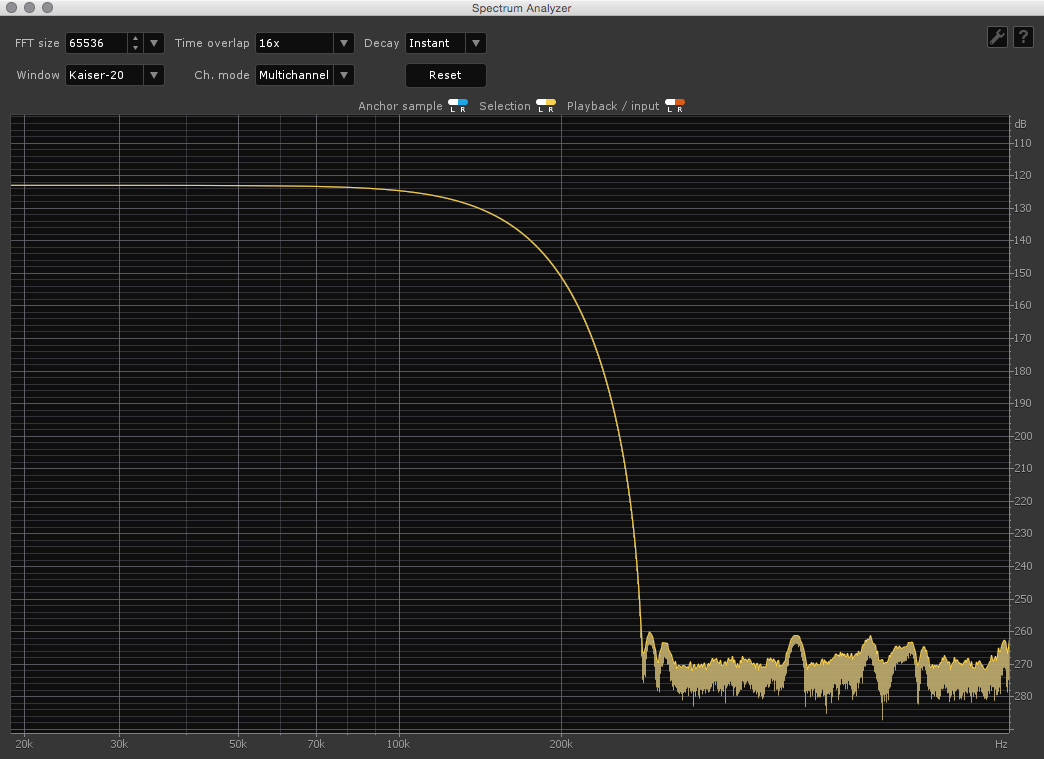

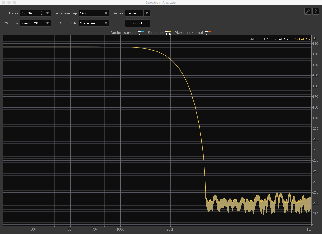

CRaP Magic
For completeness...
attachment.php
attachment.php
The CRaPMagic FIR2 is a similar thing to the LP filter posted a couple of days ago. However it rolls off earlier and stop band starts at around 280kHz instead of 330kHz.

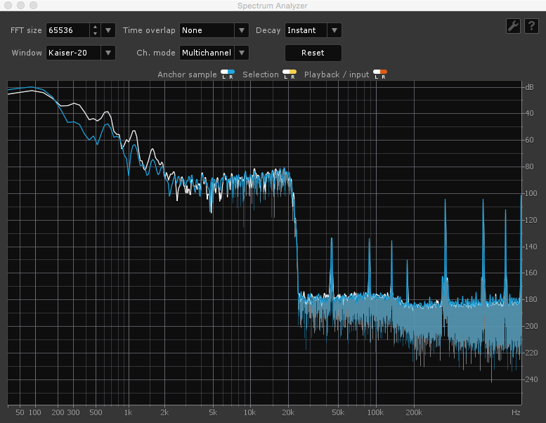

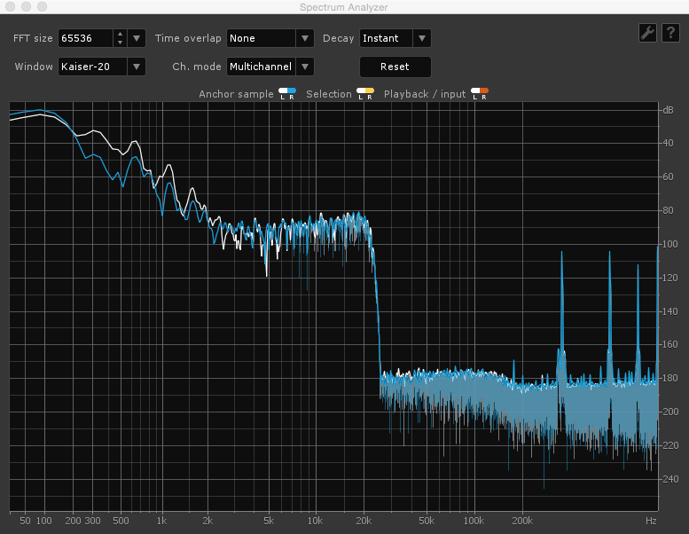

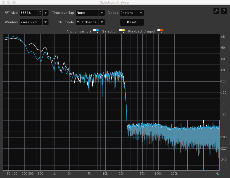

The higher fs filters combined with FIR2 also have the mirror frequencies coming through
here 96kHz with stock FIR2 (reaching about -80 dB)
With mpF2_MP (and LP) the image looks alike but with harmless -170 dB peak over -300 dB floor.
The higher fs filters combined with FIR2 also have the mirror frequencies coming through.
I hadn't investigated the higher fs filters, so thanks for that.

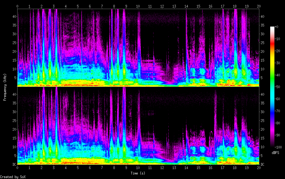

What I'd been having a look at is SoX upsampling with various combinations on audio...
The following are all taken at 20.208 seconds from the start of So What.
Default FIR1 and FIR2
attachment.php
CRaPMagic 44.1 FIR1 and Default FIR2
attachment.php
CRaPMagic FIR1 and FIR2
attachment.php

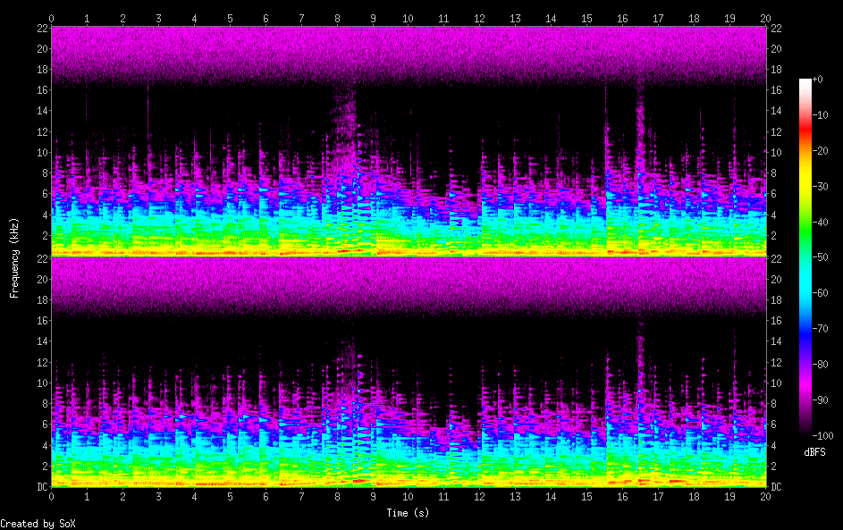

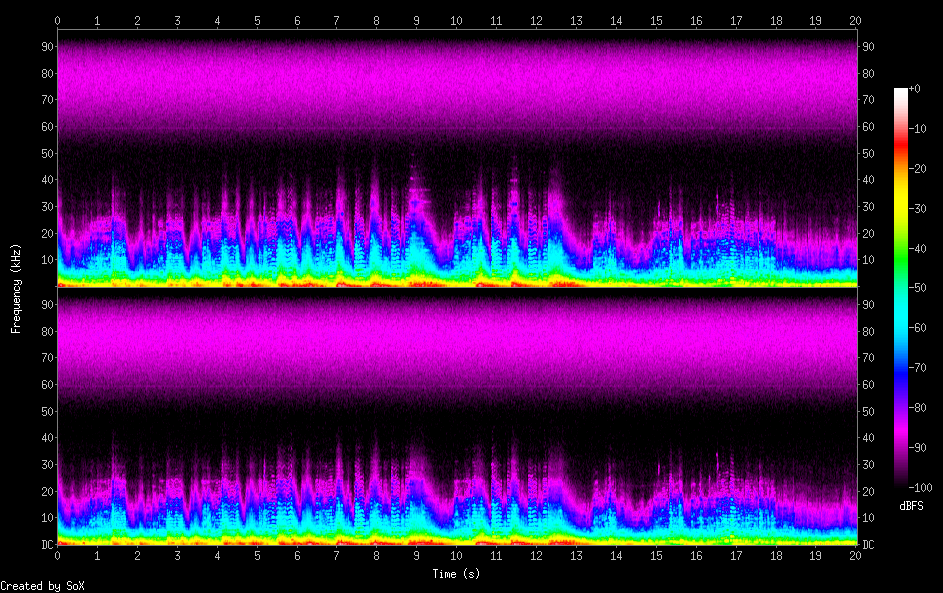

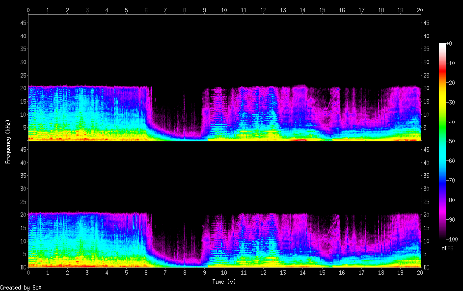

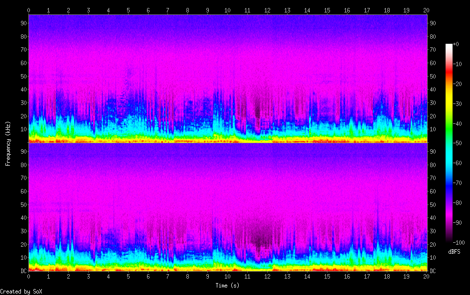

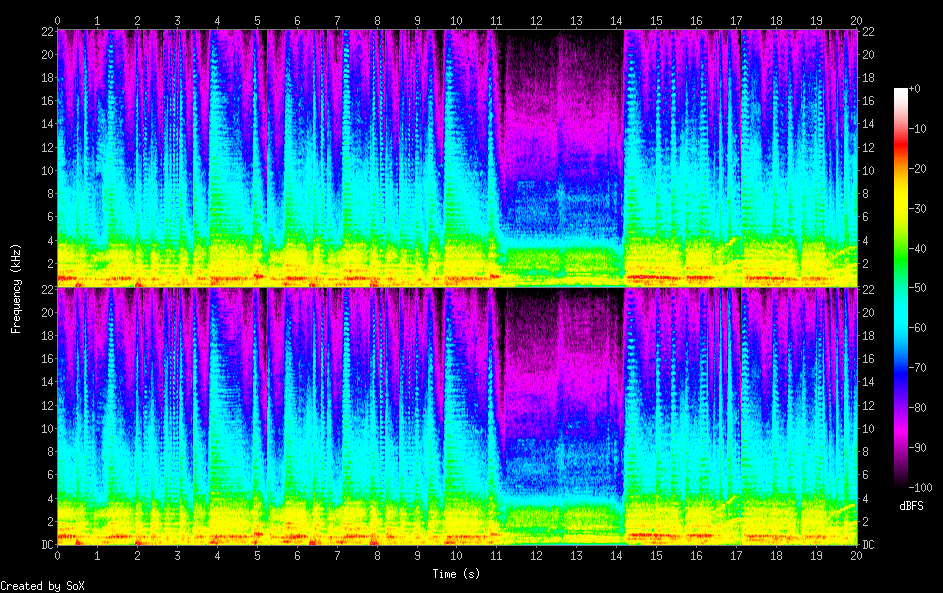

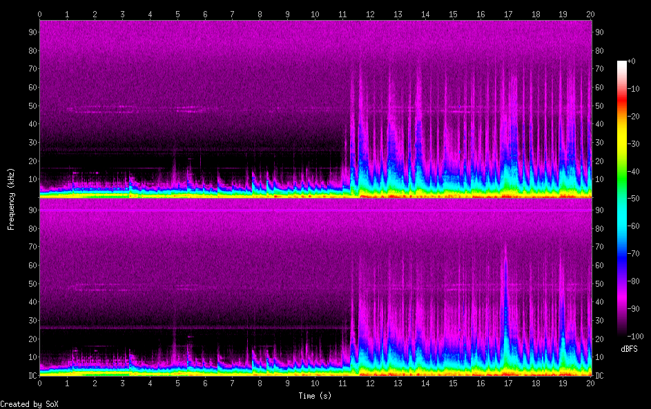

I made spectrograms from my HD recordings and found several "types" which perhaps would benefit from different types of filters. @ Soren, It would be nice if a later firmware would allow easy filter switching. If possible filter switching during playback and without serial connection, e.g. by giving the input select pins a (optional) new functionality would be nice.
Back to the spectrograms, in order as they appear below:
1. "only audio band type", only content below 22kHz.
(example from: Bizzarrie Armonichoniche; Biber Rosenkranz Sonaten; Label ARTS)
2. "DSD type", considerable noise in the high frequencies content below say 22kHz.
(example from: Florilegium; Pergolesi Stabat Mater; Channel Classics)
3. HF content and incresing noise to the HF end
(example from: Dunedin Consort; Bach Mass in B Minor; Linn Records)
4. moderate HF content below say 35kHZ (with fs 192kHz)
(example from: Henkel; Tchaikovsky Concerto for Violin and Orchestra D major Op. 35; Altana)
5. HF up to the limit, calling for HF-CRAP
(example from: Dunford; Dowland Lachrimae; Alpha)
Also for 44.1-material at least two filters would be good
6. Content up to the Limit, calling for CRAP
(example from: PHILIPPE JORDAN; Verdi Requiem; Erato)
7. Content staying clean away from the frequency limit.
(example from: Pierre-Laurent Aimard; Bach The Art of Fuge; Deutsche Grammophon)
To conclude, I admit 1.) on the HD recordings are not always the interpretations you want to listen to, and I will (also) continue to listen CDs/LPs.
2.) I not always hear what I see on the spectrograms.

It be interesting to extract all the purple, amplify, do pitch shift down and hear how much musical information there is. Are you able to share what file we are seeing here?
Its this recoding, 24/88.2, from the second trac:
John Dowland : Lachrimæ (Pièces pour luth & airs) | John Dowland par Thomas Dunford
I bought it at the time from Linnrecords, but they do not list it anymore. I assume the HD track you get from the above link is the same.
P.S. if you are intrested in such things, here something with even higher "content" up to 70 kHz
http://www.linnrecords.com/recording-ludwig-van-beethoven--piano-concertos-3-4-5.aspx
Spectrogram in the next post
