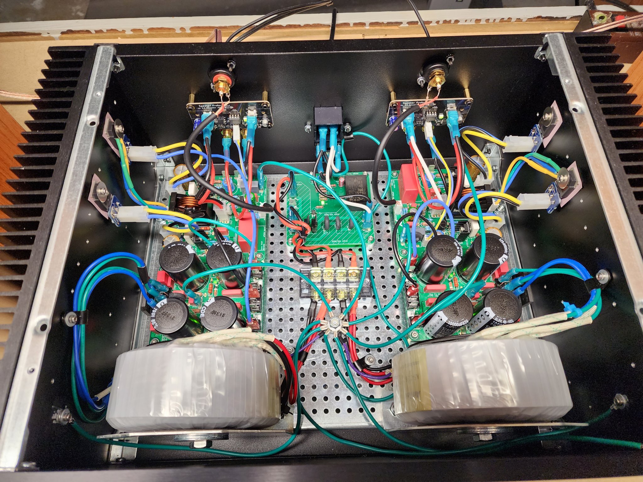

Hello Forum Members,
I thought I would offer my experience building the FH9HVX using XRK Audio boards.
I built this amp one year ago and absolutely love it. I think it sounds better than any commercial amp I have ever purchased.
I hope at some point to build a compact, lower-power version that I can use with bookshelf speakers. This is in anticipation of moving to an apartment where a low-power version would be more appropriate.
If anyone is considering building this amp, I would encourage them to do so. It's an awesome project. Also, I had great success using the anplifier boards and PSU boards I purchased from XRK Audio. Happy Building!
P.S. Please excuse the "rats nest" wiring, it was my first project.

@UncleMud
Your Amp looks fine, ok...the wiring is ok in my opinion. If the amp works fine and the sound is very good, let it remain as it is...
Fine to hear a opinion about the XRK pcbs from a member. I only saw pictures in the past. I need space at home... 🙄

My FH9HVX output stage is biased at 250mA, so about P = [(2*0.25)^2]*8 = 2 watts peak Class A in 8 ohms or 1 watt peak Class A in 4 ohms before transitioning to Class B.
Class A peak for a push pull/complementary output stage is calculated as: [(2*bias in amps)^2]*load impedance.
Reading post #56 by @chermann, did you have the vertical mosfet version of this design (i.e. FH9XXX) biased at 750mA? No issues with thermal runaway? 0.75A bias will give you 18 watts peak Class A/8 ohms or 9 watts peak Class A/4 ohms before transitioning to Class B. Your voltage rails are only +/-31V. How warm were your heatsinks? Your dissipation would be 62V*0.75A = 46.5 watts. I am considering increasing my bias until my heatsinks reach about 50 degrees C. If I do, I might consider adding a cap bank immediately before connecting to the voltage rails on the main board since increased bias current puts a bigger load on the power supply - although I do have a fair amount of capacitance already.
Best,
Anand.
