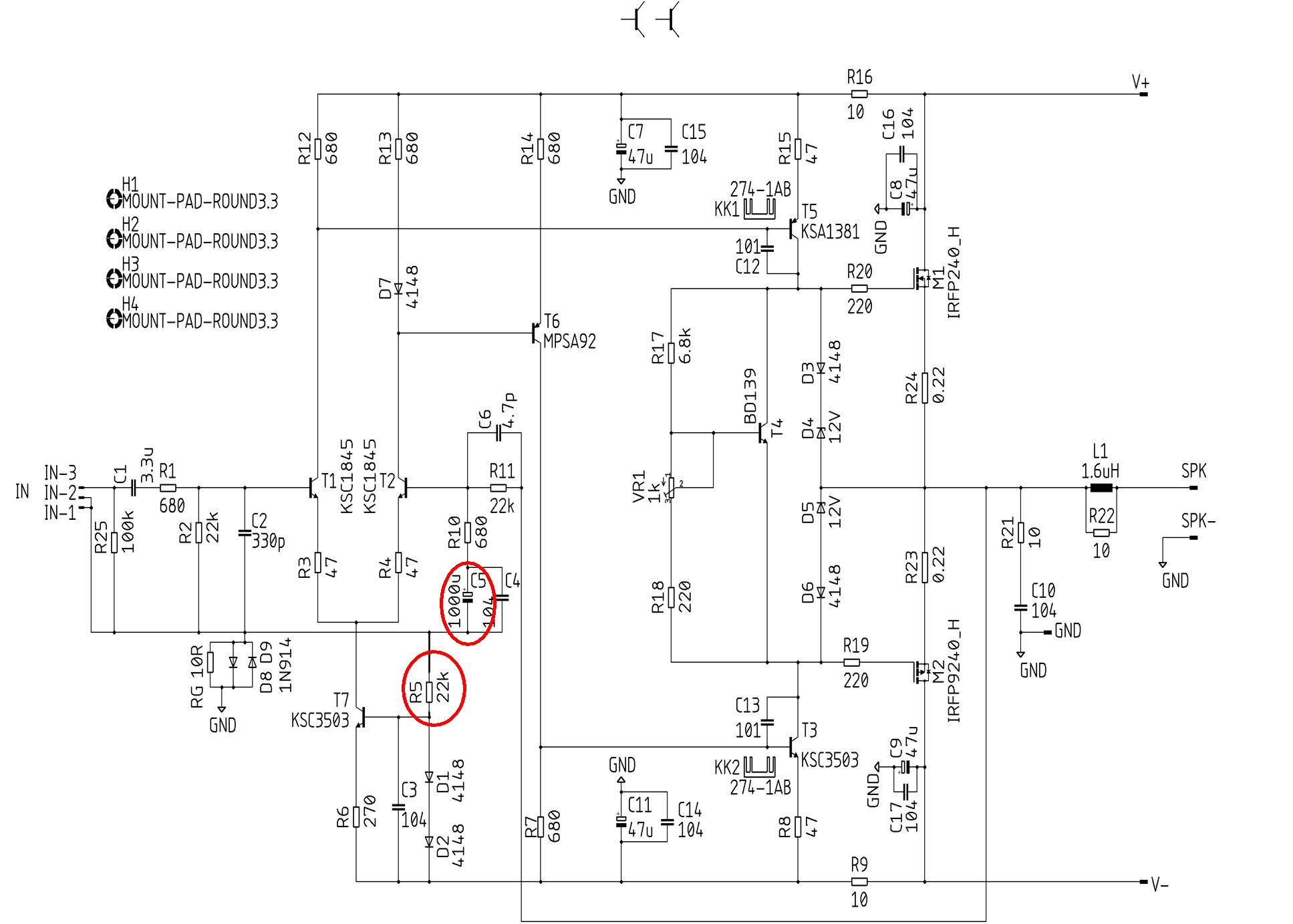

Thank you for that write up. I smoked my mosfets but I now have a pair of lead wires to measure bias under the 0.22ohm resistor. I also see you used a 1000uf cap at c5. I was confused by the 2 schematics floating around for this board, where one appeared to show a 220uf Cap in this location. When I get the mosfets I will change out c5 for a 1000uf.
If you got the "prasi board" with diodes instead of led 1000µf is the right value for the feedback capacitor. There are testpoints on the board, never used them, but i remember about...perhaps to measure the 0,22 ohm resistor...

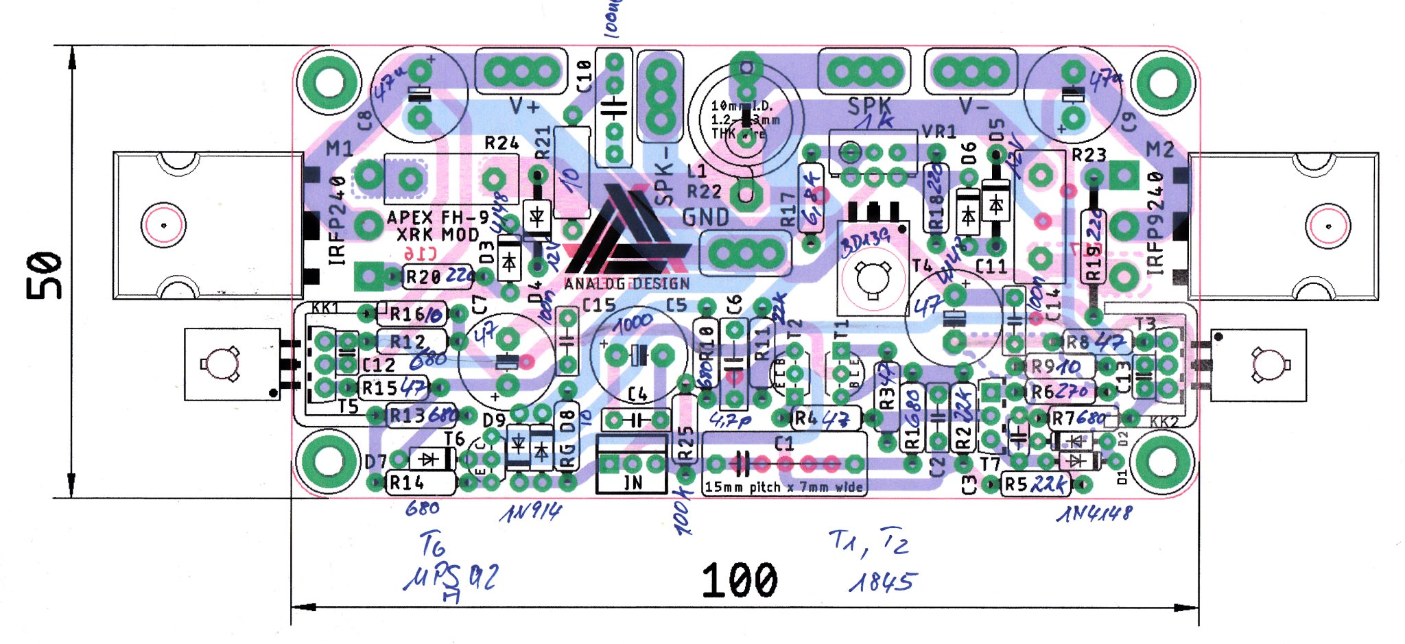

I think you use this board. Take a look to D1/D2 and the R5 22k resisistor connected to the C5 1000 µf capacitor. Because i had little trouble with one board i filled in the values. The testpoints i rembered are not useful i think. XRK will know what to do with them.
Peter
Peter

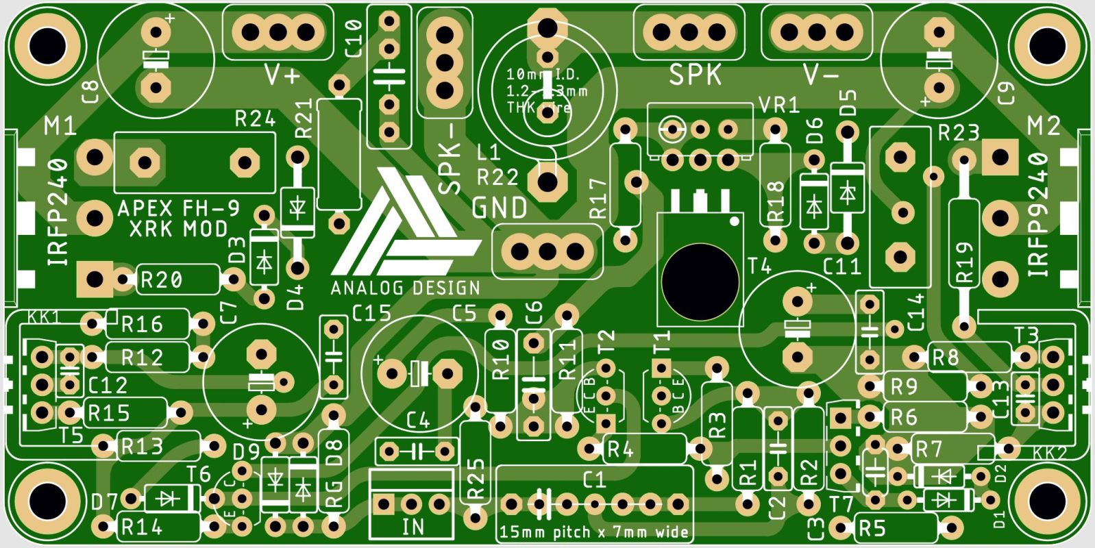

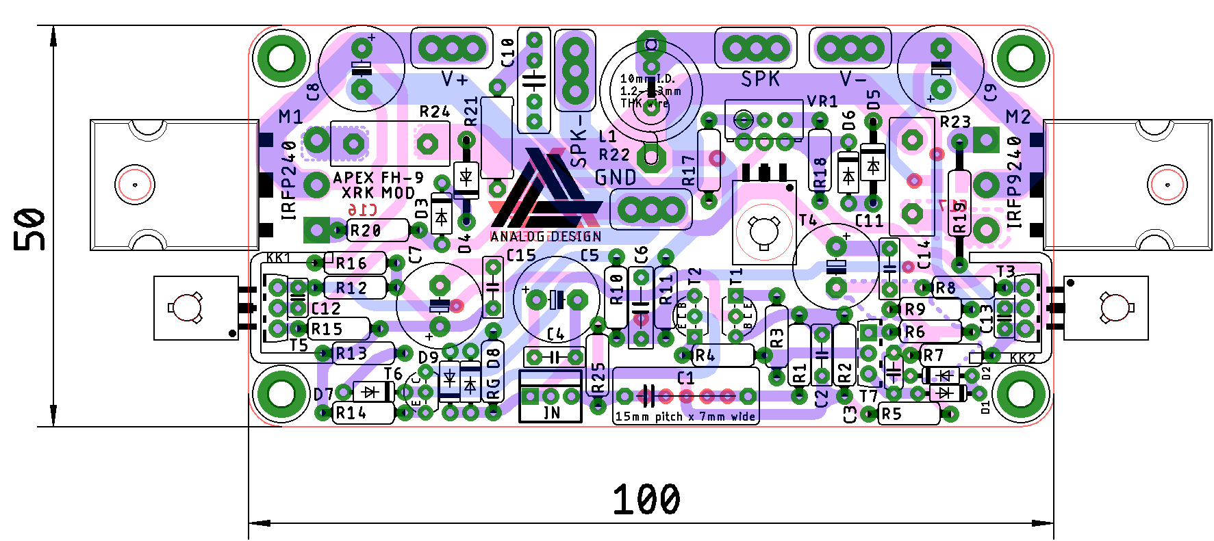

The Geber in post#2 doesnt match the schematic. Its q different layout.documents by Prasi and XRK...thank you !!!!
Can I find the Gerbers from this layout somewhere? 100x50mm.
