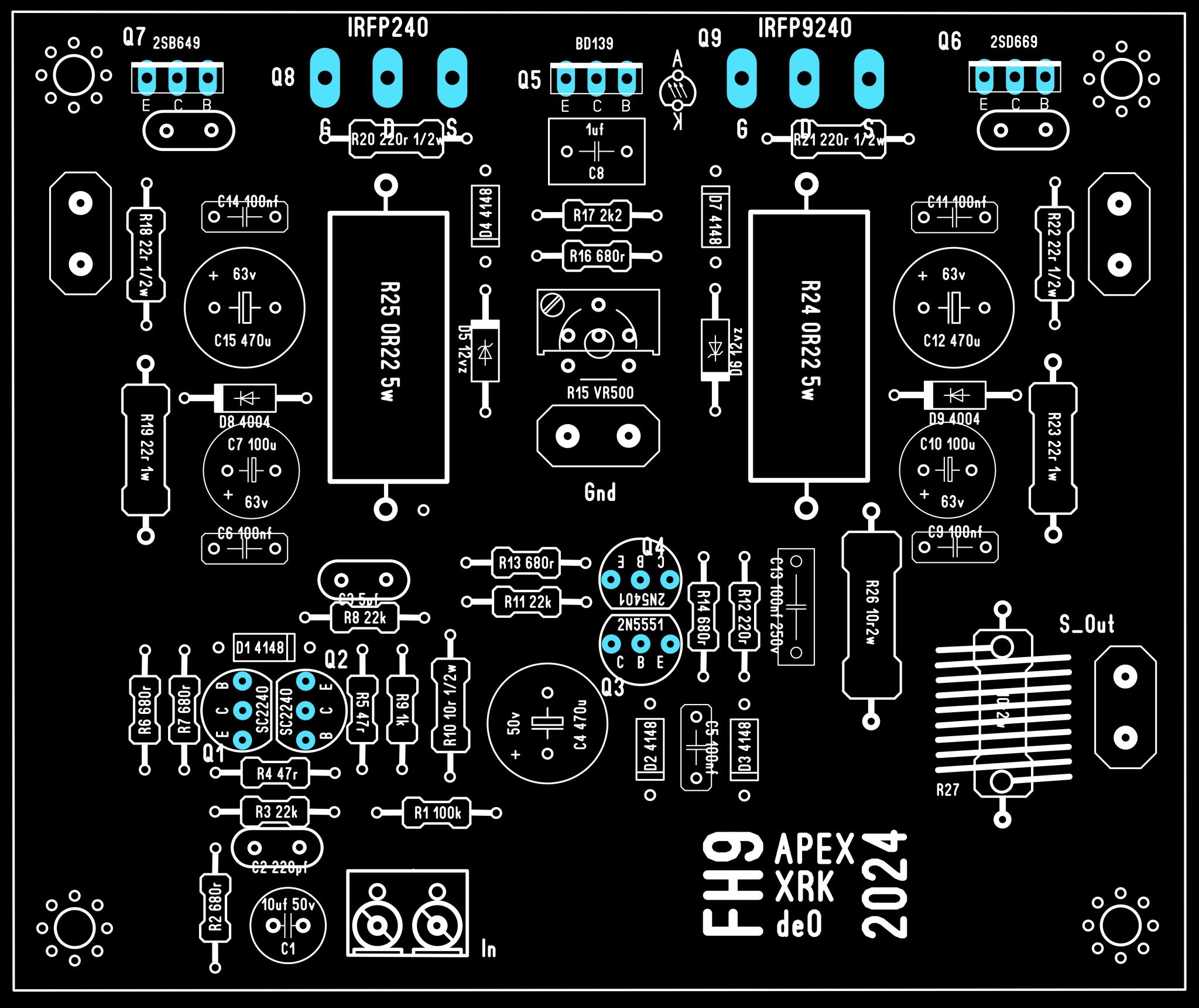

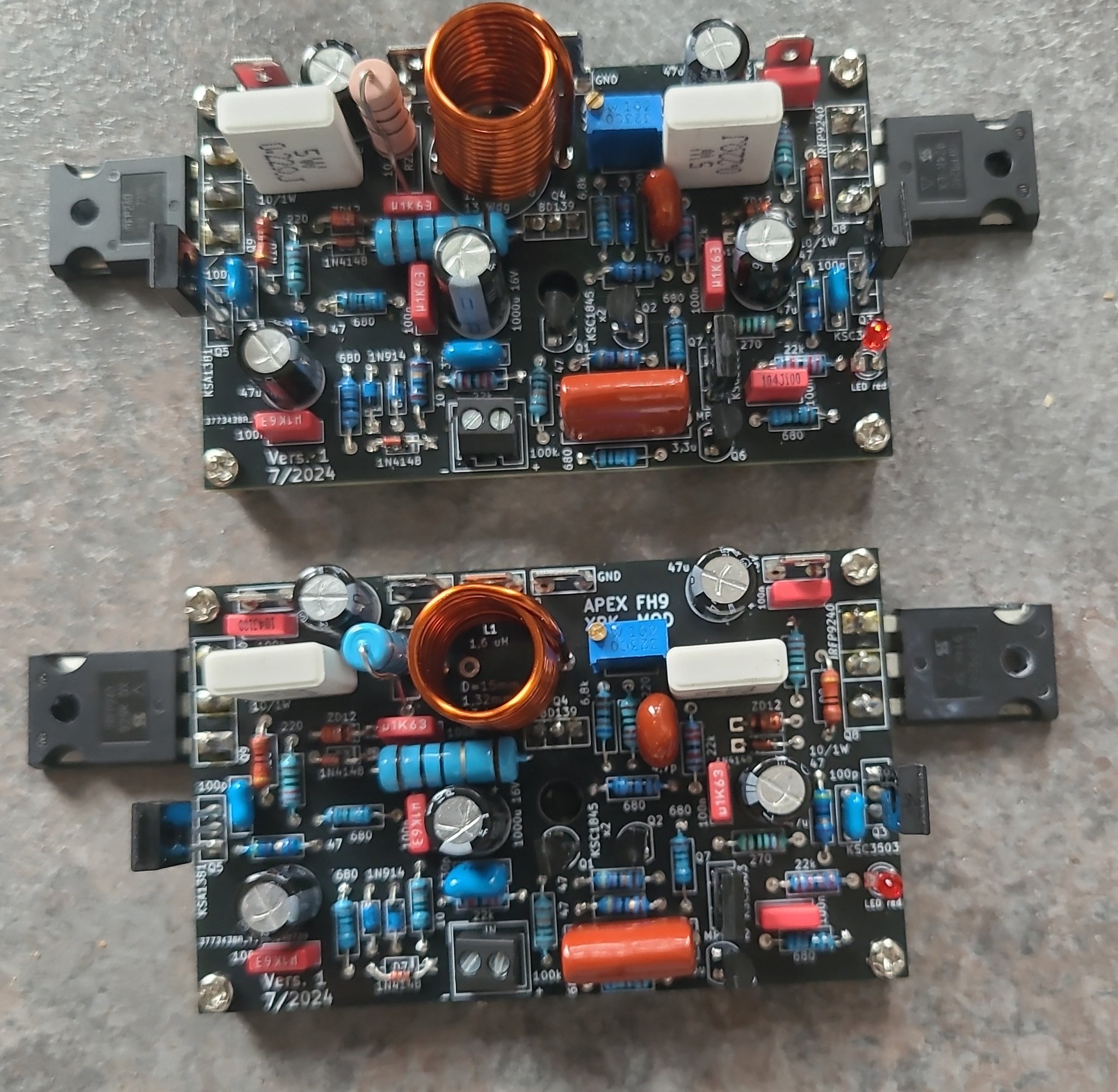

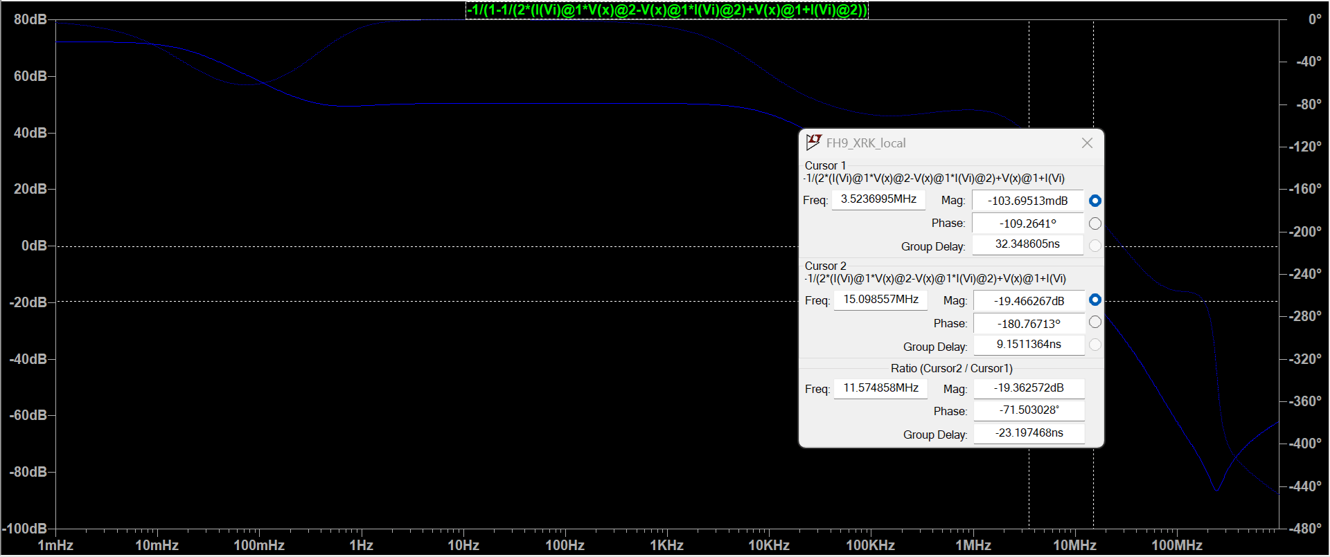

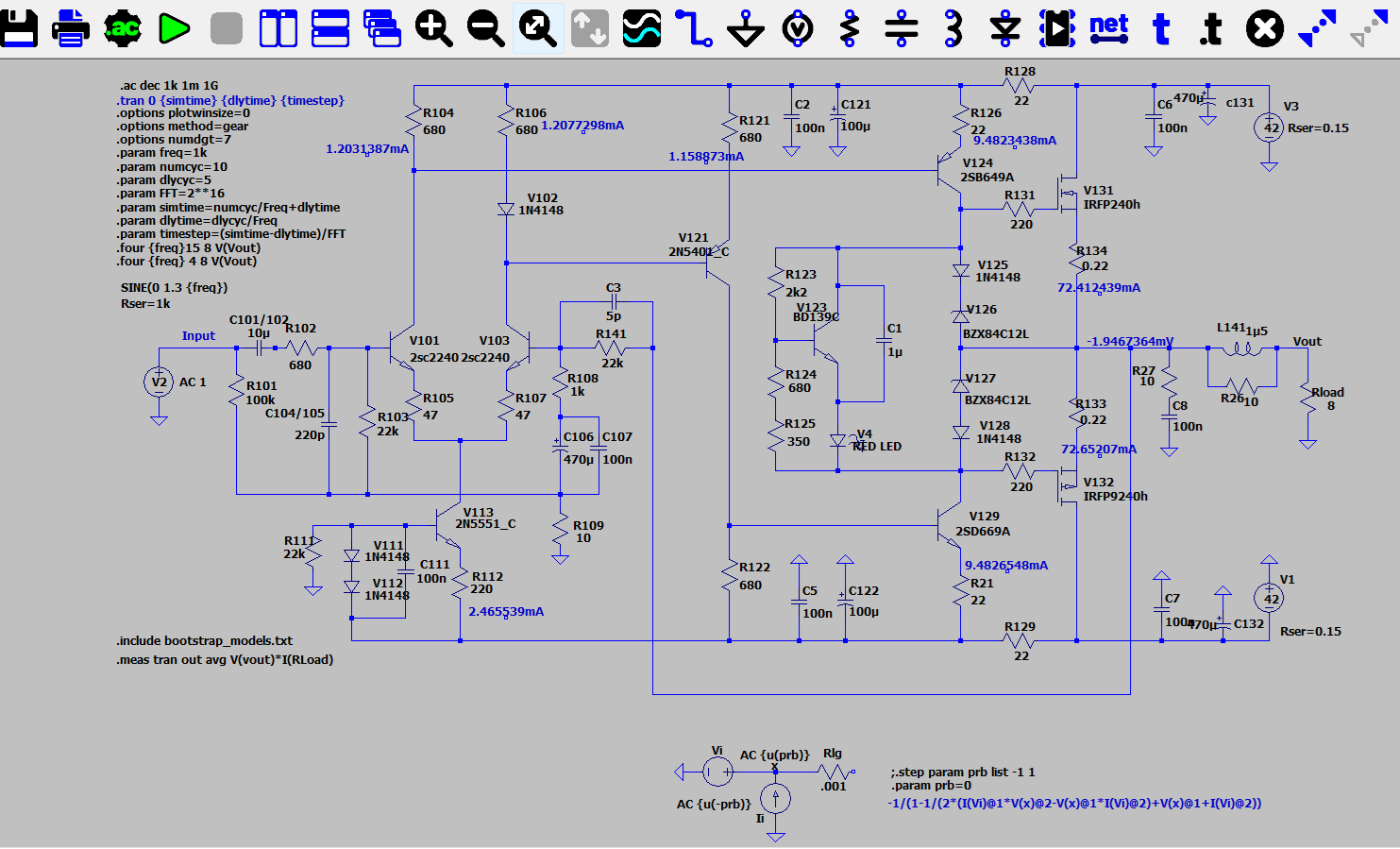

I am dropping the TMC scheme because sim results shows different profile values when compared with the original. It has become a different amplifier in comparison, so I am sticking to almost the same values as with FH8/FH9. Three devices was added in my circuit, two 1n4004 diodes as additional protection for the outputs and one led for thermal tracking.

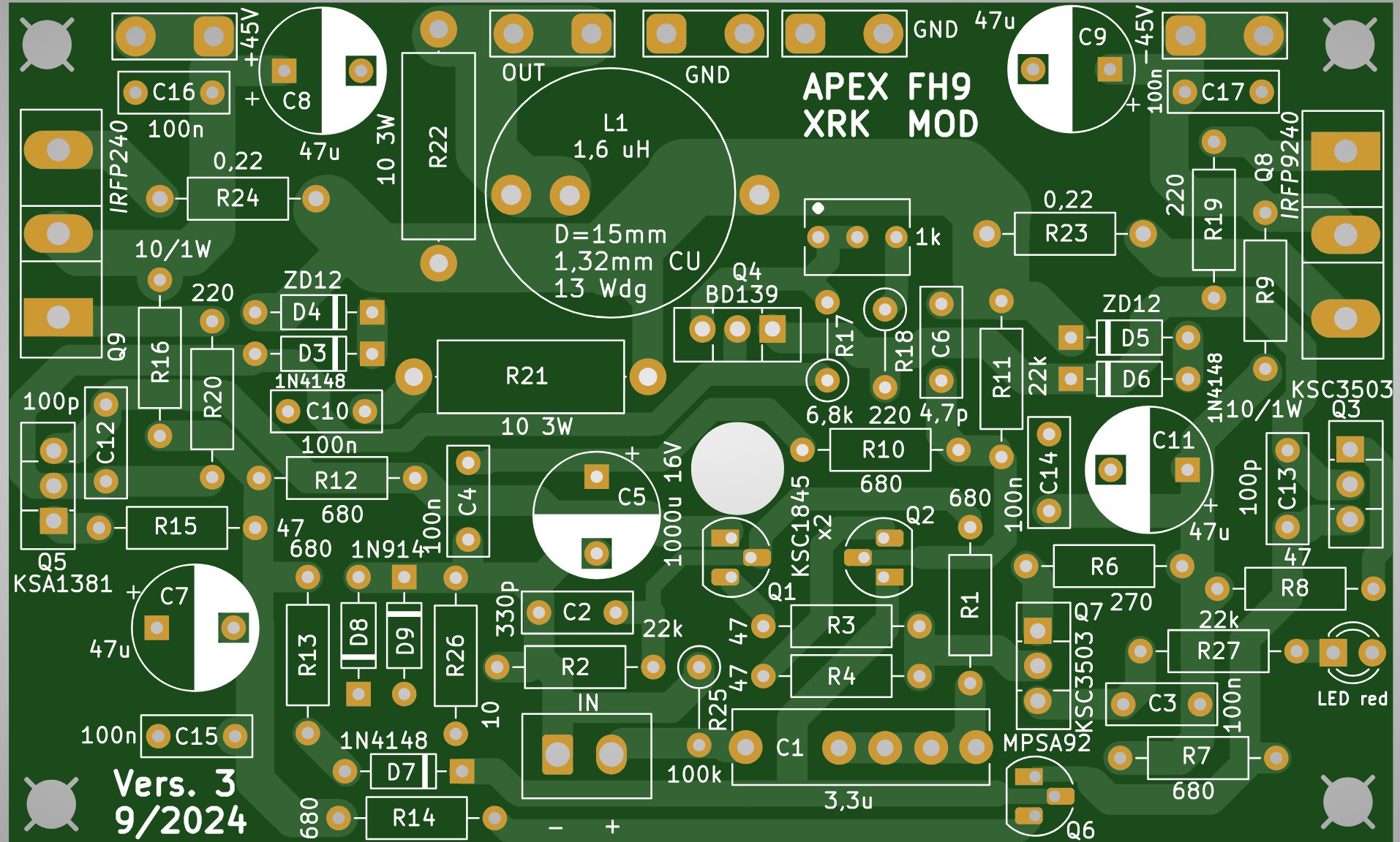

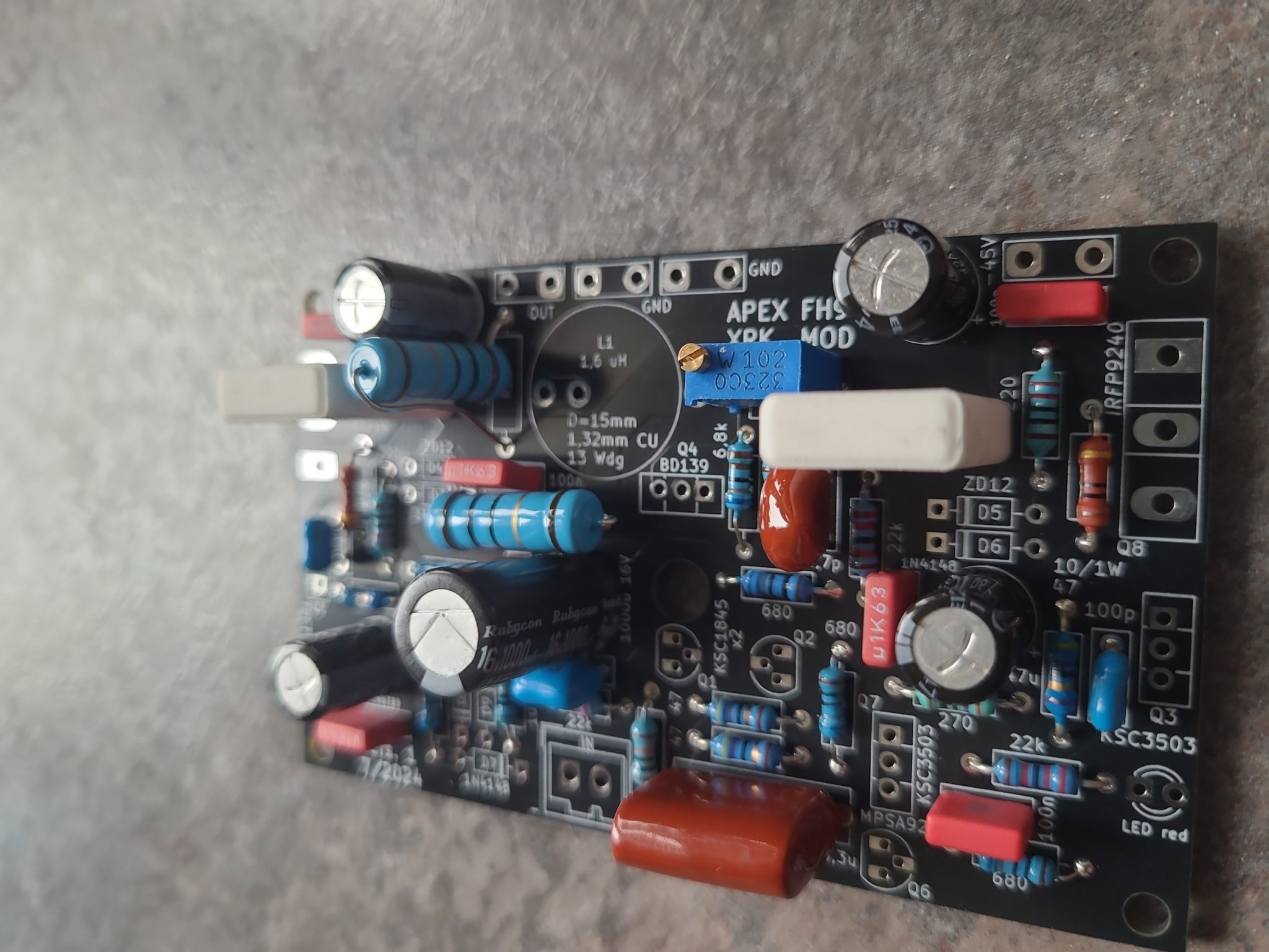

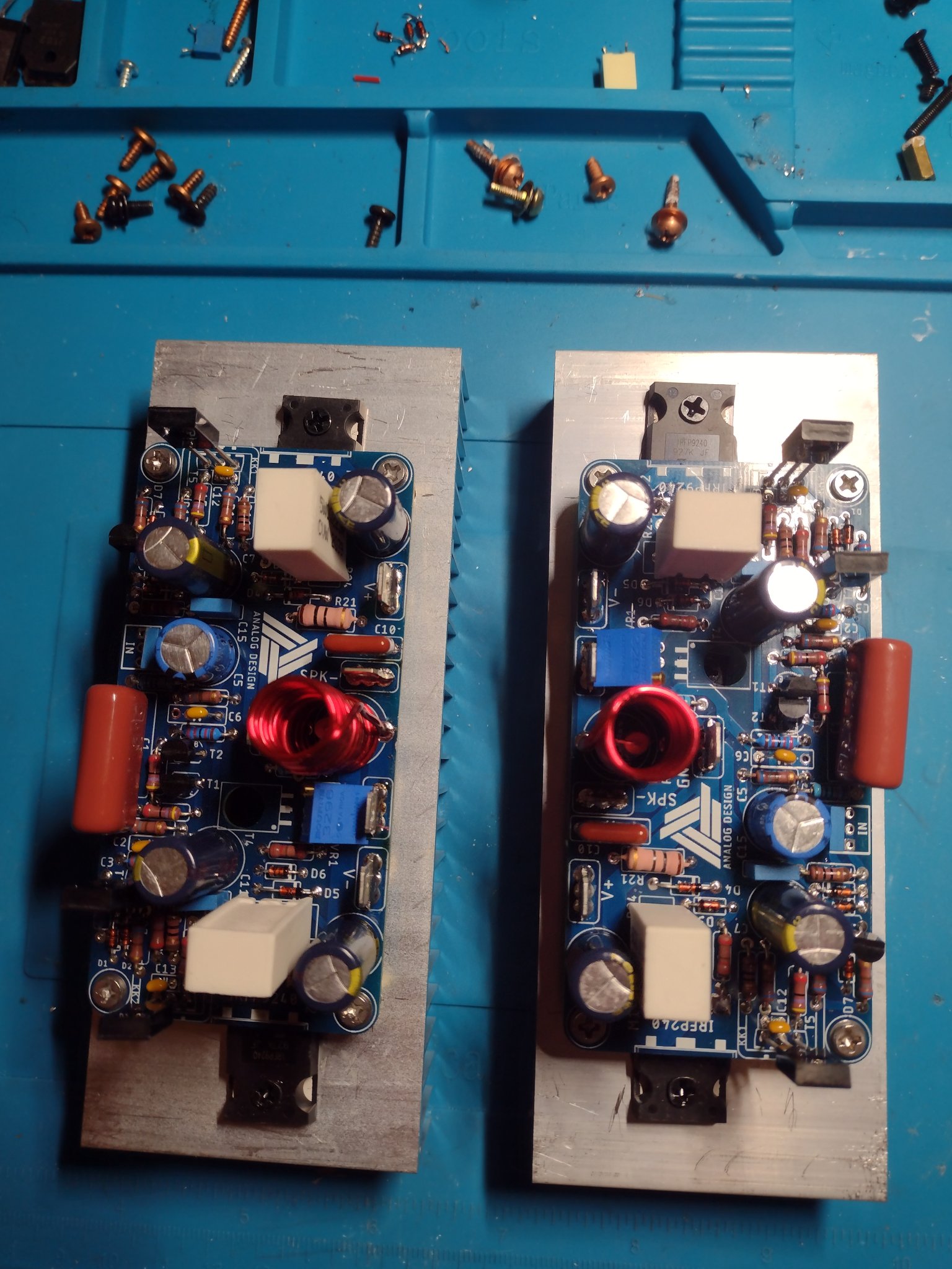

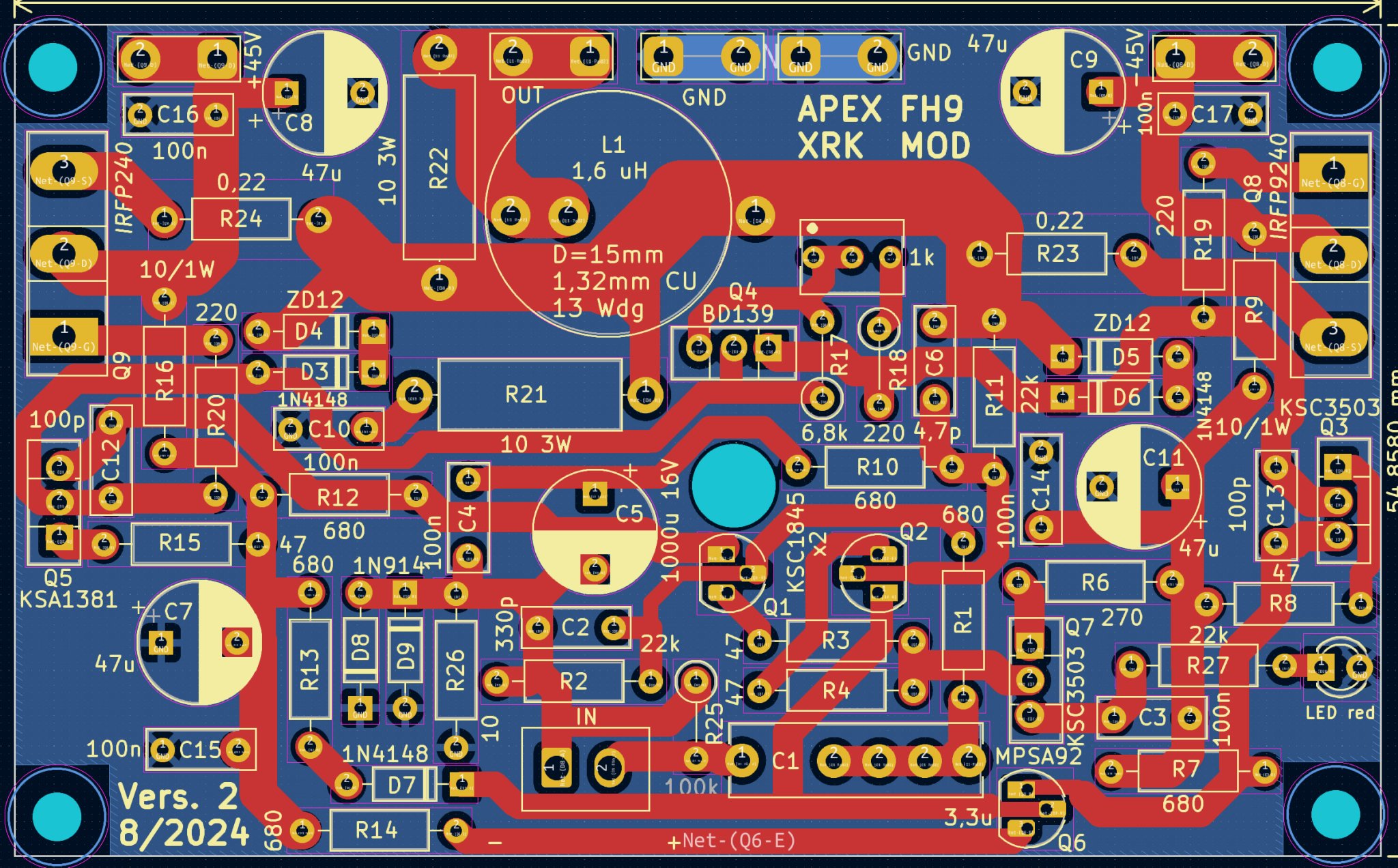

i began to assemble, because i wanted to know if all components fit well....
I have to give a little more space to the feedback capacitor...
I changed the footprint of one zobel resistor, made it bigger. The pot had moved a little bit...
The rest is ok. You can see on the picture the older, first version.
I will post changed gerber files...sorry...The 3d look of Kicad has sometimes nothing to do with the reality...

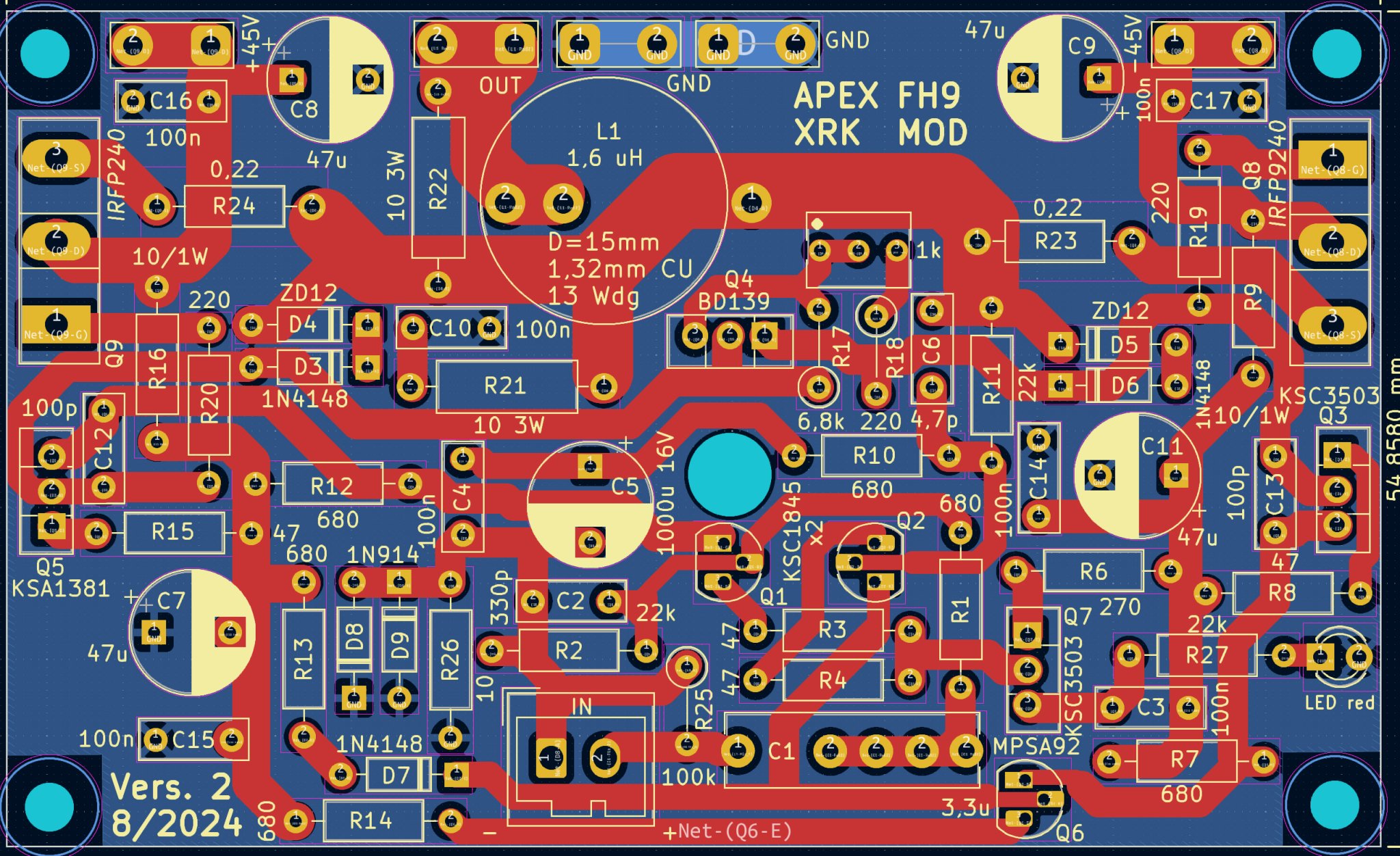

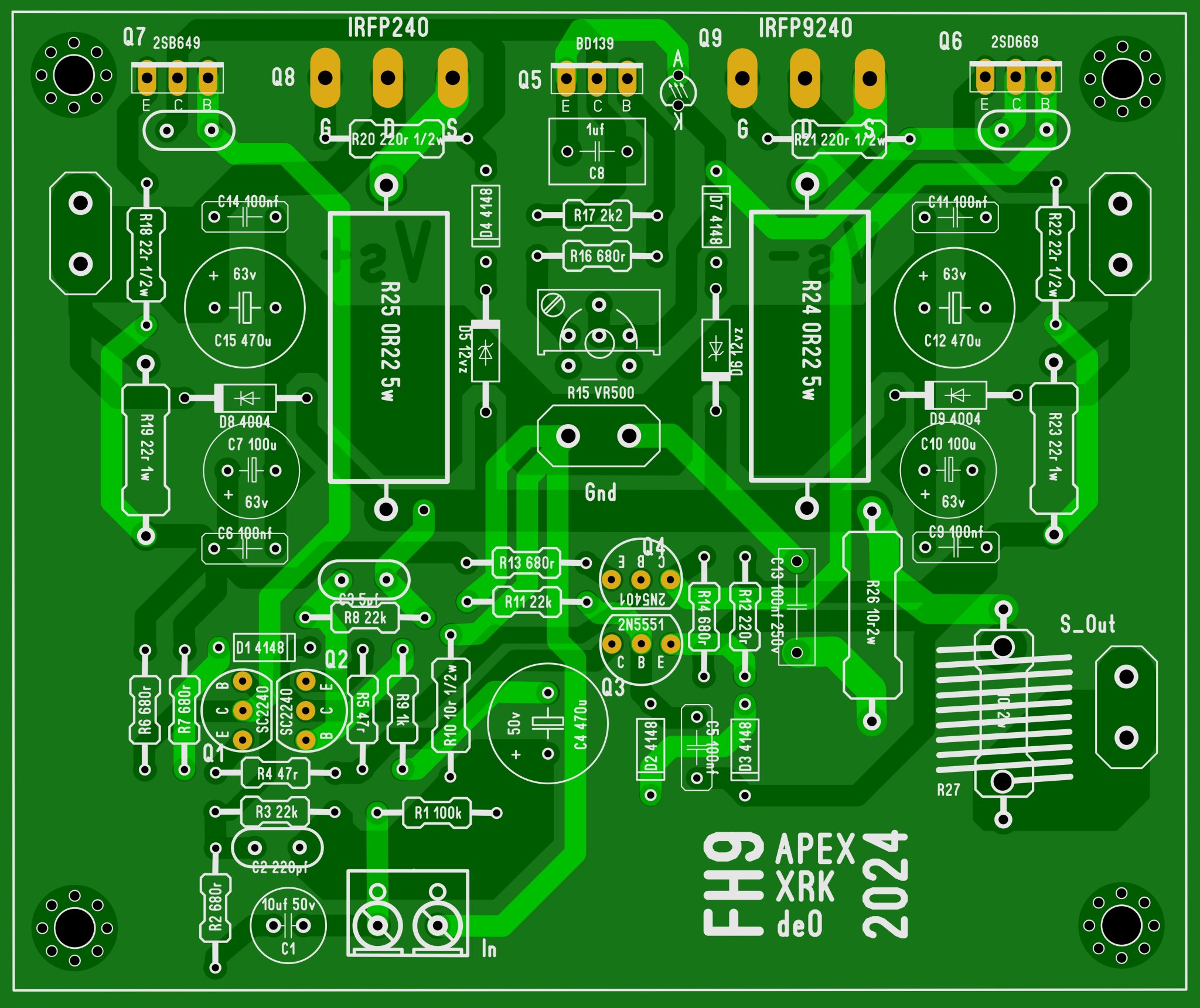

i have some footprints changed now to get get more space to other components. I post a new gerber file. If someone is in a hurry he can use the older prasi board.
I dont know how long it will take to test my pcb.

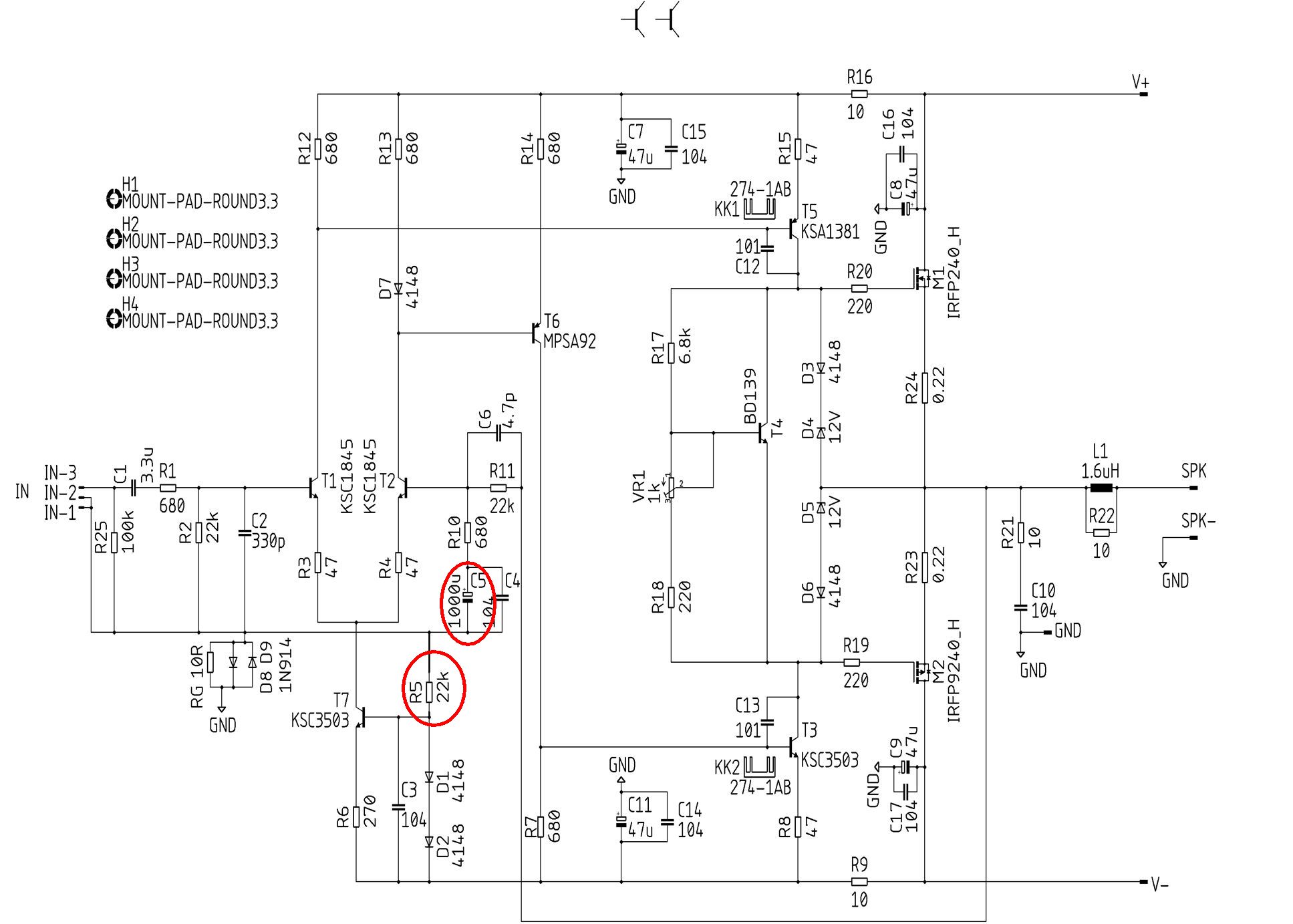

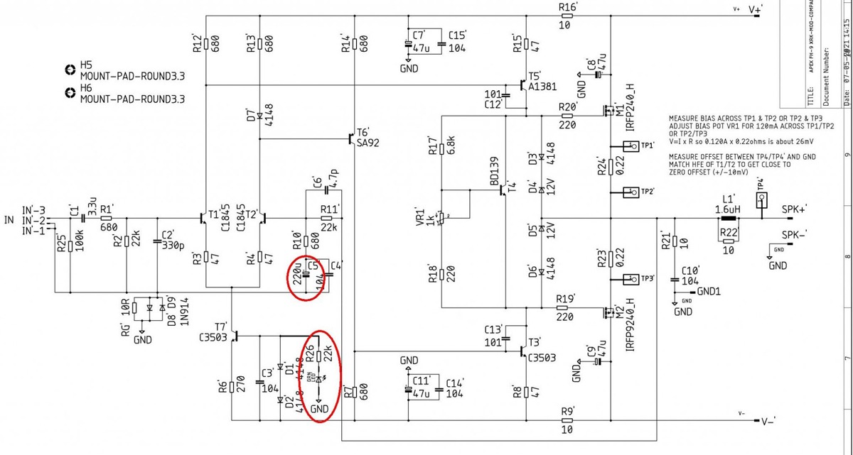

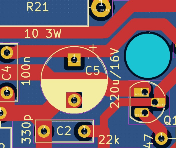

Hi..
I have compared the components with the boom list. The 1000 µf feedback capacitor has to change to 220µf/16 Volt in this variation with led. No other footprint, only a wrong value in the gerberfile. If you want to use my pcb think about this change....

Hi Peter
your work is fine.
(do you have interests to do a small dual side pcb for FX8....kisses chris 😉😆 )
Should that cap not be as big as possible?
Hi Chris,
in the boom and schematic are two different variations.
1. With 2x1n4148 capacitor and other connecting...1000µf.
2. With led insert the capacitor changed to 220µf.
Its can also been seen in the different schematics. I think the second schematic XRK using for its pcb's, he offers.
The footprint on my pcb is the same, 8mm dia.
My Pcb are fully assembled. Testing is missing...

yes you are right...in the FH9 HVX is a 220µF cap too.Hi Chris,

FX8 is a single sides layout pcb...this is the reason why is so big. your and prais layout of FH9 is compact and very small so build a 2U housing amp is possible
THT dual layer would be nice...if you like the sound.
