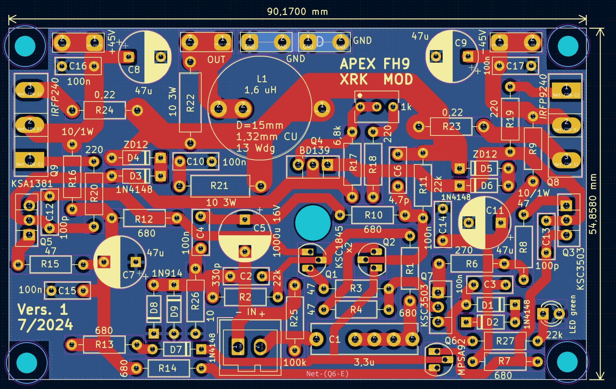

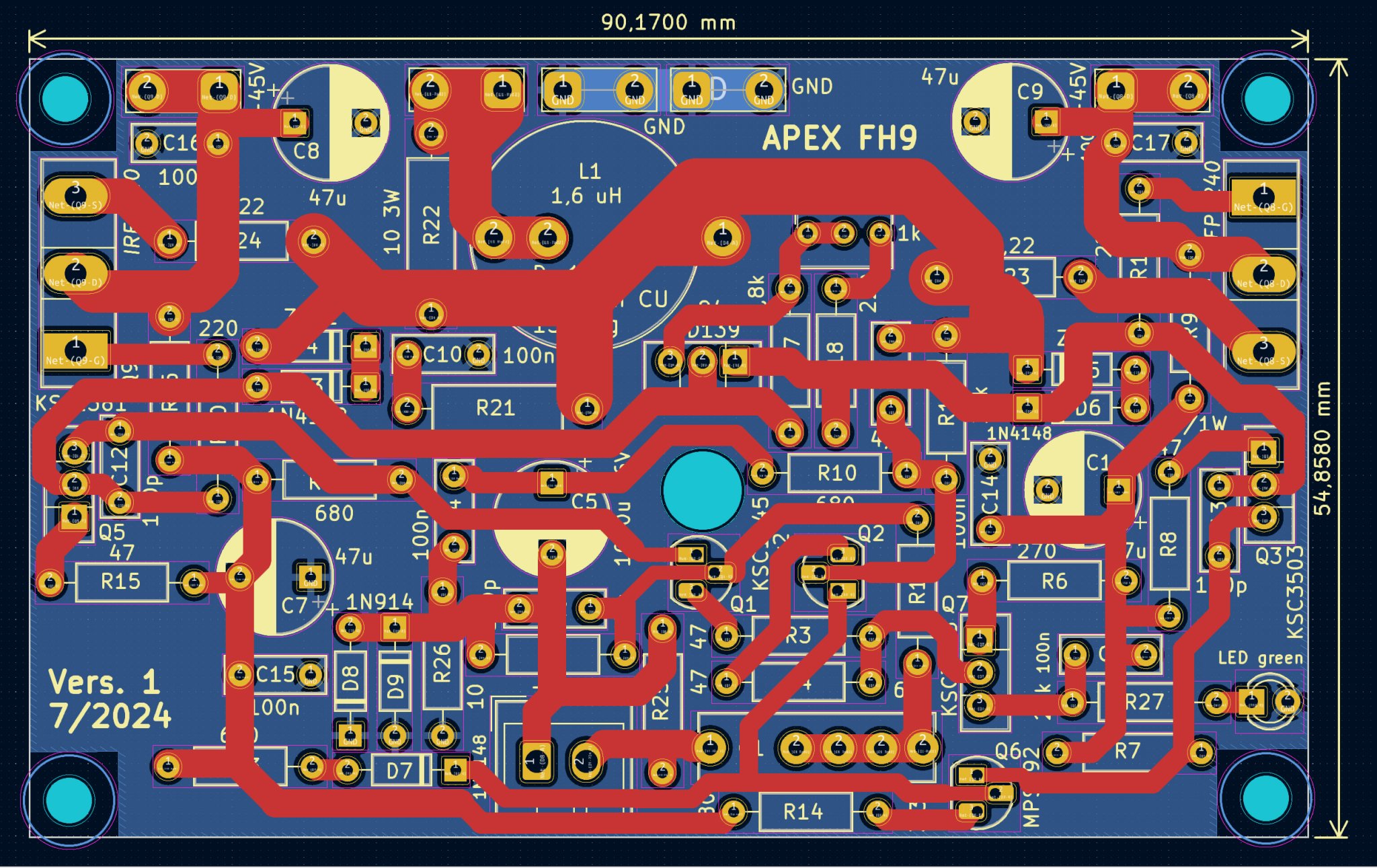

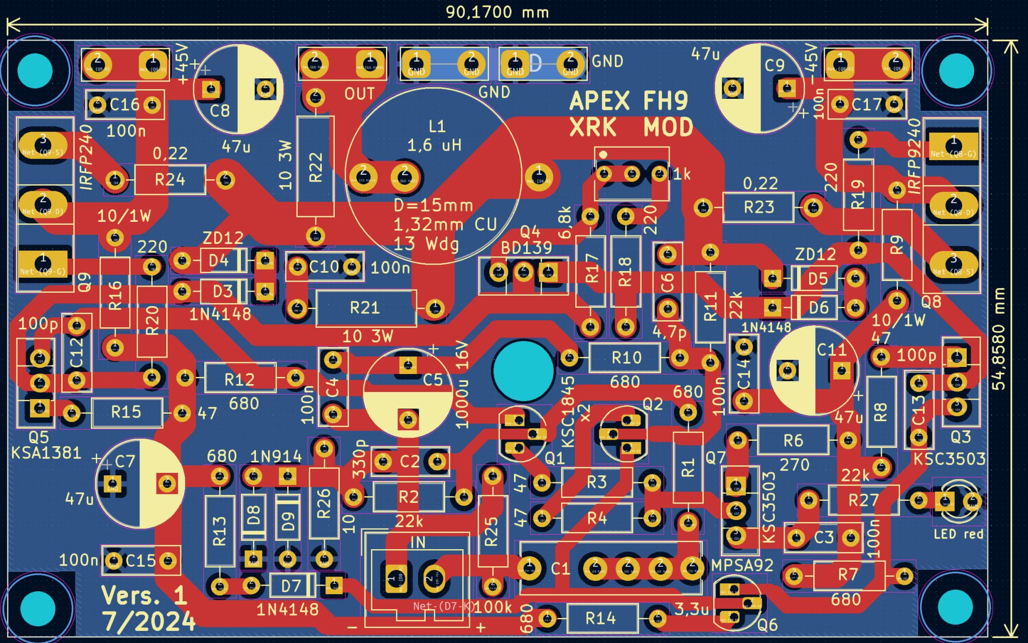

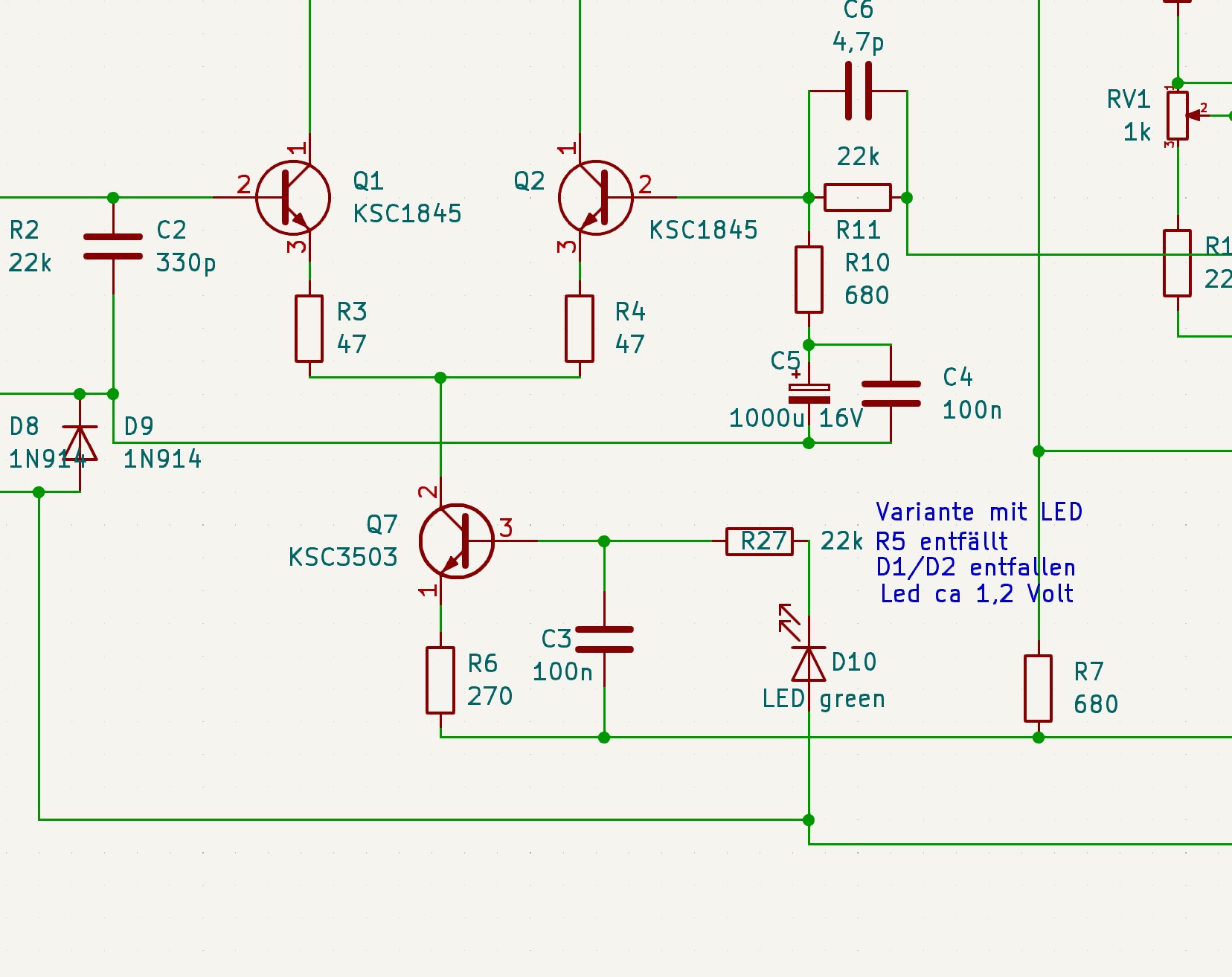

Hello,

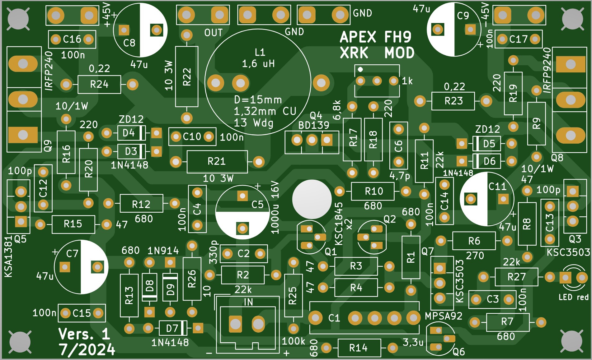

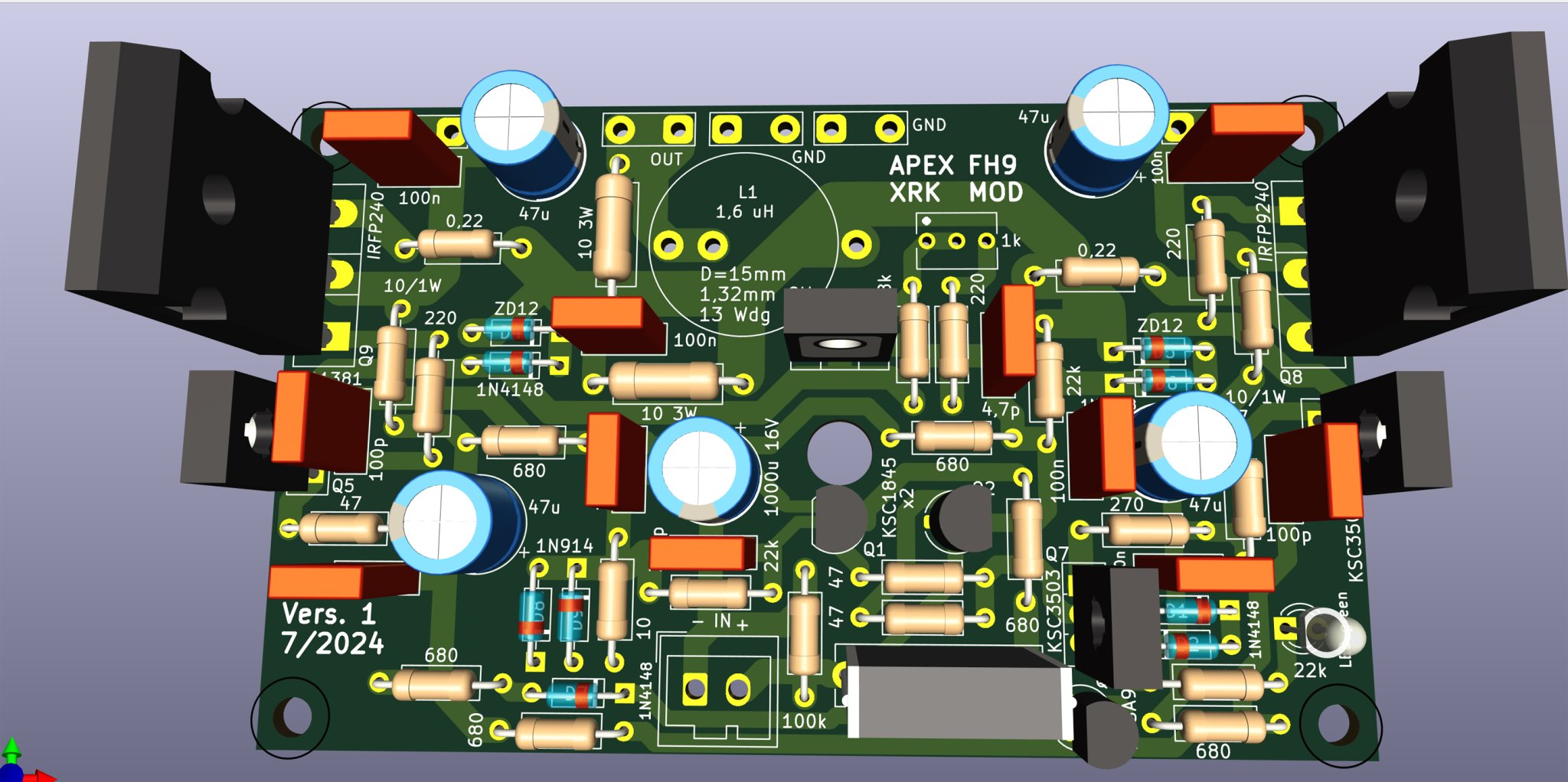

because i have the time and desire, i made a new PCB for this wonderful amp. Instead of R5 to the Capacitor, i choose the variation with R27/LED. Dont know if the board will work until yet, i have to test it out.
No smd components are needed and the biggest change...values on the PCB. Enough space for a big inductor. The board get a groundplane for GND. The board length is a little bit shorter. 90mm instead of 100 mm. The height is about 55 mm. That makes the PCB a bit cheaper if ordering PCB's.
I have attached two pictures.
Best regards
Peter

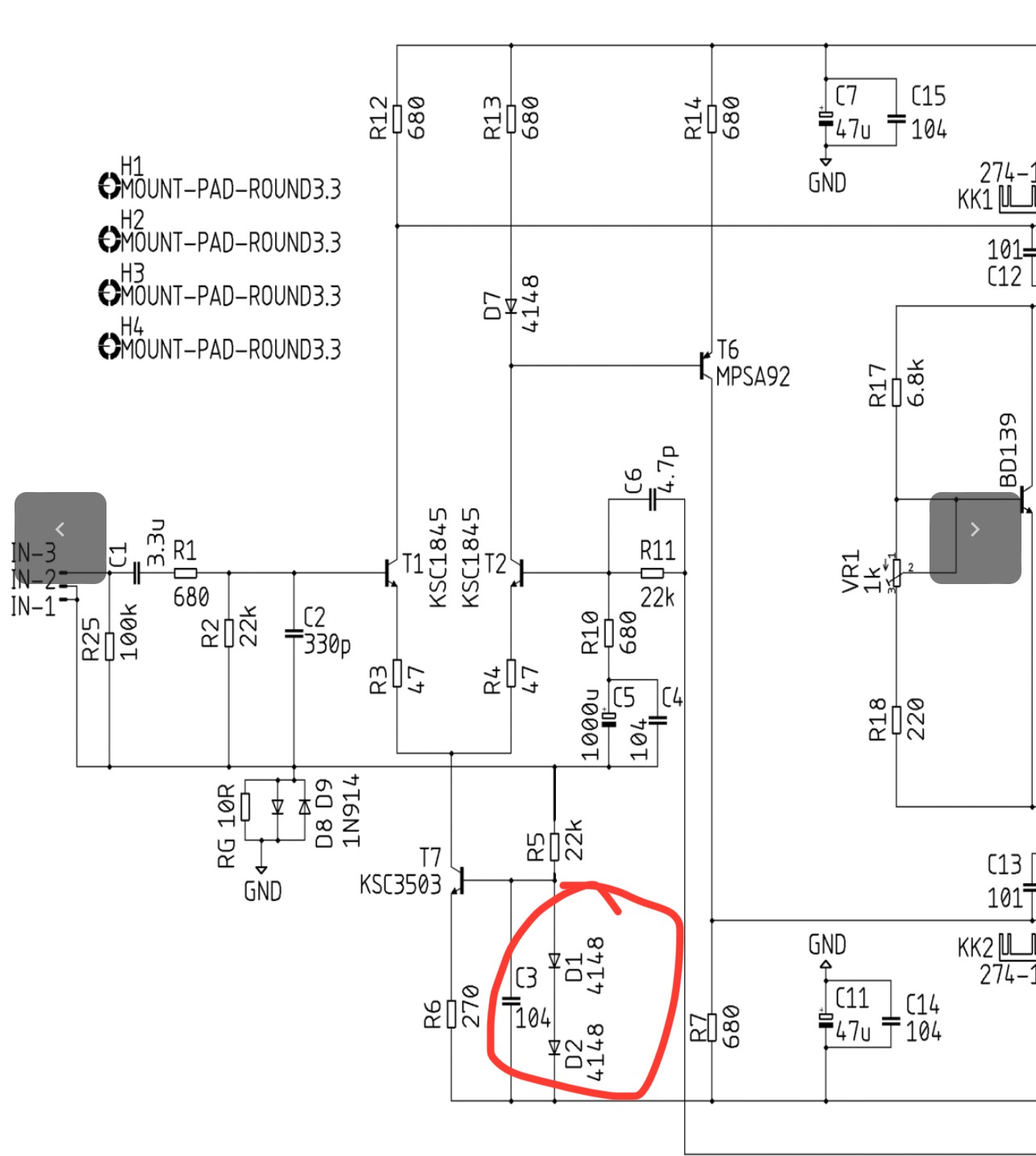

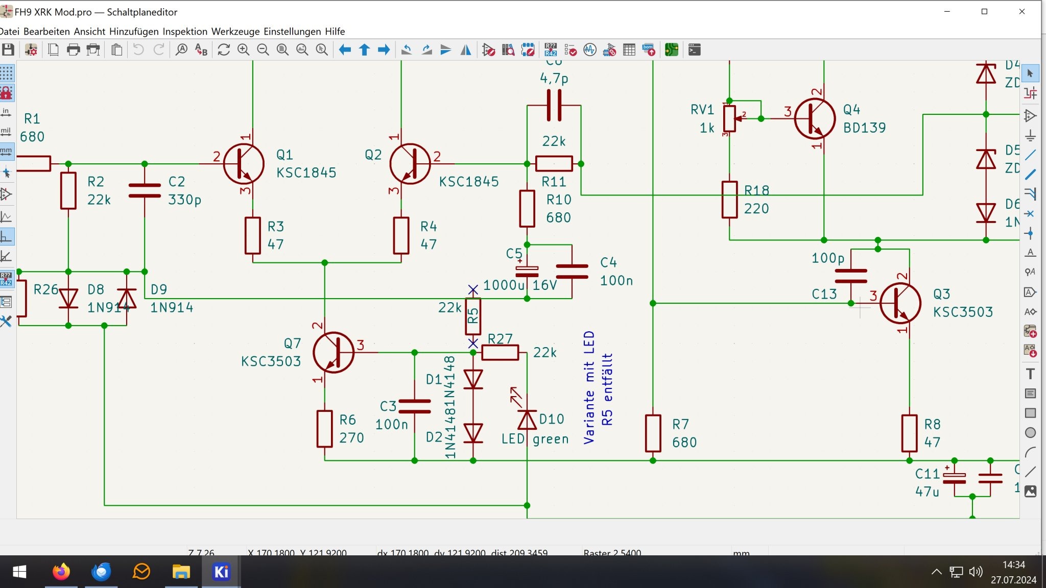

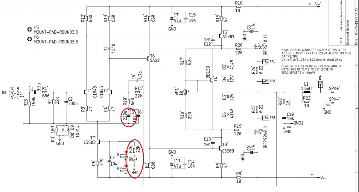

Can you show the schematic of what you did? If you want an LED indicator, replace the two 1N4148 diodes (0.6v drop each) with a single LED with 1.2v drop. I am afraid what you did was add a voltage drop with green LED to the base voltage control of the KSC3503 and that will cause a DC setpoint variation that is now not a nominal value.
many thanks. I have the two diodes in. No problem, my mistake. I will delete the two diodes. A few minutes... )
Another Question....with the LED the capacitor is to change too ? From 1000 µf to 220 µF ?
Greetings
Peter

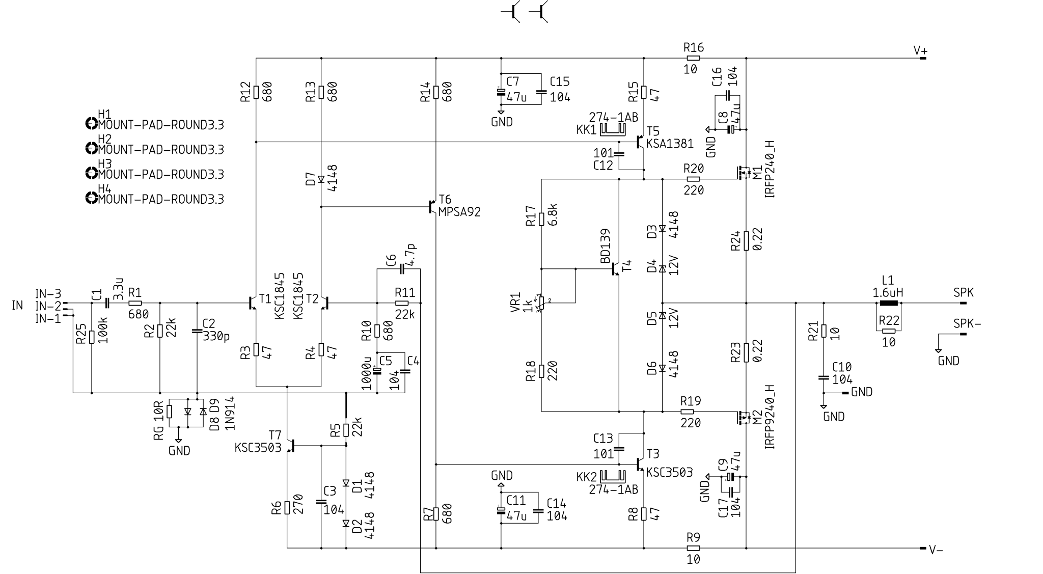

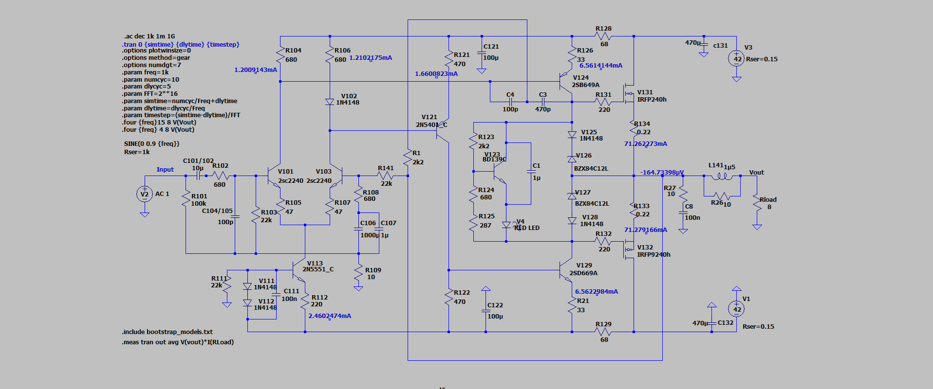

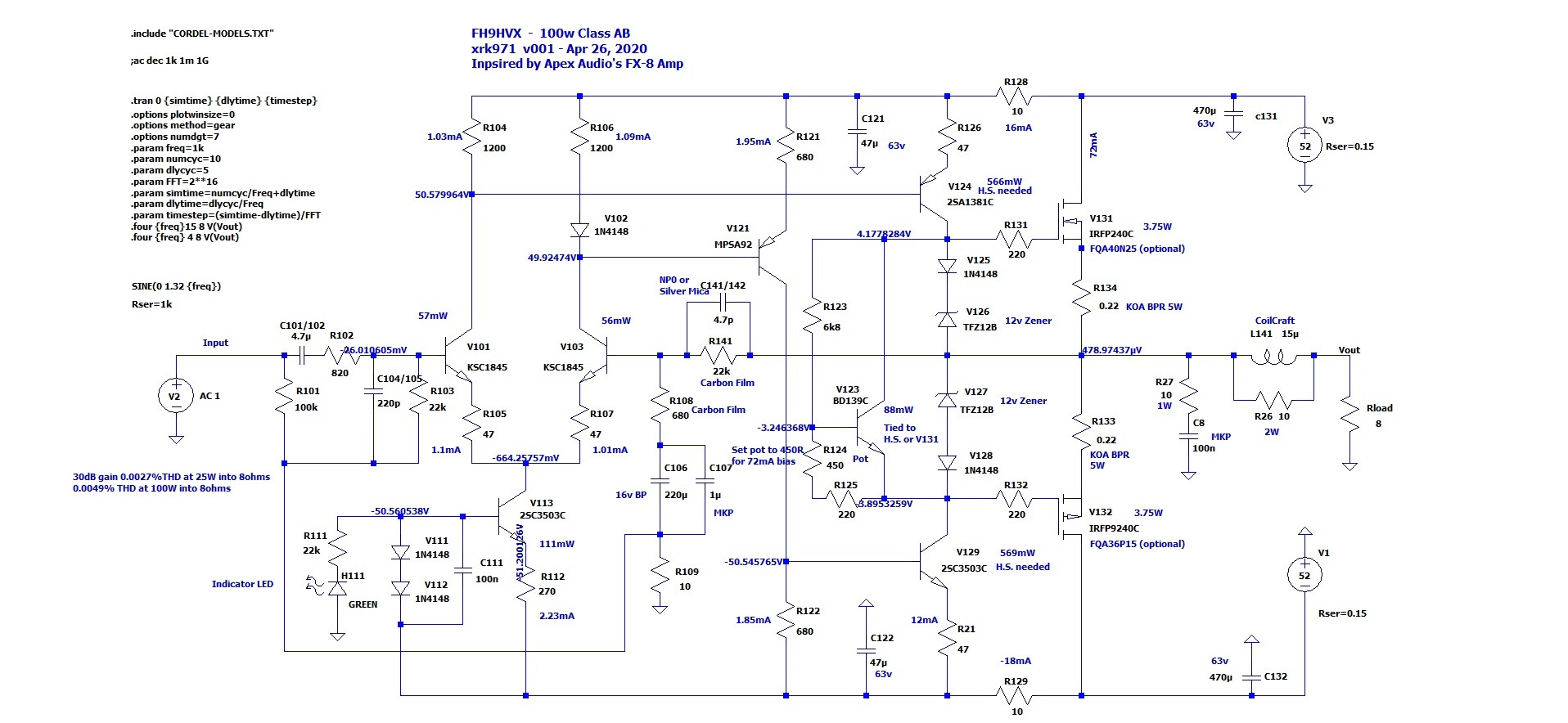

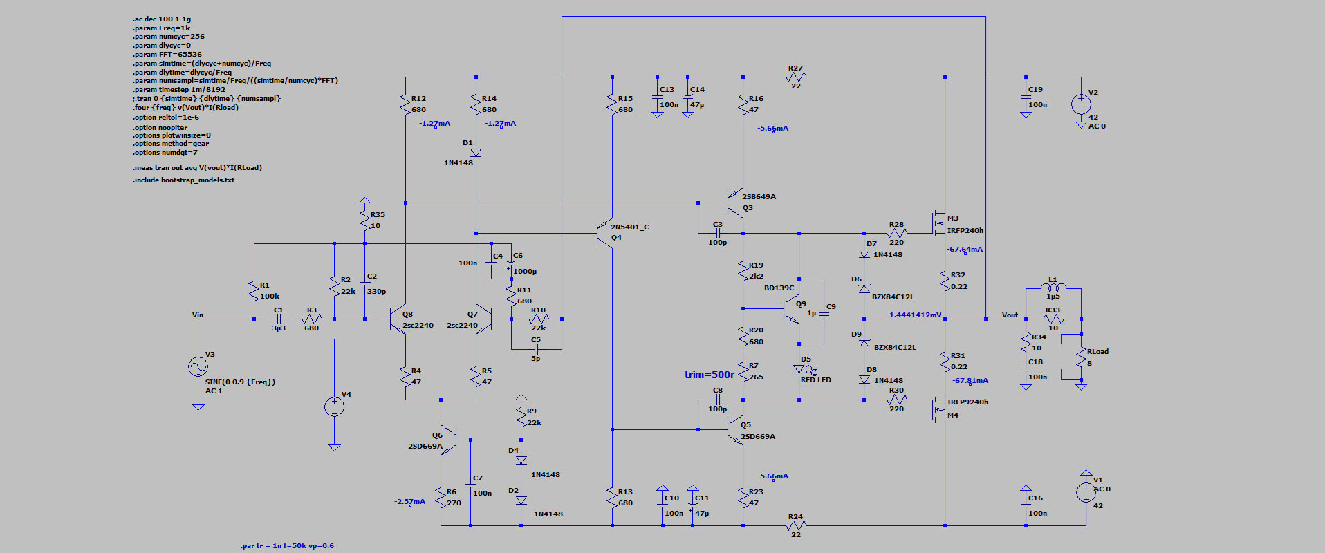

Hello,
I was trying to mod FH9 XRK to accomodate locally available parts (notably the 2SD669/2SB649), it just needed adjusting of resistor values in the VBE multiplier circuit. I have added one red led tied to the emitter of Q9 VBE trannie as an aid for thermal tracking. Simulation works fine but why am I getting negative voltages all over?

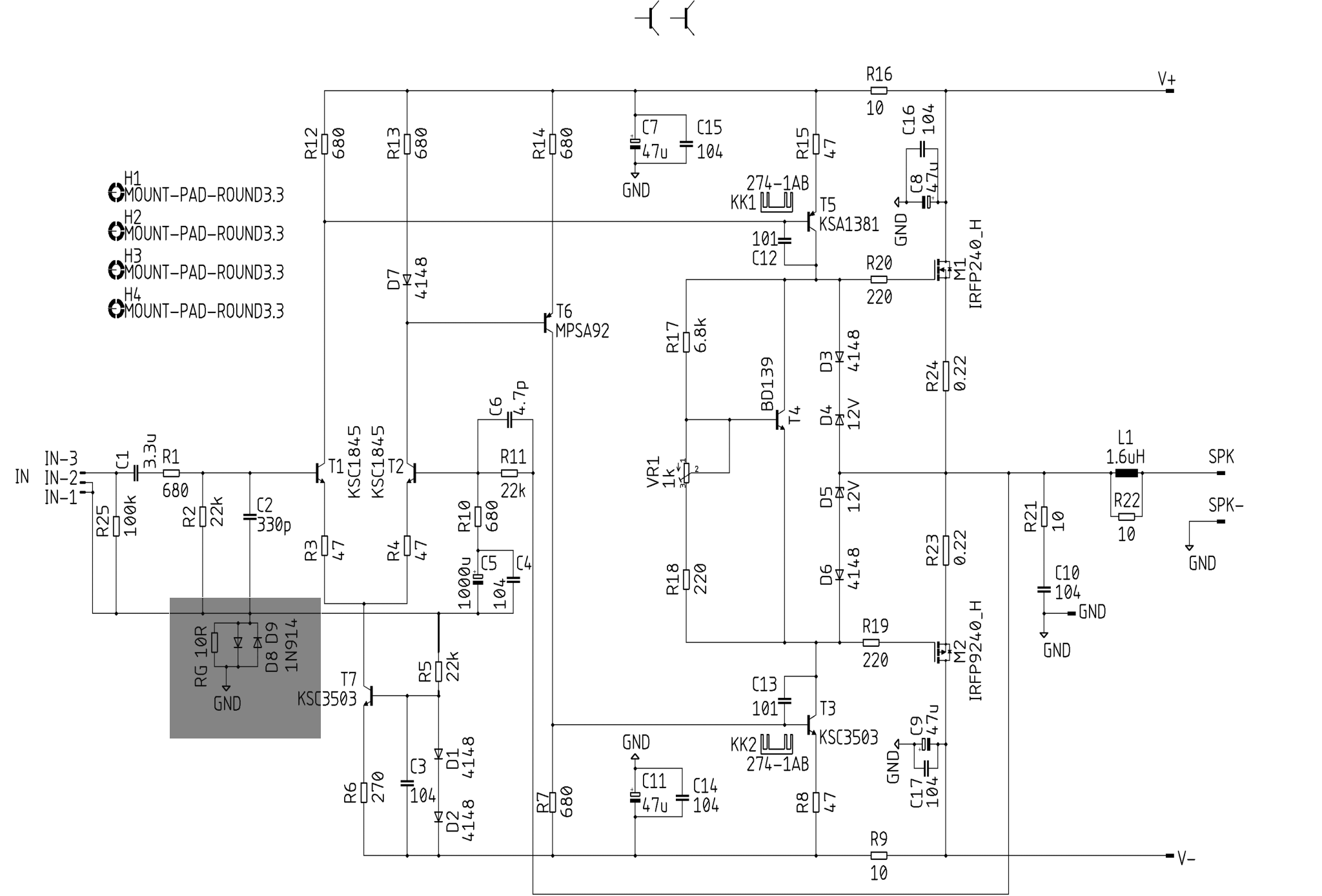

Hi Albert,
i saw R35/10 Ohm for signalground. I always do so too...if not needed i can short it. Perhaps the mod schematic can help to compare. My knowledge is not big in electronic...
Dont know if you know about...
Greets
Peter

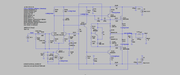

Hello,
Hi Albert
is see negativ currents but i dont know why.

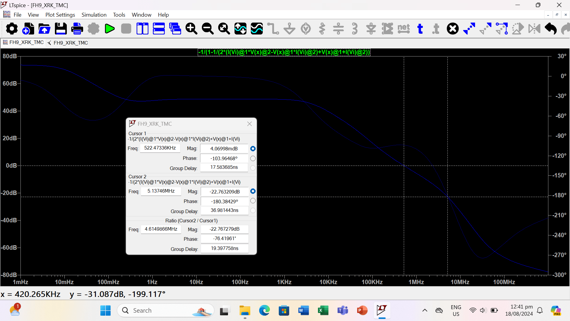

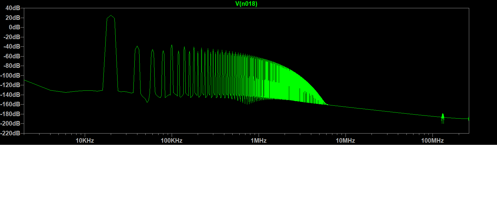

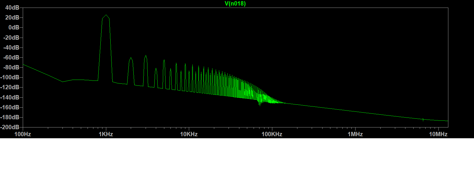

Thank you guys for your feedback, it was fine now. I snatched 😄 FH9HVX .asc file and edited its entries to match with my schematic diagram.
I just do not know if I still could name my mod as 'FH9 XRK mod' as I have adapted TMC in my schematic. Reason was, in order to come up with bode plot figures according to my preference. If time (and resources 🙂) permit, i will create the PCB.
Shown attached here was bode plot using Tian method. 1khz and 20khz FFT window at estimated full power.
