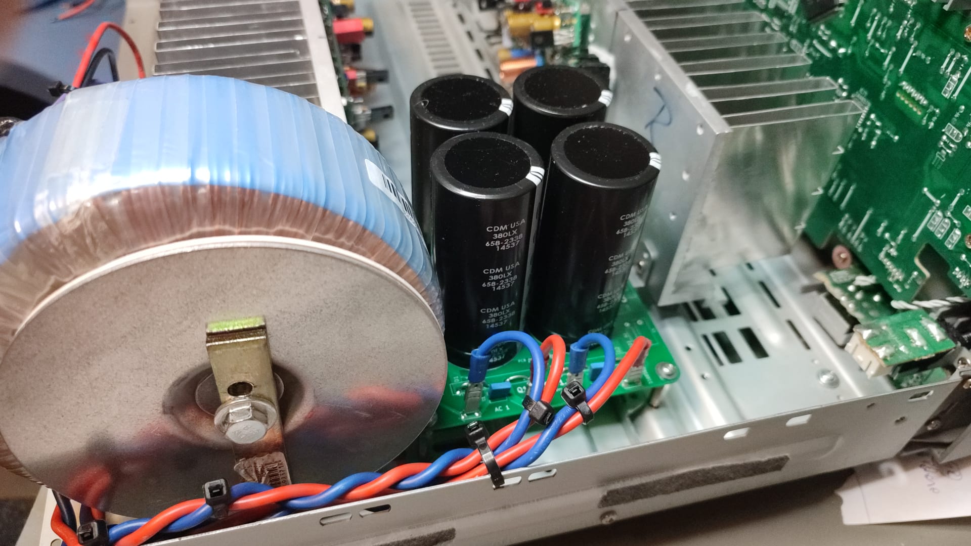

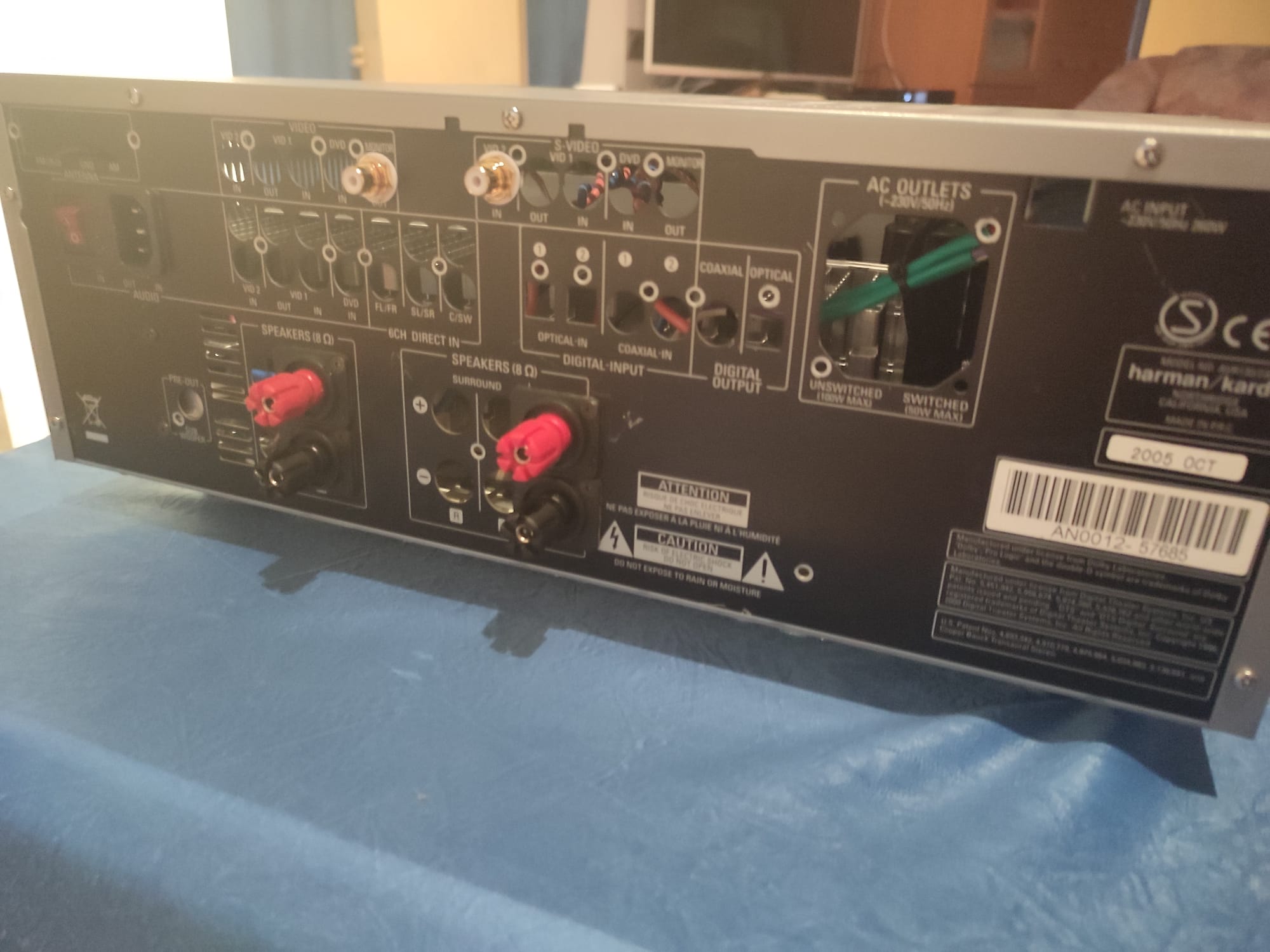

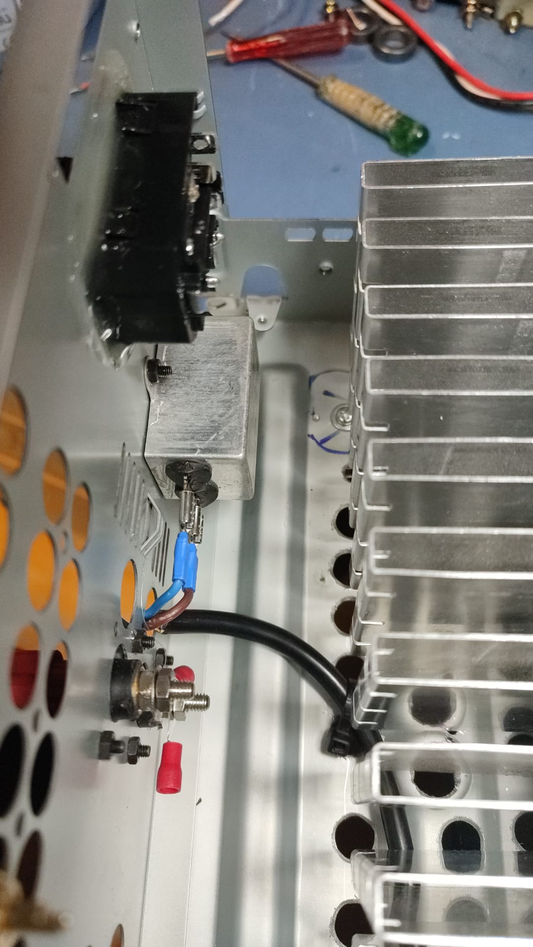

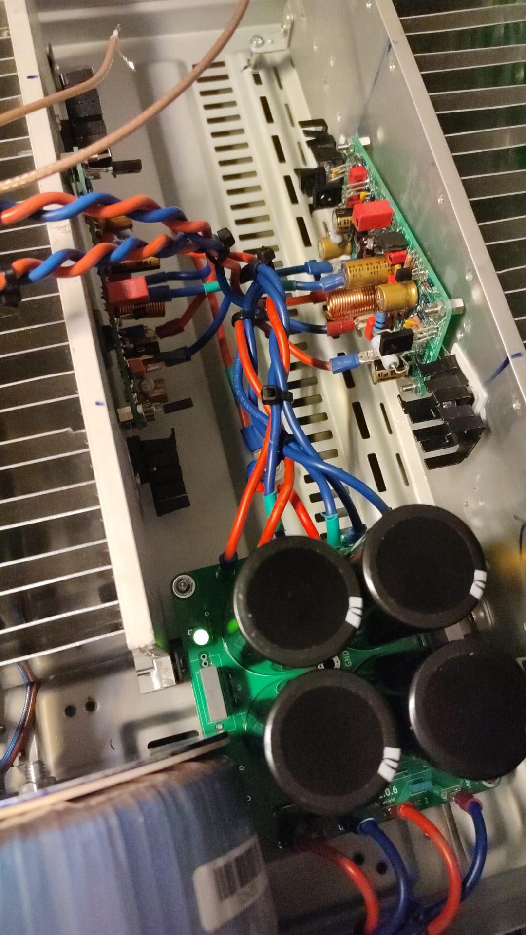

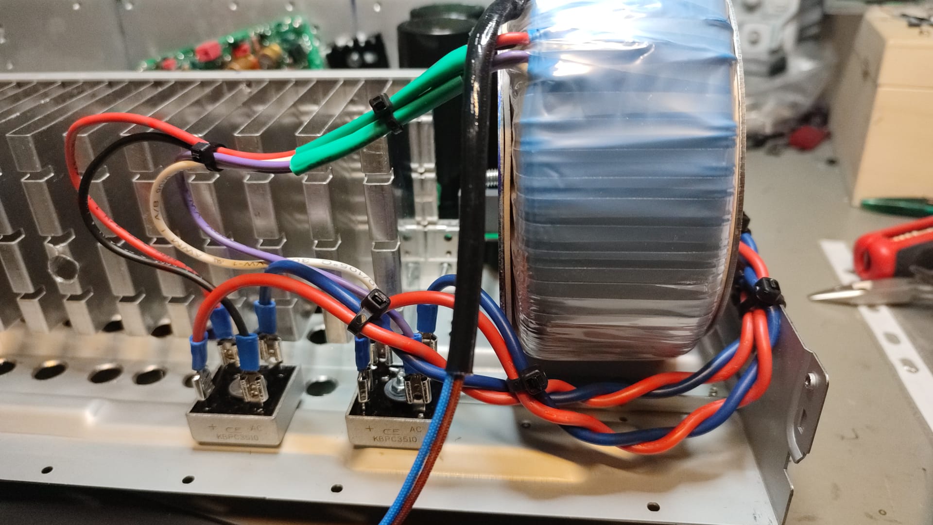

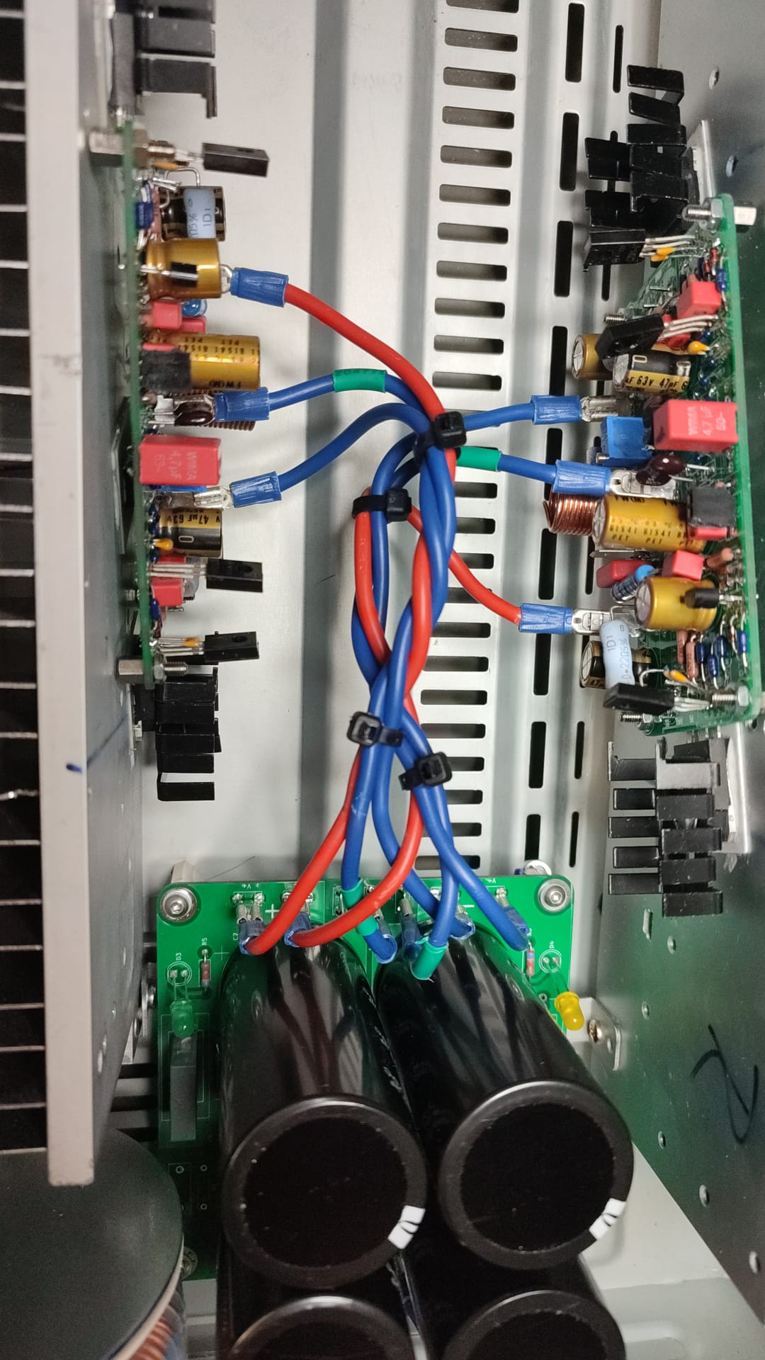

here are the final pics of my amp -FH9 XRK mod in AVR housing.
Amp is running and sound is nice...i will give it some days to compare to FX8 but the sound is promising.
what i learnt from this journey is that the housing might be cheap but you need 2 heat sink so you need another housing too. they were about 40 euros as defect sold.
and that is what you get :
chris
- - not the optimal heat sinks.
- - less room because the heat sink are in the housing 🙄
🤣 - + an EI- transformer with 35 -to 45 VAC and the VA of that is unknown.
but if you look at the power consumption plate in the back panel you can roughly estimate- e.g. 250WATT consumption---> is about 300VA.
correct? or? - - more or less useless caps...to old and 6800µF
- + i have got exactly the coils which i need - 1,5µH (pioneer AVR)
- + MPC725 Emitter 5WATT resistors.
- - you have to do a lot of drilling for holes and adaption for your amps
- + costs are about 40 euros
chris

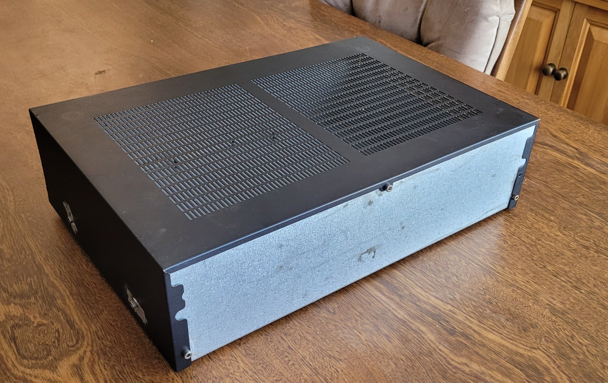

Nice work upcycling old junk!
I love this approach to cost cutting.
I have had similar difficulty reusing old av receiver chassis.
Holes were you don't want them.
Stamped features in the way.
Back panel a holey mess.

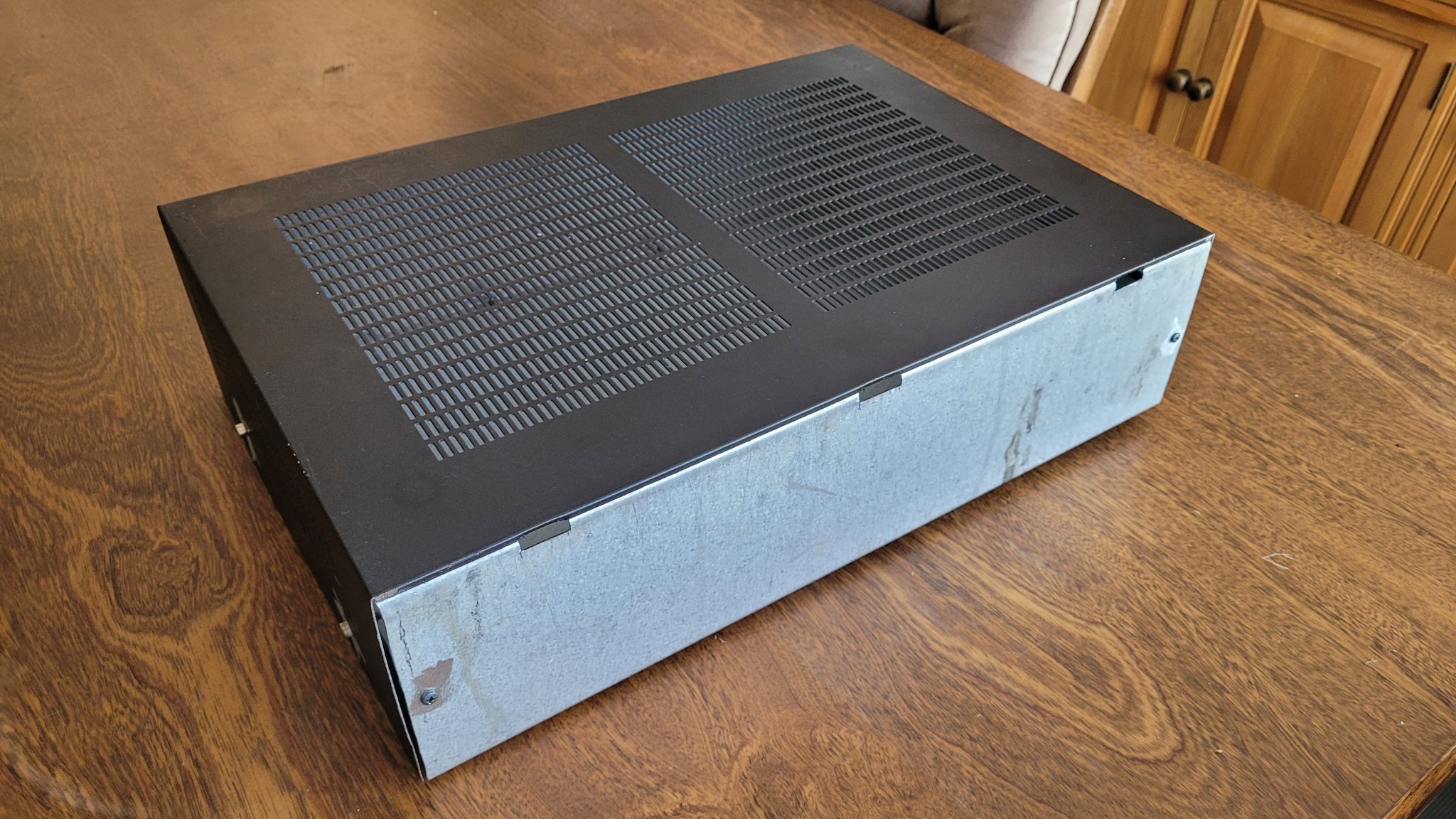

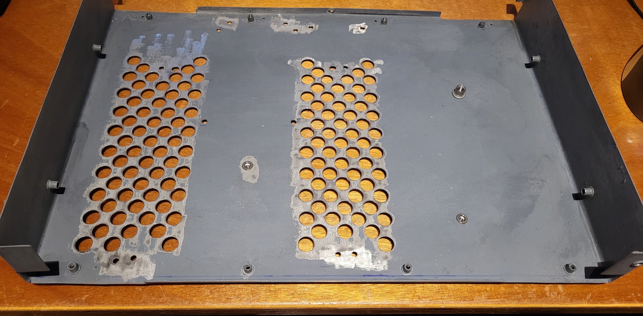

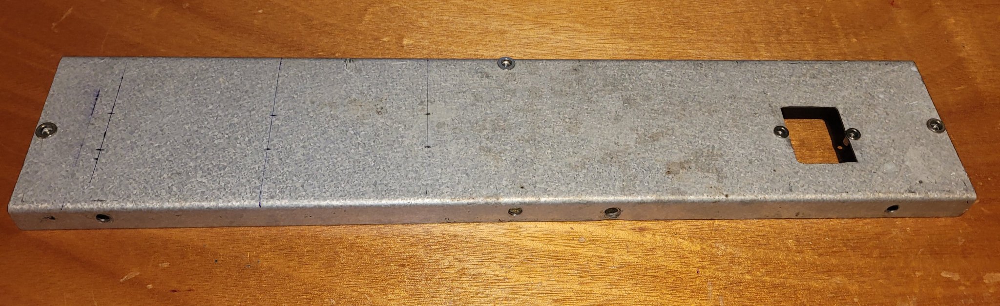

I've taken to keeping the lid and using a cheap Chinese sheet metal bender to re-engineer the bottom and back.
Its a bit of work but it makes the end result much nicer.
Heres one i did recently out of sn old pioneer receiver and some salvaged steel from an old dishwasher.
More work to then cut/drill out the features you want. But at least you only have the features you want.

Neat, I never thought of repurposing old sheet metal panels from kitchen appliances! 🙂
Cutting holes in those is hard work! Steel sheets really like stamped punches. Not drills. But you get the 1970/1980’s OEM look though.

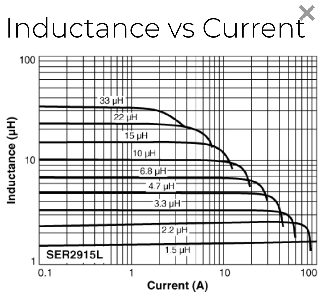

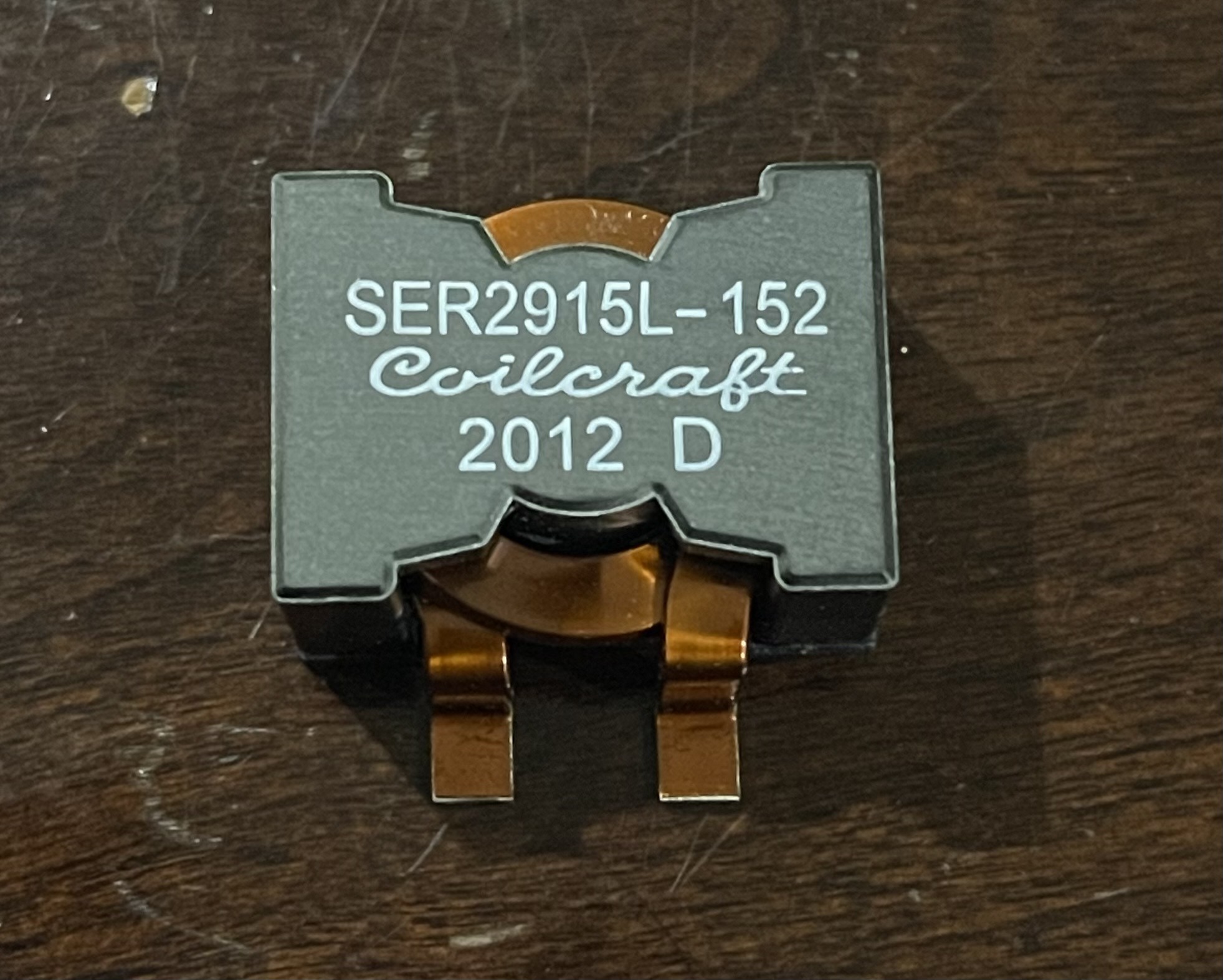

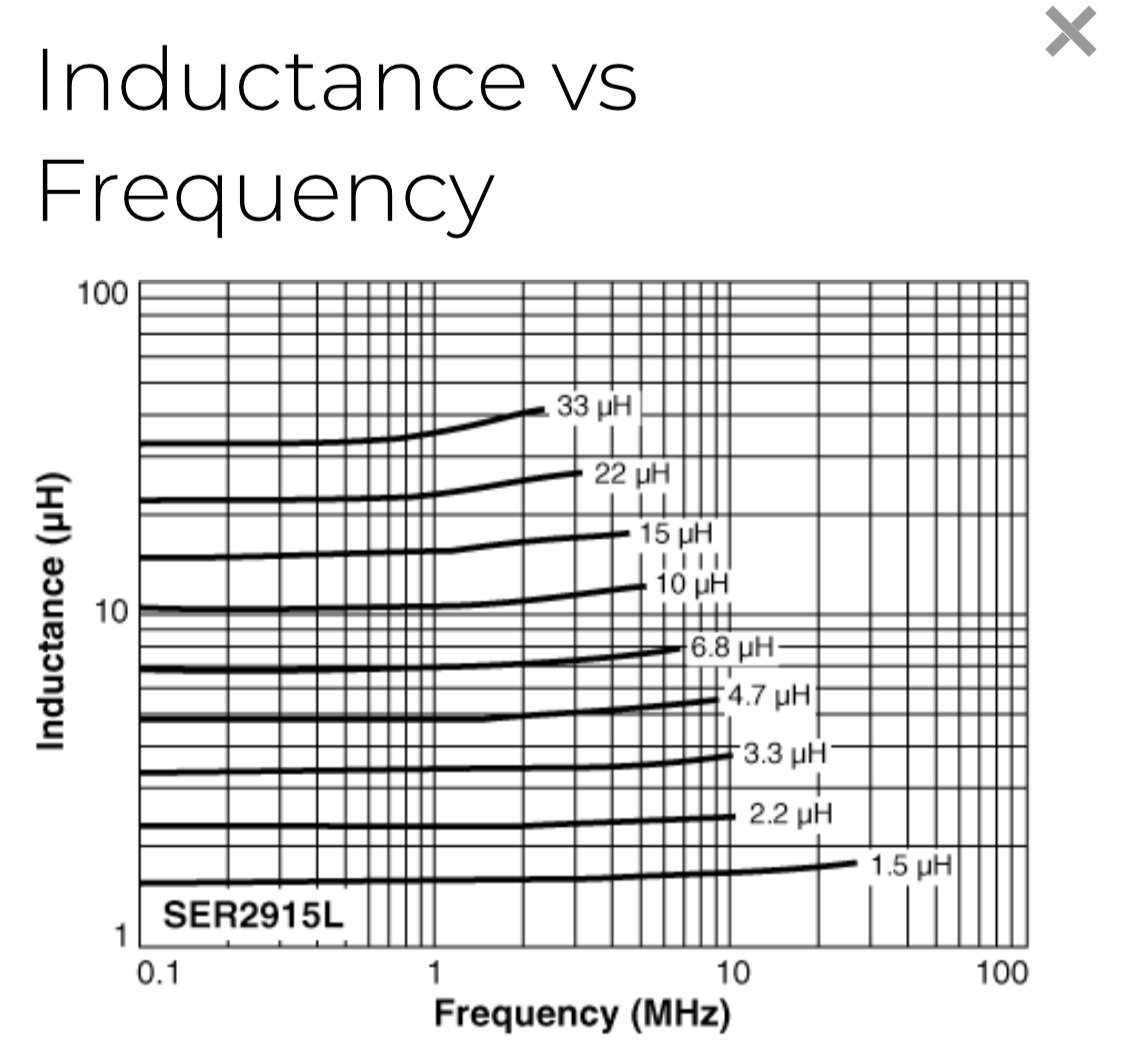

Btw, different subject, I ran across a CoilCraft flat copper inductor rated for 100A. These are flat inductance of 1.5uH over 100A and up to tens of MHz. Nice part for Thiele network on the output.
Just a cool looking part and quite a bit smaller than the one on FH9HVX. These are $5ea.

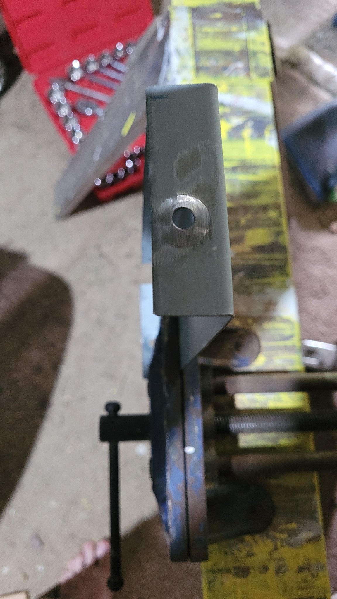

It's not too bad.Neat, I never thought of repurposing old sheet metal panels from kitchen appliances! 🙂
A bit of patience and a step drill bit.
I use a cordless jigsaw with a metal cutting blade for things like IEC power sockets.
I've come to love rivet nuts for holding things together.
I also discovered one can make a dimple die out of a bolt, washers, a socket and an impact wrench.
