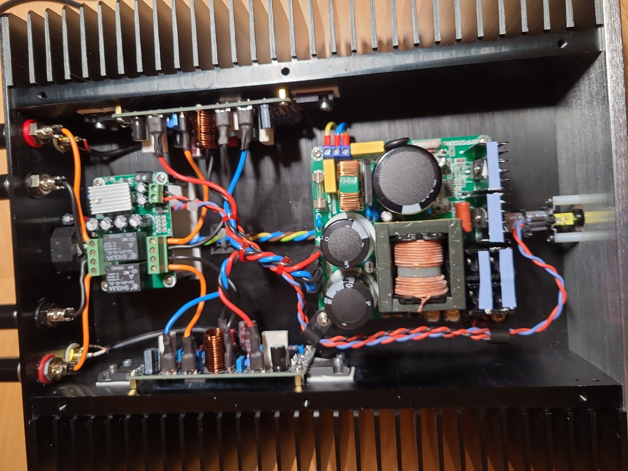

My little Amp is working. Sounds beautiful. Strong bass, cristal clear high frequency. The rails are set to +-37 volt. Biasadjusment is 80 mA. The heatsinks keep cool after an hour. The little case has weight of 3kG, not very much. I will try a higher bias adjustment, thinking about 100 - 120 mA. I decide of the heat on the heatsinks.
My delay is not working properly. Something is wrong. I wonder why, because i tested it before with an other amp....
I have built in a speaker protection at same same place.
A secondary fault is the circuit around the pot. My idea of switching of the pot. The relais is working but doesnt switch correctly...i have to search after.
Thats will be a small thing...

Hi...
i soveld the problem wit the circuit around the (my) pot. I need 4 relay openers. 2 for the RCA input and two for the pot output. I took a second relay. If the relays are switched, 2 normally open connect to the boards, the 4 openers disconnect. Works fine now....happy to solve it
Peter

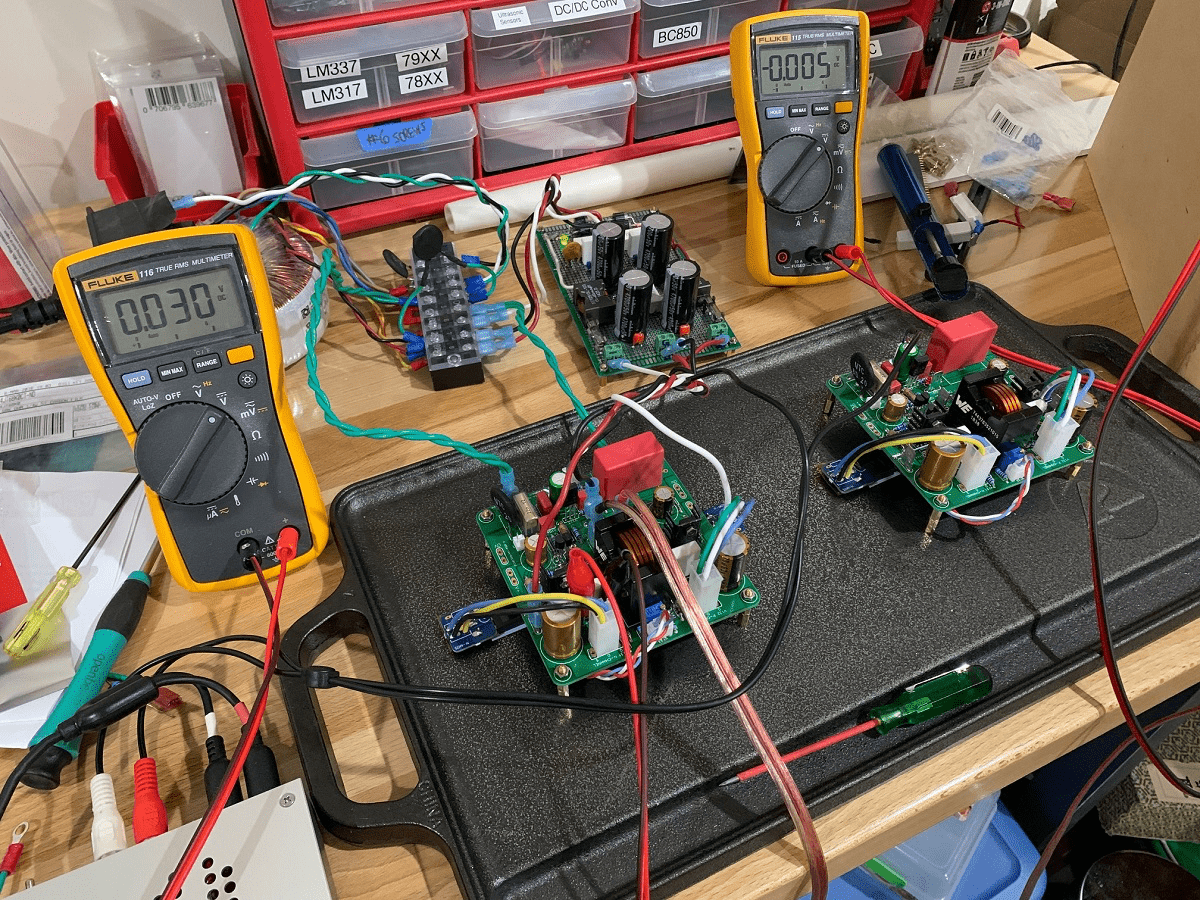

For testing i will use a transformator 25 Volt/250 VA with 20.000 µf per Rail

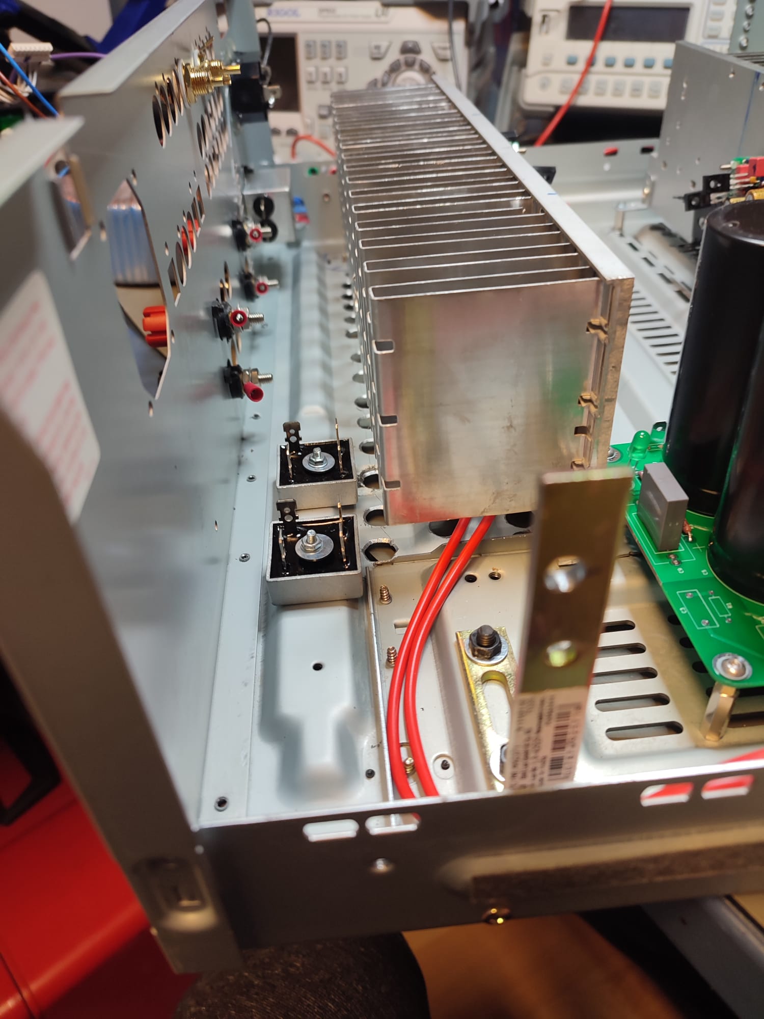

FH9 pre installation..
jesus...no space in this AVR housing... 🤣

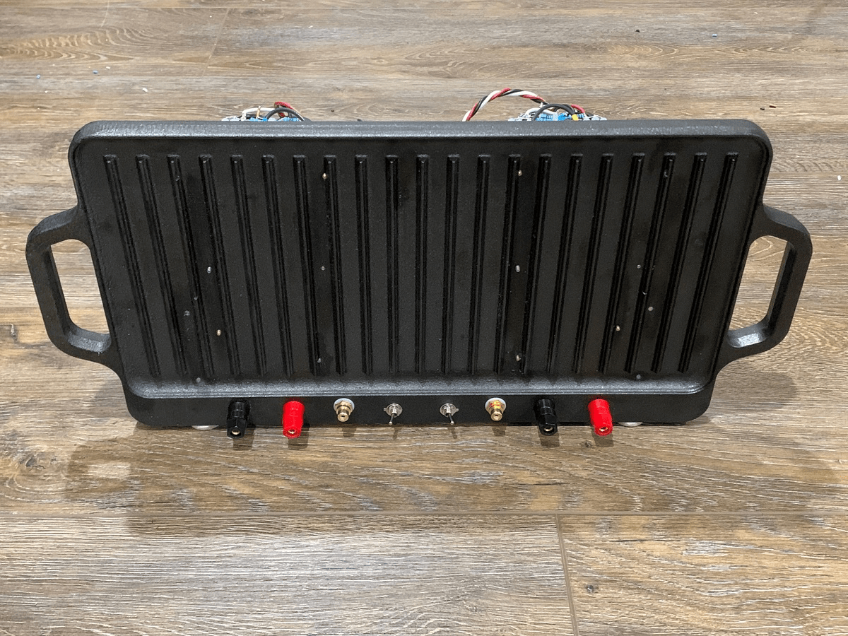

If you need a unique and low cost heatsink and chassis for the FH9, try a griddle amp. That’s how I built mine.
https://www.diyaudio.com/community/...-a-budget-conscious-heatsink-solution.355302/

I understand, good friends can’t be electrocuted by your hobby. 🙂

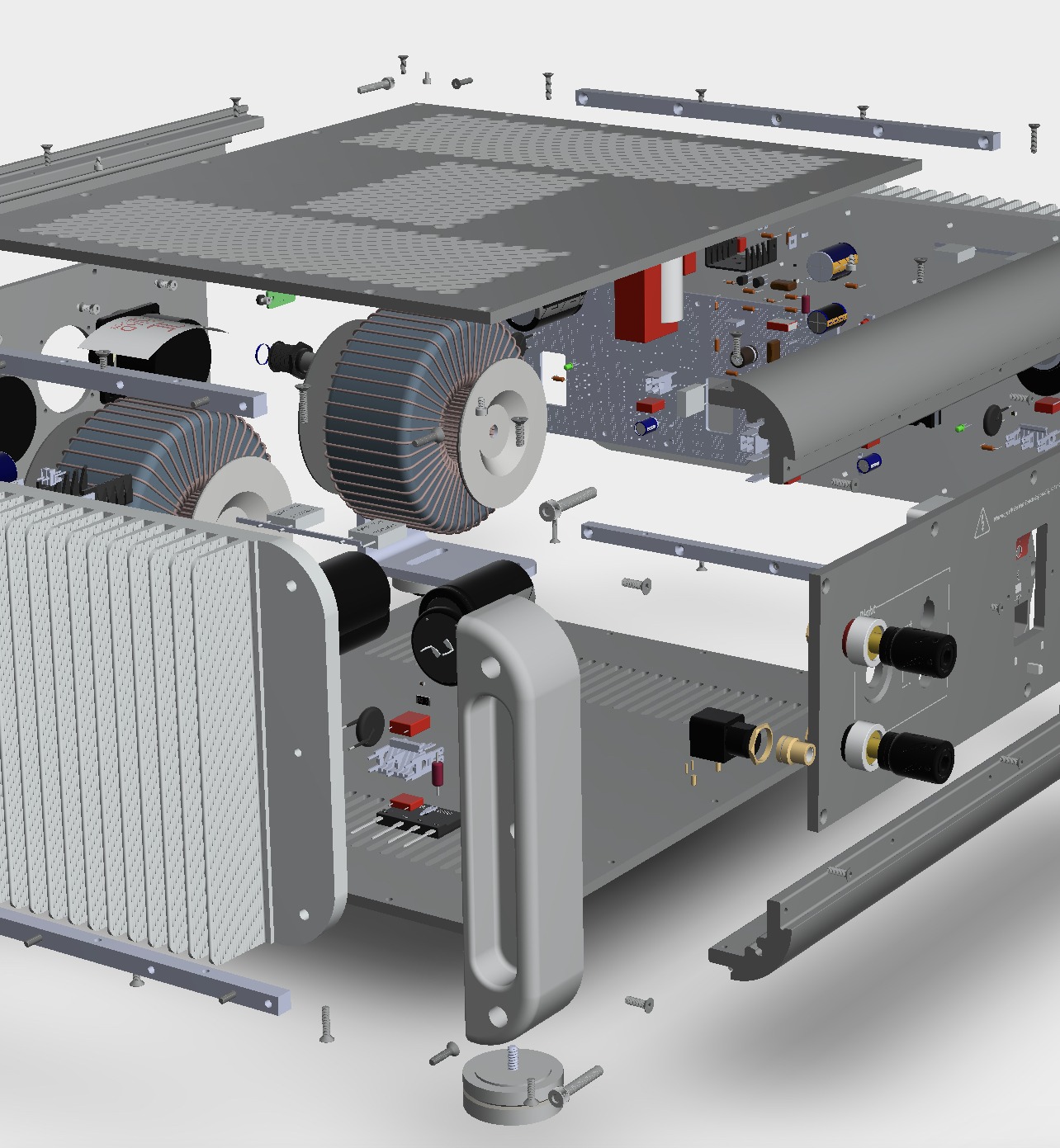

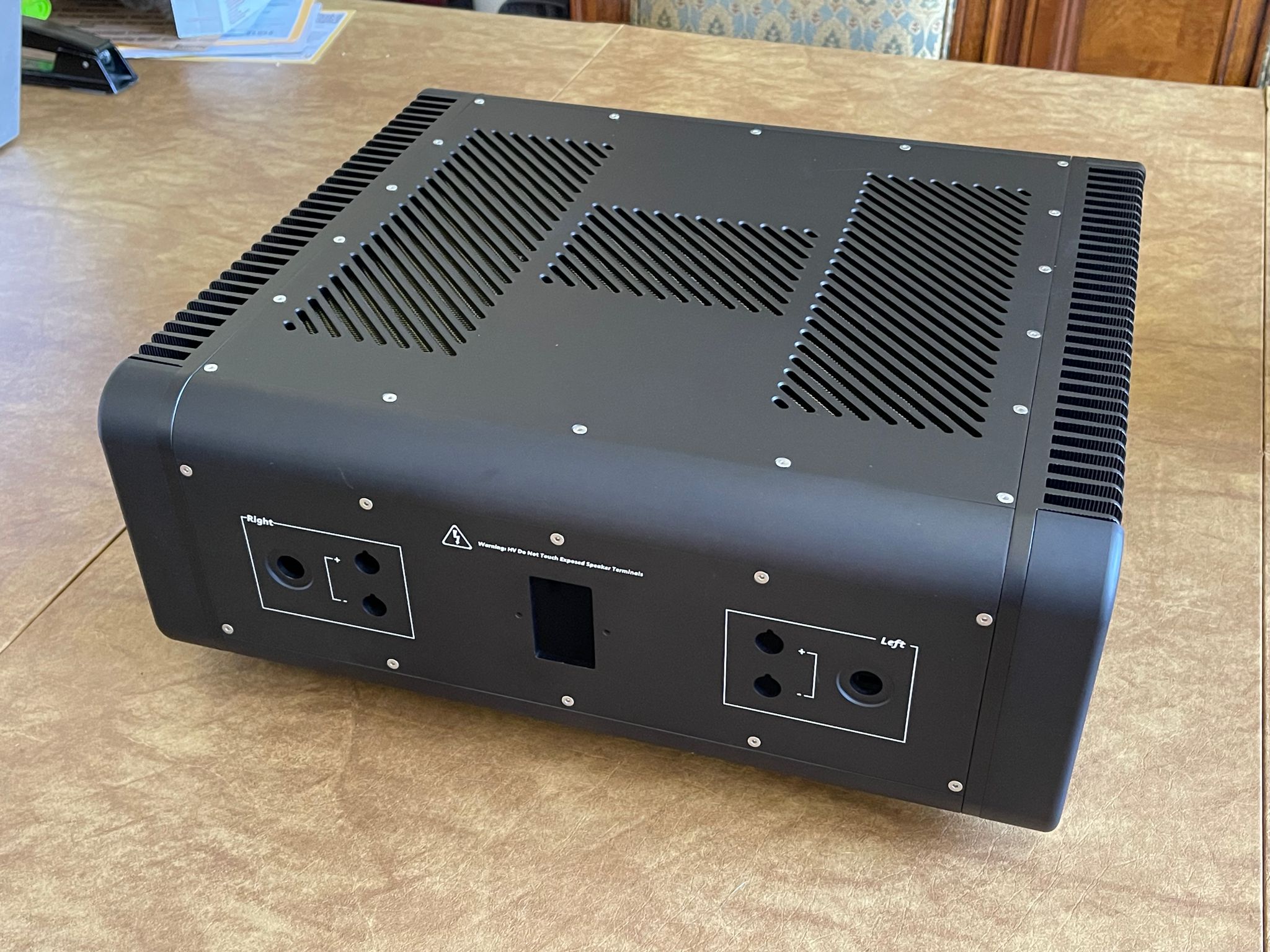

I am getting ready to install a 40W class A amp into a “soon to be classic” custom chassis I designed.

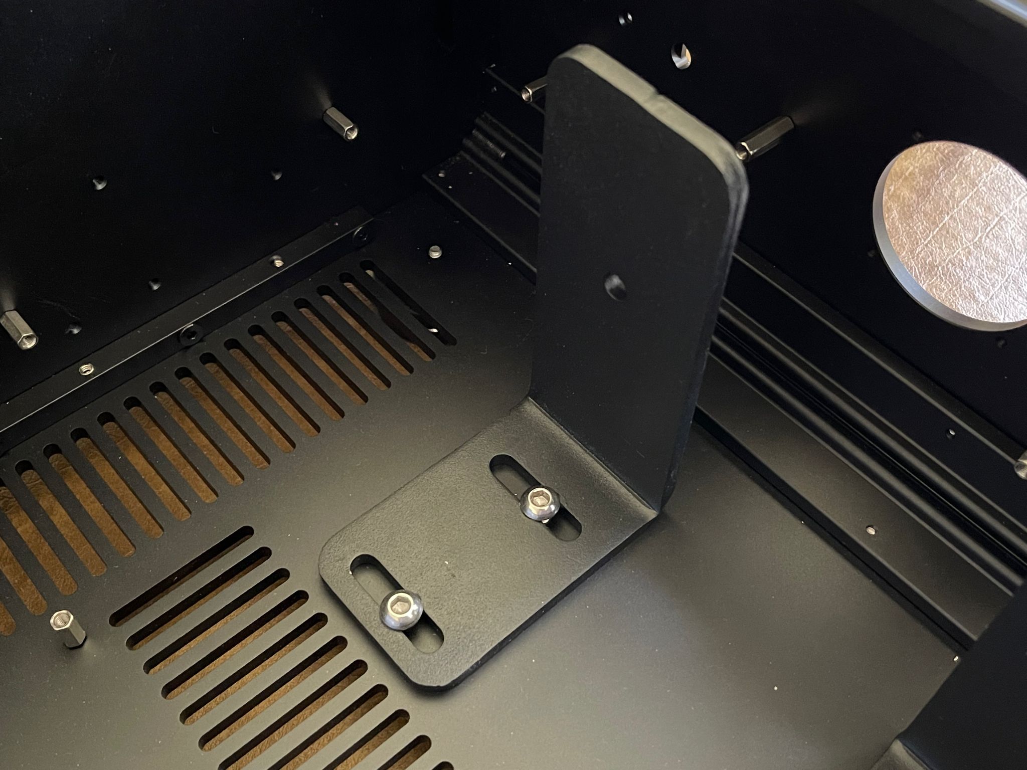

Custom aluminum brackets for trafo donuts too. This would work for a 300W class AB I think.
Prototype screws for test fit are wrong color. Black hex drive all the way.

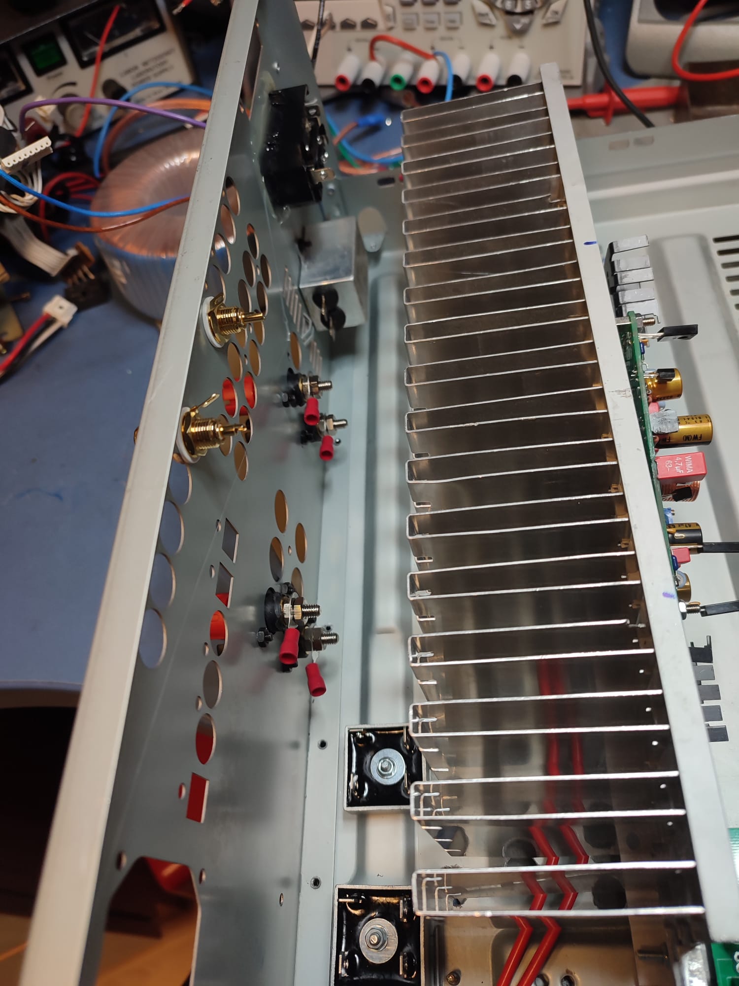

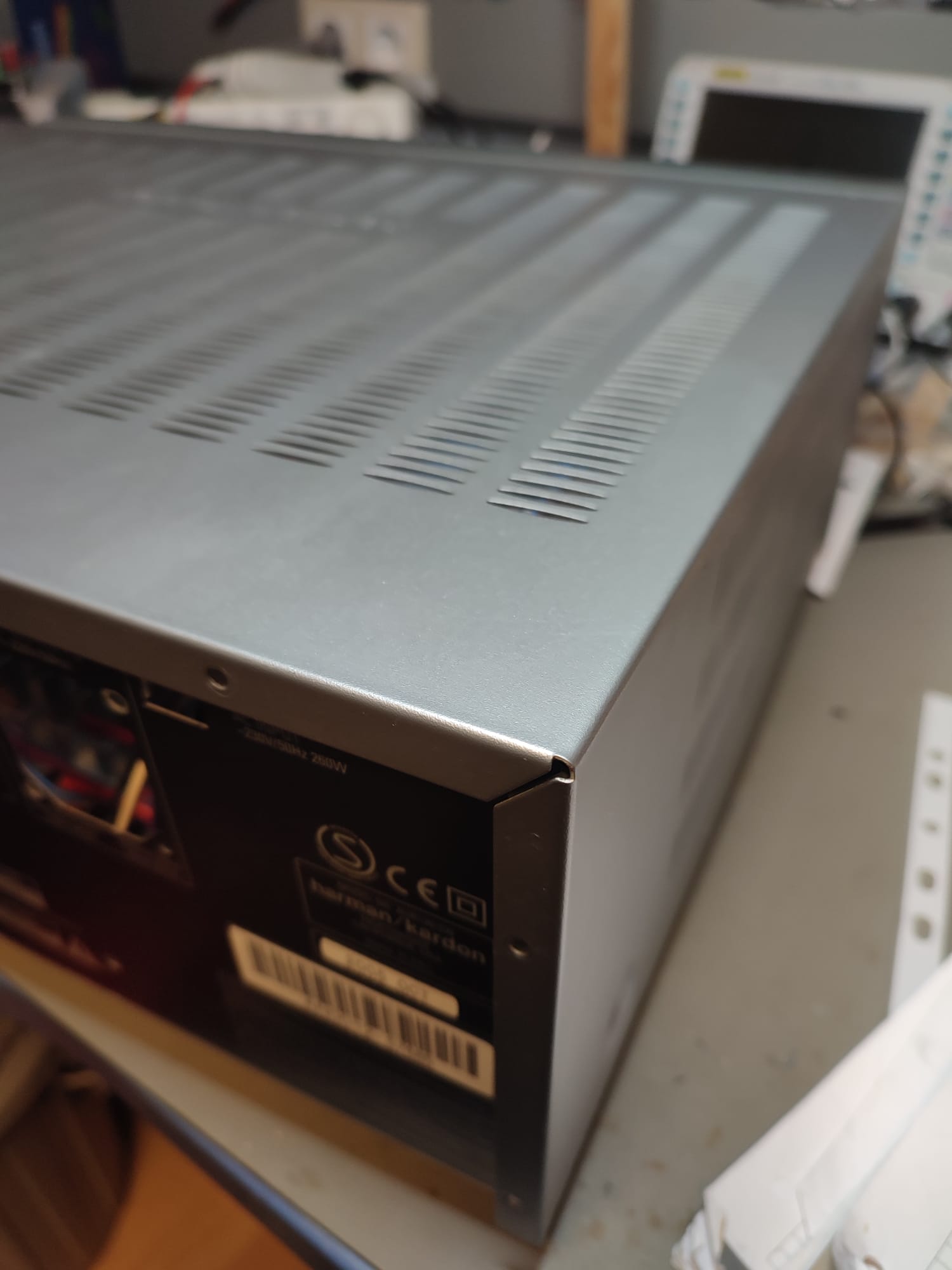

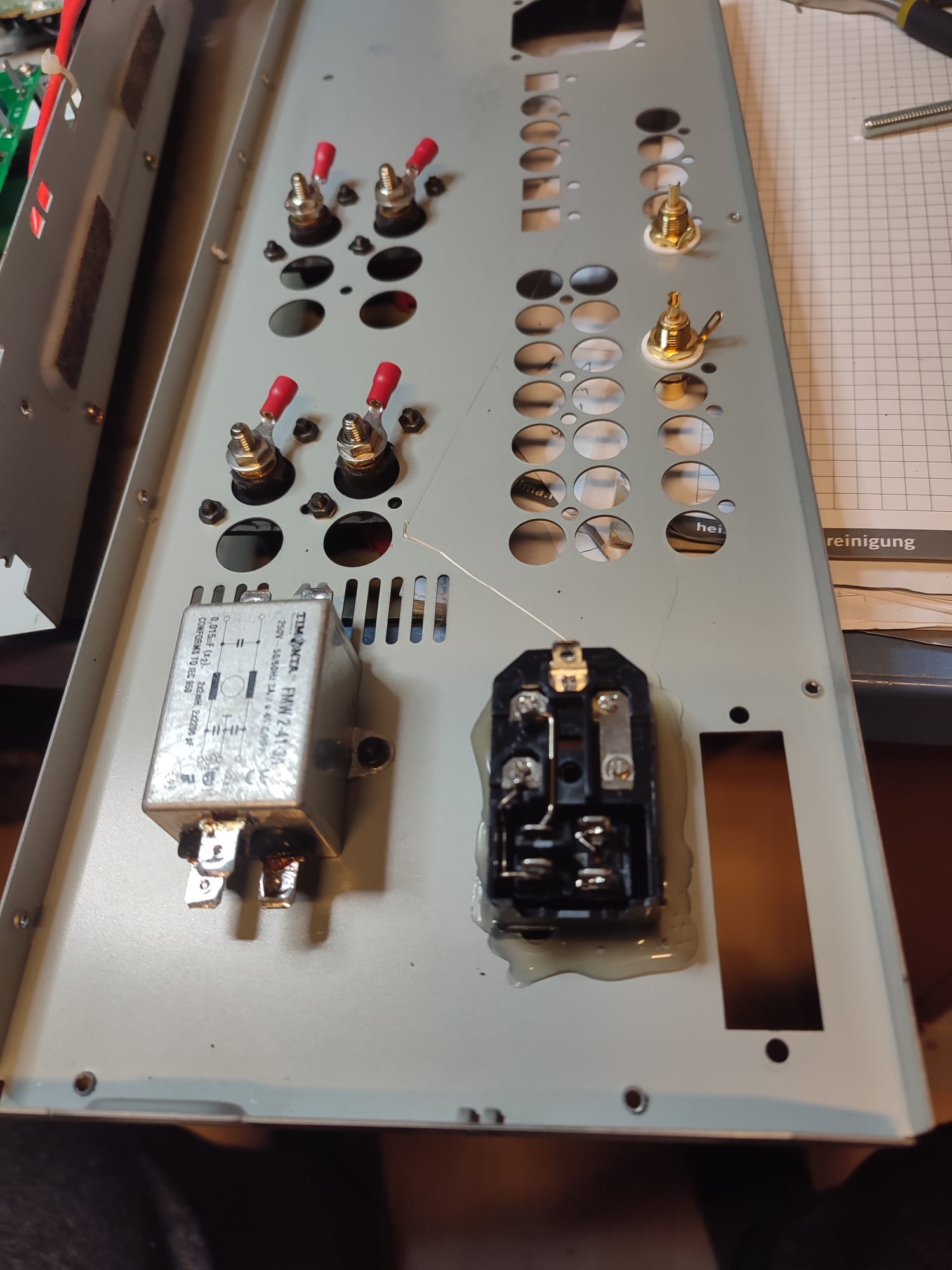

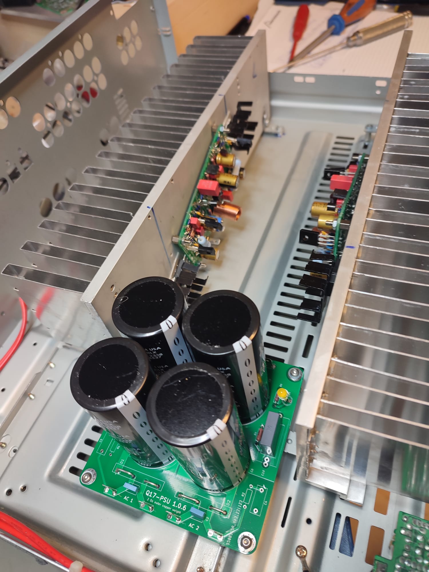

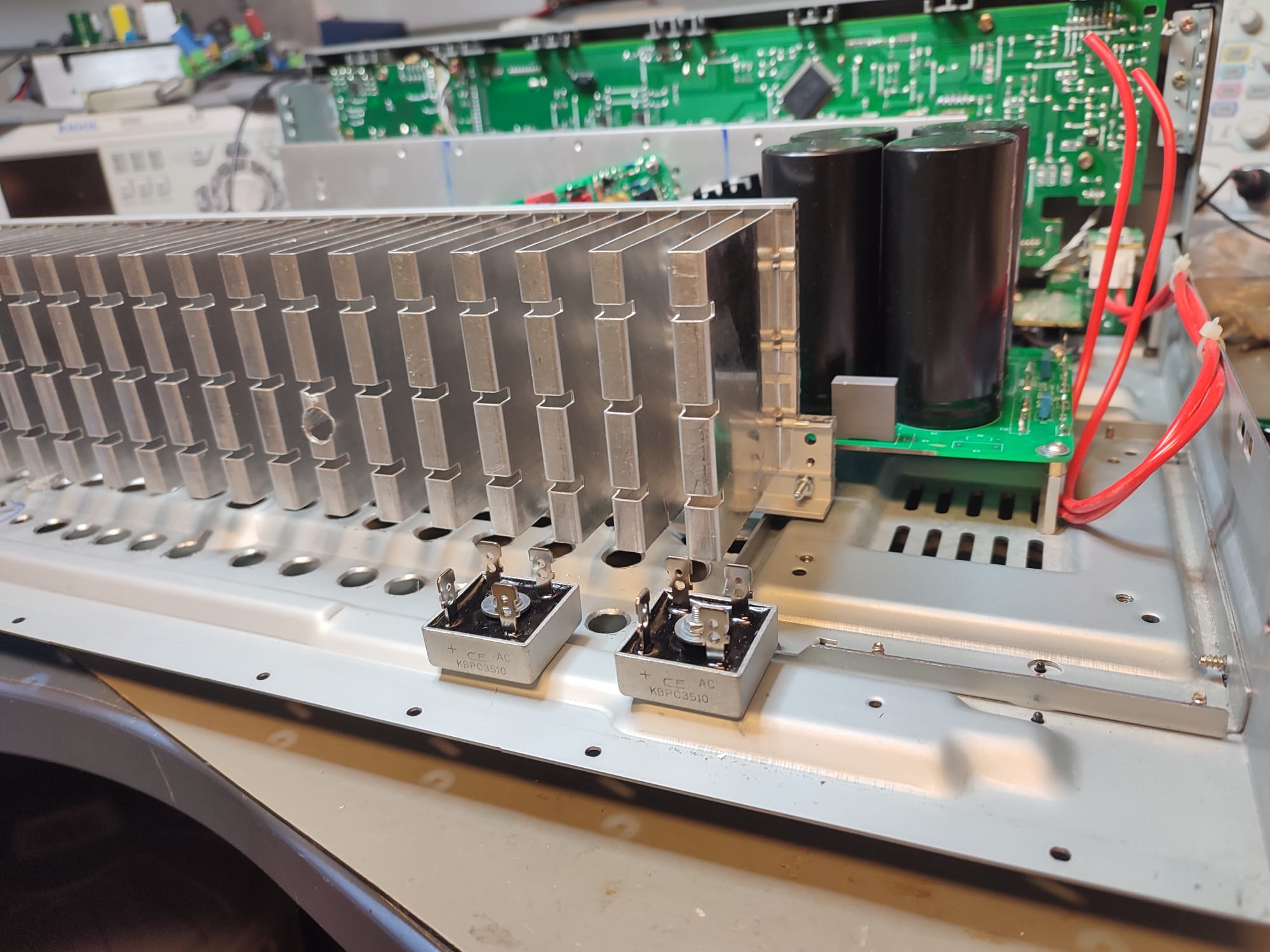

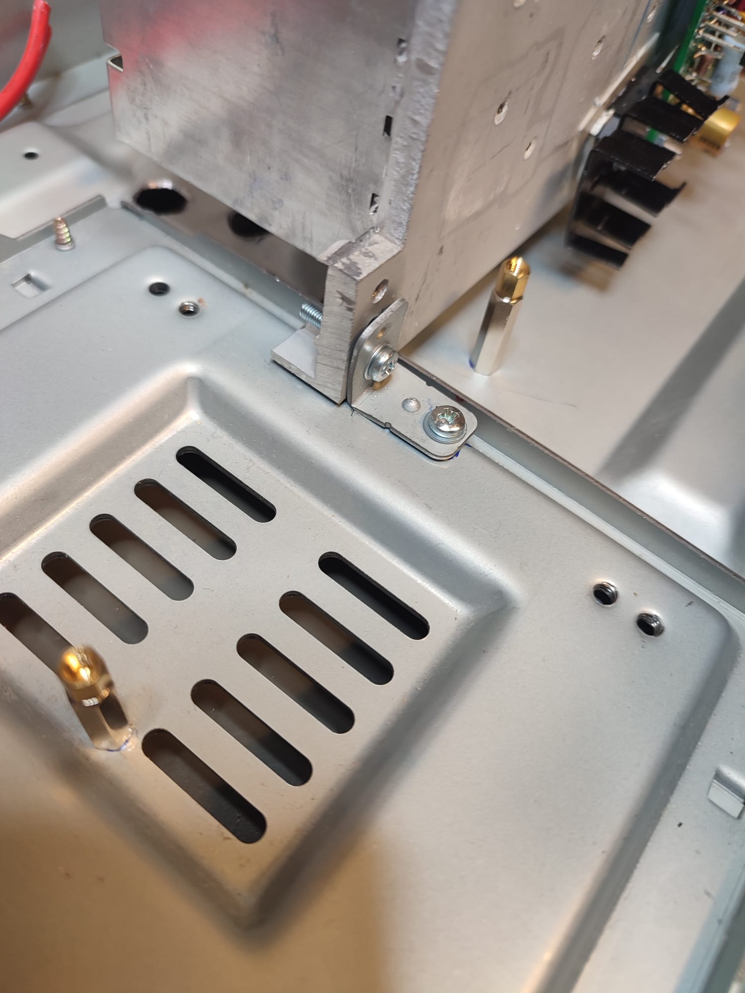

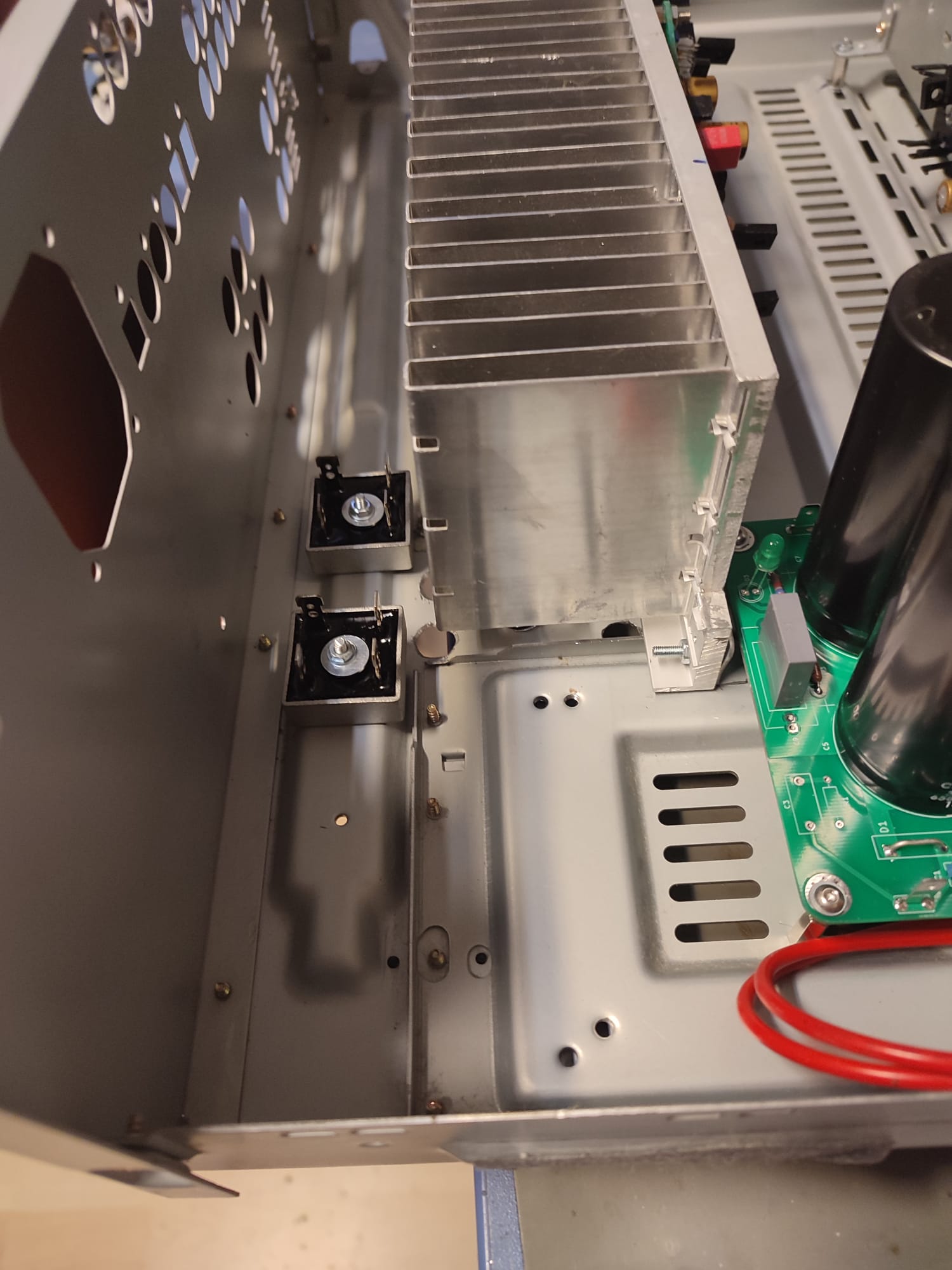

pre installation done...

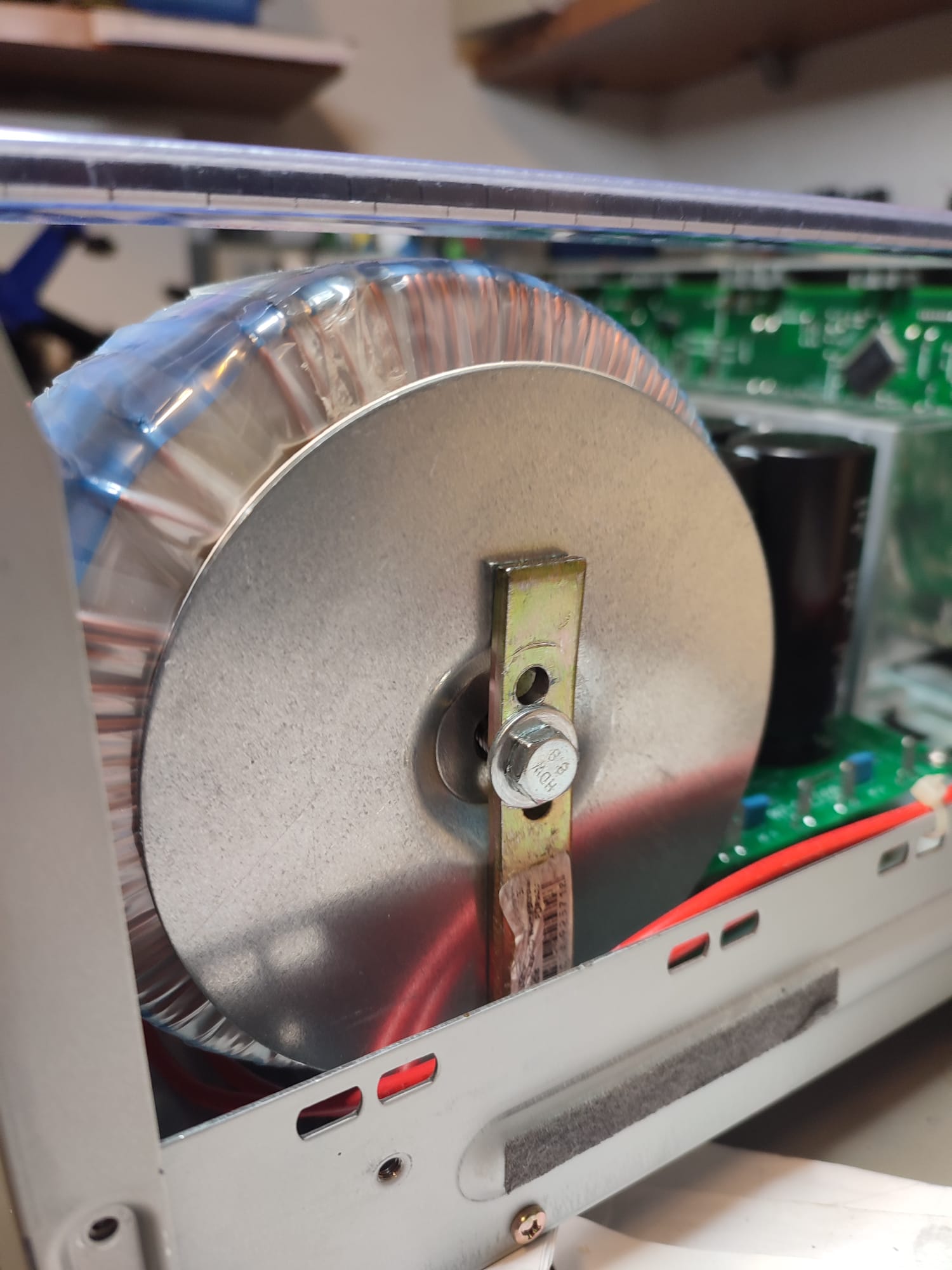

to install the donut like this i have to adjust more then once... 🤣
back panel looks not so nice...a lot of holes and not in the same line....but it was an AVR 😉

Nice case repurposing. It’s amazing how much retail audio was sold in thin stamped sheet steel cases. No one complained.

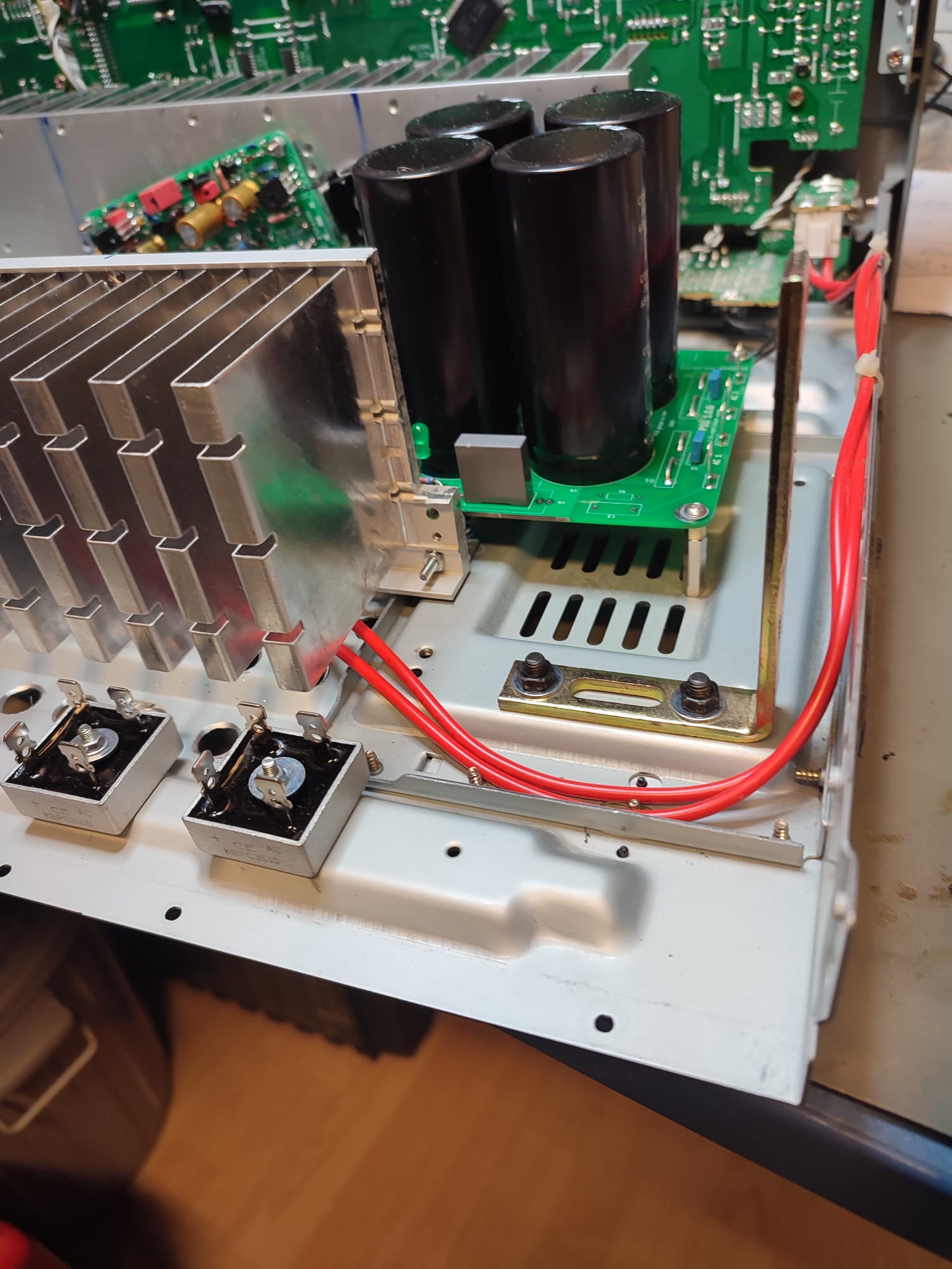

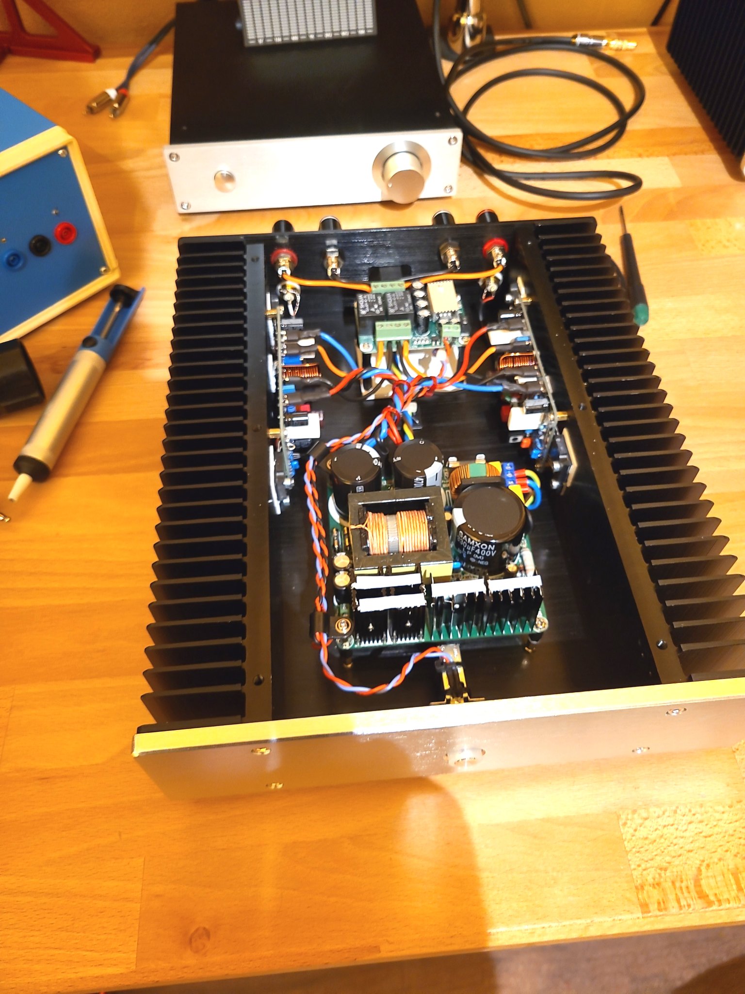

I have built a second FH9 with more power in a bigger case. Not tested yet, follows in the next days. The Connex SMPS works with +-45 Volt, 500 Watt.
Don't need to buy a 400/180 Hypex SMPS, because I found this SMPs at home. I was not sure if the SMPS will work correctly at the Aux Voltage. By a stupid mistake i damaged the negativ aux output....fixed it with new smd diodes. Working again correctly... 🙂
Perhaps i have to drill some holes in the ground plate. The top plate has vents already. The smps touches the top plate with its heatsinks.
greetings
Peter
