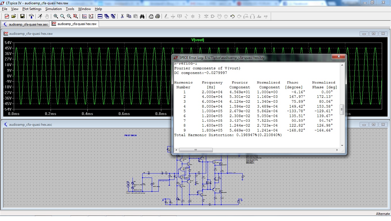

please see my schematic, can someone run simulation for me?
I use models from Bob Cordell except BC546B, BC556B, and IRF510.
I set mosfet quiscent current about 180mA.
Result:
Phase Margin = 87
Gain Margin = 24
Slew rate = 196 V/uS
THD see attachment, it seem too high.
