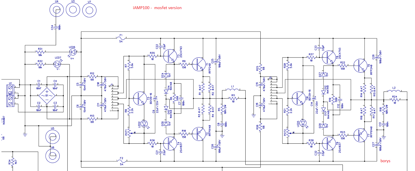

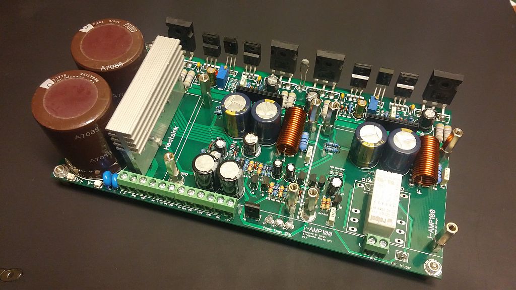

Now the new version is comming --> iAMP100. The stereo OPS unit for single pair transitors, just transformer is required.
The board will ''take'' on board BJT and the Mosfet transitors, board has:
-main PSU
-preamp PSU +/-15V with short circuit protection
-speaker DC protect
-over temperature protect
-speakers 10s delay ON
-speakers fast OFF -->after trafo is switched OFF
-you can use single relay or two separete relays
-BJT or FET-hex output transistors
IPS boards are 60mm x 70mm which is enough to fit in most of the simple amplifiers (including sony ta777es if you will have a parts 😀 ).
The special tool will help to bend the transitor legs 😀 (spacers distance is 30mm)
Excellent configuration with snap-on IPS boards! Very PRO 😎
Big THANKS lads.
I must say that I am very suprised with irfp240/9140 pair, they sound lovley. On the paper (measurements) they are a bit behind BJT's but at the listening tests they rocks.
Bias spreader with red LED keeps the bias very solid all the time. I have some 2SK2013/2SJ313 (for drivers) and 2SK1530/2SJ201 so I will try to make it more SONY look like OPS.
Regards Peter

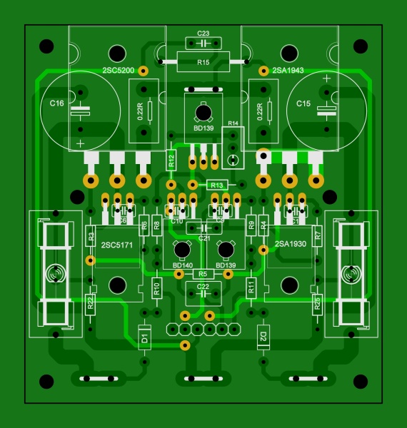

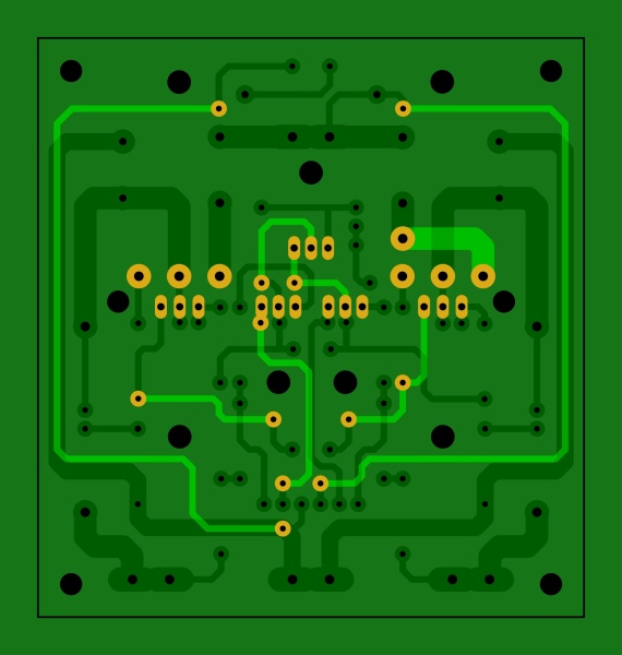

Hey guys.. may i ask for the footprints of the components in multisim 13?
i am having hard time here to figure out what footprint to use.. i am using the 3x 240/9140 version.. any help will do..
thanks,
-nat
thanks,
-nat

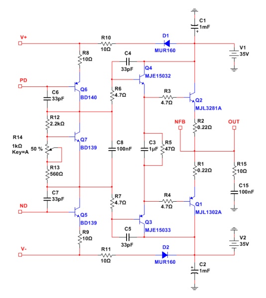

Tche output stage schematic is bellow, very simple and basic as 90% of the amplifiers. Bellow resistor values for mosfets IRFP240/9140.
I have around 10 differend IPS boards (bellow a bit modyfied apexaudio A9 IPS).
The protection is splitted in two circuits, first one is for temperature protection and is based on shmidtt trigger (comparator with histeresis), protection is cutting the speakrs off at 80deg and switching them back on at 65deg (depend on the resistor value).
The second part is DC detector + delay ON, just a few trannies. I have never used uPC1237, I can learn more when using fully discrete version.
The next generation of the main board will have same as above plus full short circuit protection (same as in i-PSU) , so hopefully it will be bullet proof.
Regards
Regards

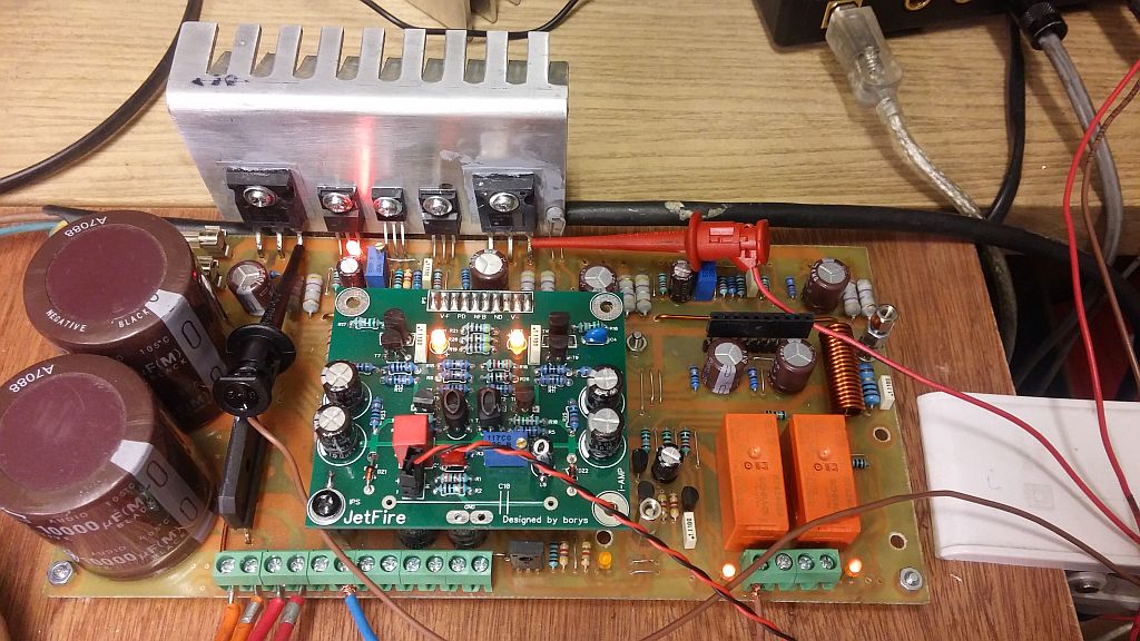

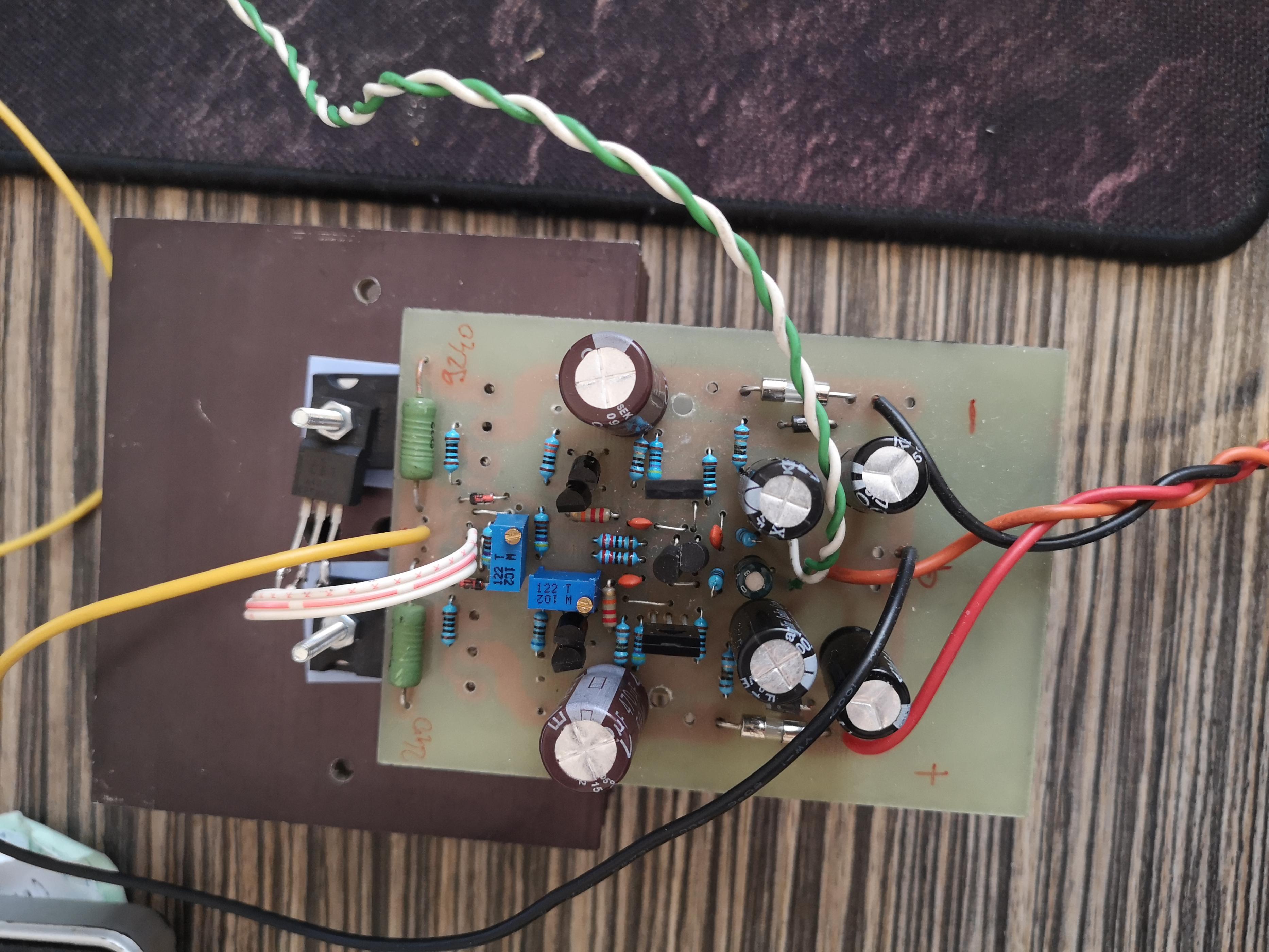

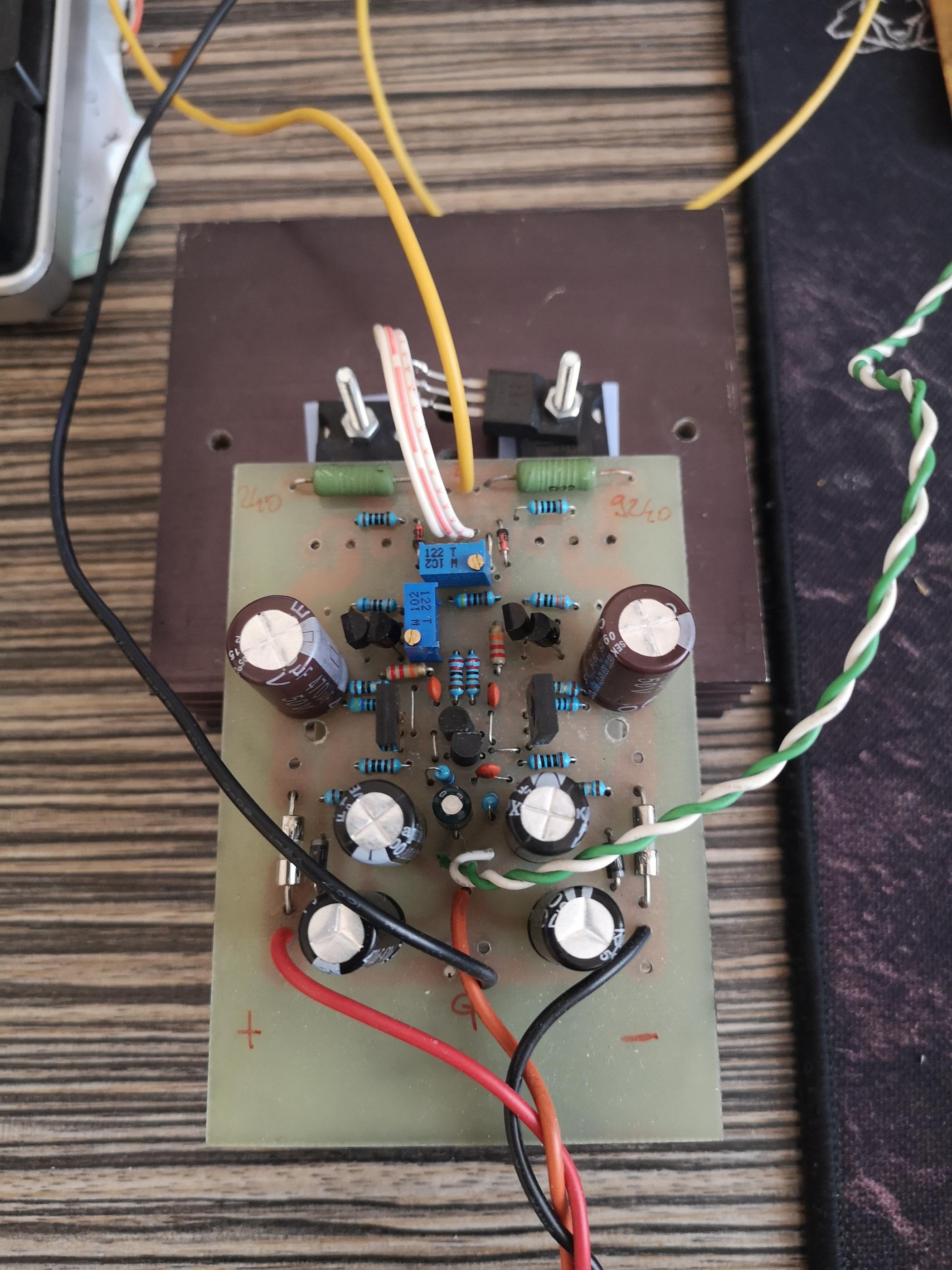

Hi, I had some extra time and I have made 1 channel of this little hexfet amp (v. 1.6 board). Very nice sound, second board is ready and I will populate it sometimes soon.

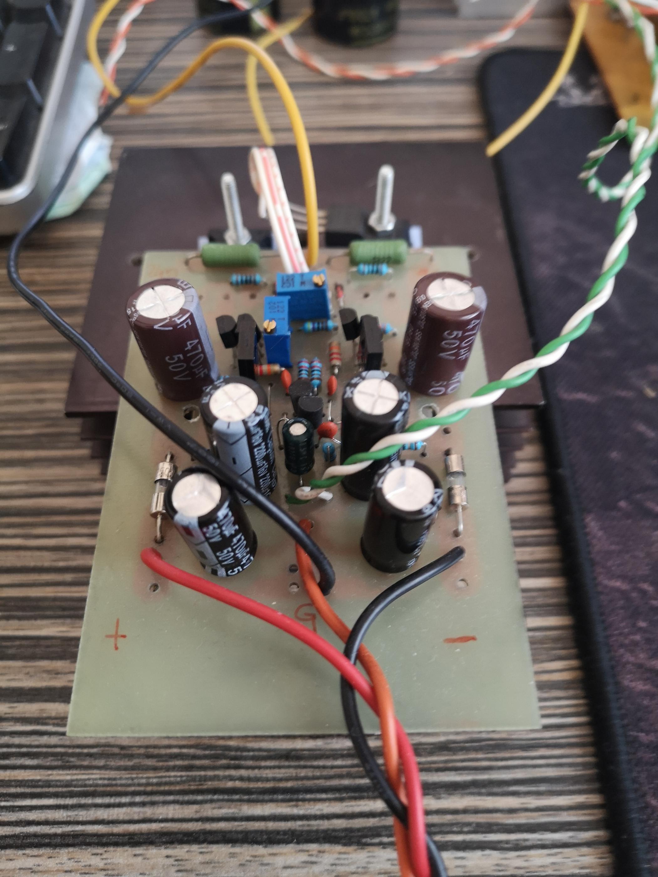

Can I use 2sk246 instead of BC550 and 2sj103 instead of bc560?Marc
If you have some JFet at home you can test it by replacing the BC550C/560C
For BC550C use 2SK170BL and BC560C use 2SJ74BL Just rotate them 180 degree to solder them to the PC board.
For example if the two BJT was face to face the JFet has to be back to back
I used between 7-8mA but I don't think that is so important as long as U chose BL grade.
Greetings G
You could;-)Can I use 2sk246 instead of BC550 and 2sj103 instead of bc560?
But: 2SK246 and 2SJ103 do sound not very well!
