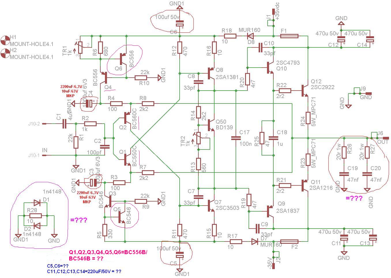

Boban, which version of schematic did you use?

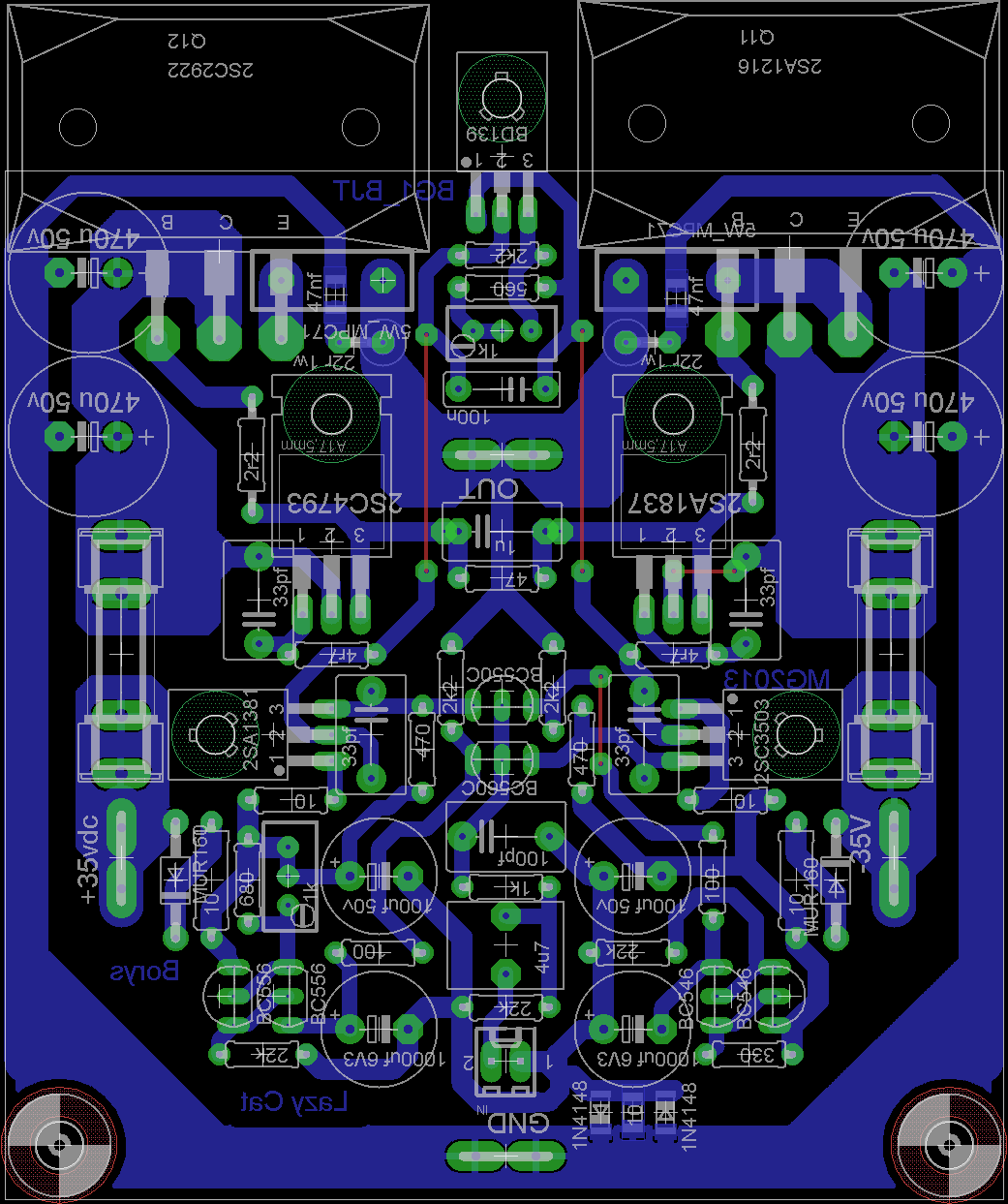

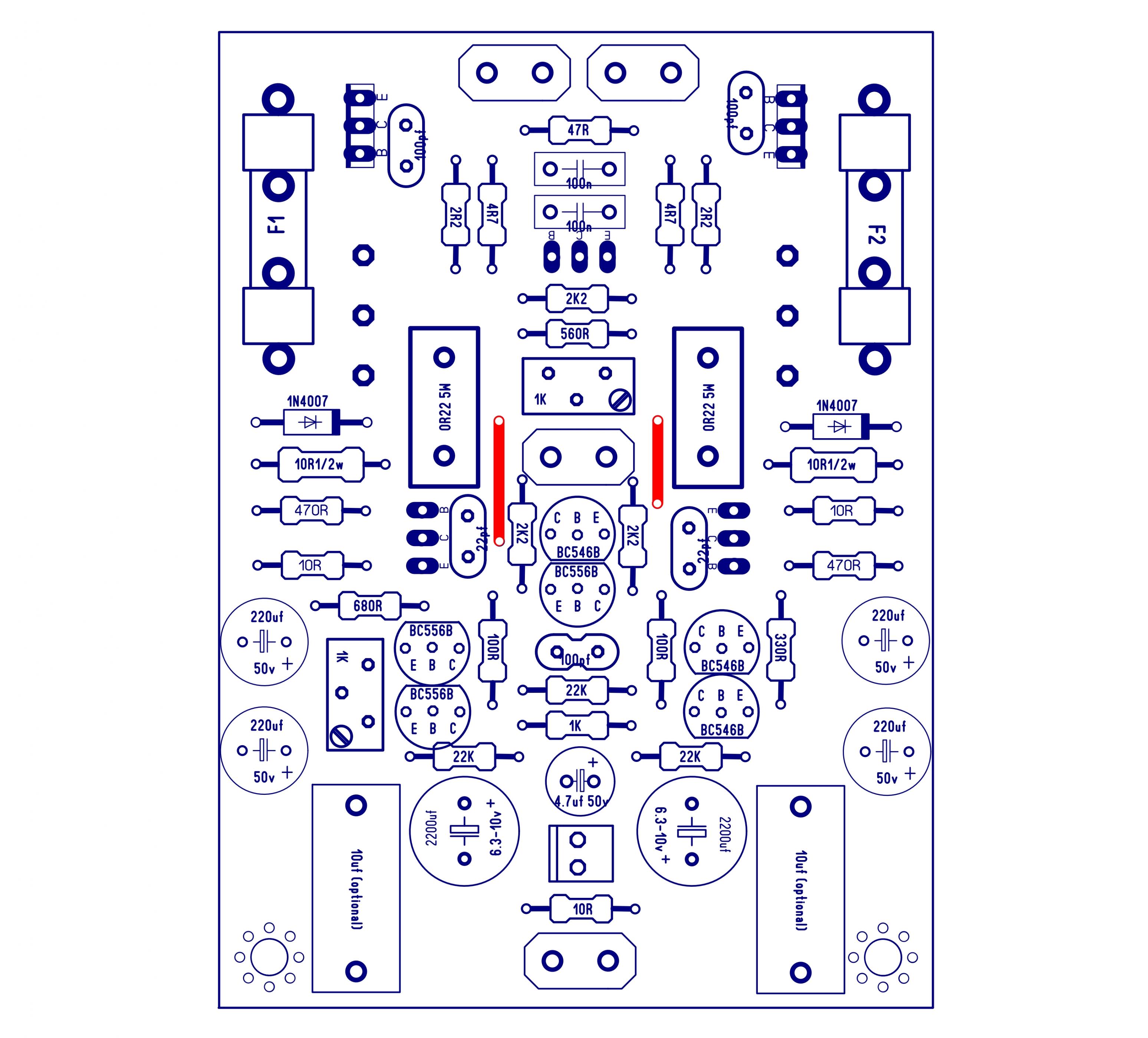

OK, shortened the track lengths for C9/C10 and used SMD bypasses on the underside as suggested - however, size of C9/C10 had to be reduced from 16mm to 12.5mm to get the most placement benefit. That's probably OK, since there's enough choice of 470..1000uF, 50 to 63V caps in 12.5mm.
The overall dimensions are down to 2" x 2" (~50mm x 50 mm), which seems to be close to optimal for the layout, allowing interchangeable use of TO3P and TO247 outputs..
Hi linuxguru, Very nice compact design. Can you post the PDF file? Intersted on this.

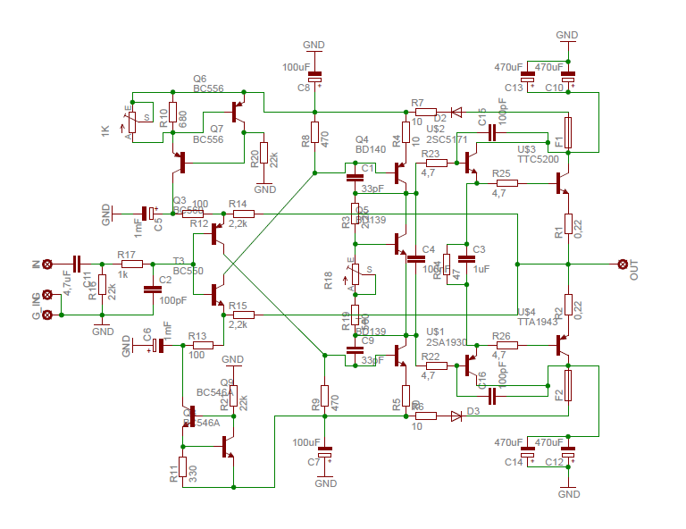

Hi, this one:
Sir Borys, cou1d you kind1y confirm if the posted BG1-BJT schematic was the 1atest update? I am current1y drafting a new pcb design. 🙂 Many thanks!
Beautifully designed PCB.

^here you go Radio, take note though, BD139 bias sensor must be mounted on the main heatsink via wire Iinks. VAS transistor are not designed to be mounted under the board either, but there's no stopping you of finding a means of doing it without damaging the pcb copper tracks. (bottom copper.pdf for toner transfer) 🙄 😉

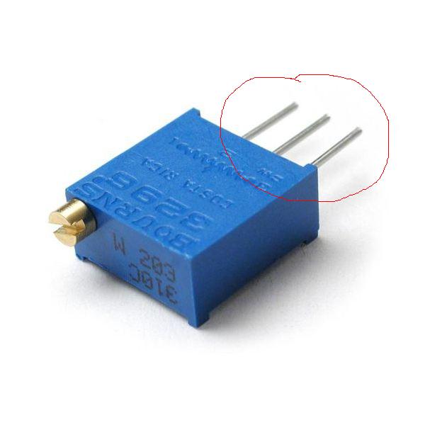

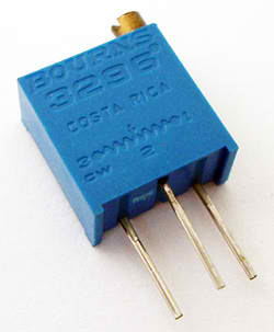

Here's what it looks like multi-turn potentiometer 1k (R18), so this should be put on the PCB-layer.

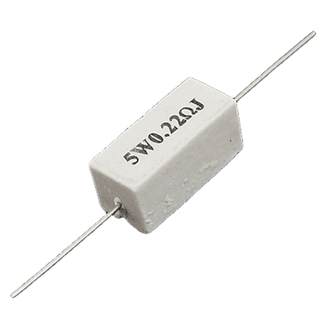

Resistor R1, R2=0R22/5W.
^the footprints are modeled to these types (attached image), but you can also use those types as in your sample, make the rectangular white wirewound in vertical (upright) position.
hope it helps! 😉
C16 and C15 --> no need to solder them (they were ther in case any parasitic oscillations)
R19 can be lowered to 100-330 R value.
R4 and R5 --> you can replace them with 22R (in some cases 33R) resistors, next is the driver stage so vas doesnt have to be biassed so high (some heat issues)
Everything else is just fine.

Mr Borys, for which the schematic is working?🙄

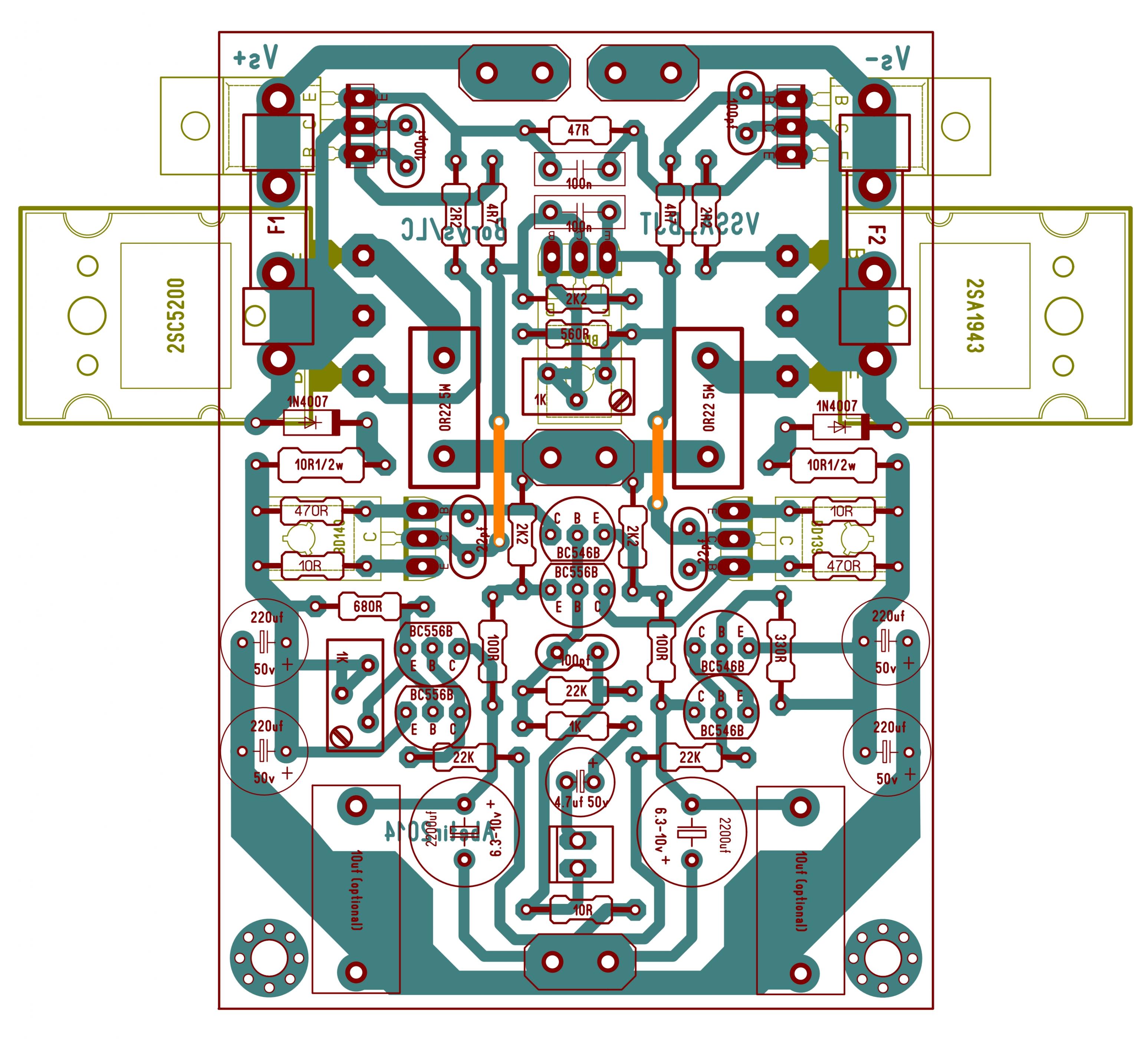

VSSA BJT BG1 + Mr.Evil/PMI capa-multi PSU + uPC speaker protect
Not tested yet...

Hi Abetir!
Why the difference in the values of the components between the schematic and the PCB? (see #665)😕🙁
thank you!
^Which values you are referring to? I only see the 22pf (pcb) instead of 33pf (schematic) cdom on VAS transistor and some changes on rail voltage smoothing caps value (not so critical). Some resistor values needs to be adjusted to suit your applied rail voltage. You need to build it first then apply Borys changes, the board should work fine. 🙂

i have some irfp260n hexfet mosfets.will a quasi complementary output work with this amplifier?if yes will there be any layout??
there are 2 nice layouts for one pair of output transistors 2sc5200/1sa1943. has anyone tested both?does one sounds better than the other ??
